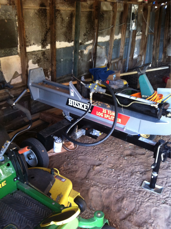

I was driving by a pawn shop and saw this 35 ton out front it look brand new was not used much paint not wore off.
I paid 900$ for it. The Briggs engine starts on first pull. This my first splitter it has done every job with ease
Splitting mostly oak and mesquite.
I see you've got a trailer jack on your's too.
Did you add it, or was it on it when you "found" it?
Either way, what a great deal!
Congrats!
That is a good deal for that. It sure seems heavy duty enough. I just have to put a jack like that on mine.
A question I have is, does bark and chips get jammed in the platform. Looking at that, it sure seems it would. I have a Duer splitter which has a clear I beam and the only place chips get jammed in, is back by the cylinder and that is irritating enough for me. Just wondering about yours because I see a lot of your design around.

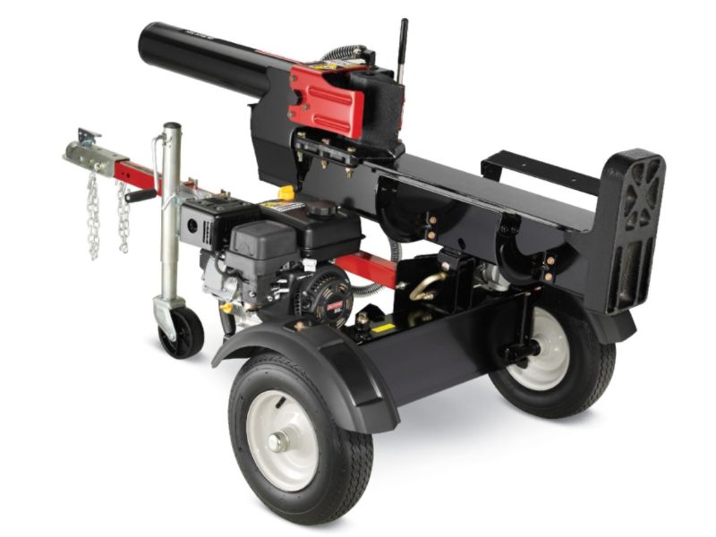

99johndeere99, Wow, that is some deal! It appears to be this model from TSC and you saved $1,100.00. Nothing like "being in the right place at the right time."
I decided to order this 27 ton splitter from Sears. It has the trailer jack and coiled wrapped hoses that I wanted and will probably be all the log splitter my brother and I will need. Some may not feel confident of the Sears motor quality, but I have a Sears lawn leaf pull-type vacuum that has not given me any engine problems for over 15 years.

Their are holes cut out for bark to fall out. The one thing I don't like when used vertical the bark will fall on muffler start to smoke.
Going to build a shield over it
What a deal. I'm jealous. The 35-ton units usually go for $2k plus.
That's the basic MTD log splitter. My guess is MTD will build it's design with what ever options you want. The brand and type of engine, if and what color fenders, the basic or nicer folding leg, the outer springs on the hoses, etc. That splitter will split almost anything you put on it. Plus Sears will always have parts for it.
