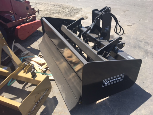

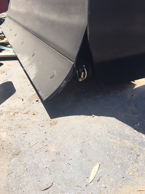

Ok, the tail gate does indeed have pins to lock it in place. When the 4G4 series is mentioned with both floating and or fixed, I believe that they can be had with just that, a fixed welded rear cutting edge or a tail gate system such as the 4G2 series. Keep in mind that the 4G2 series units have smaller capacities by a few cubic feet.

This Gearmore 4G2 that Brian posted, is also a High Back model, to me that is an advantage.
