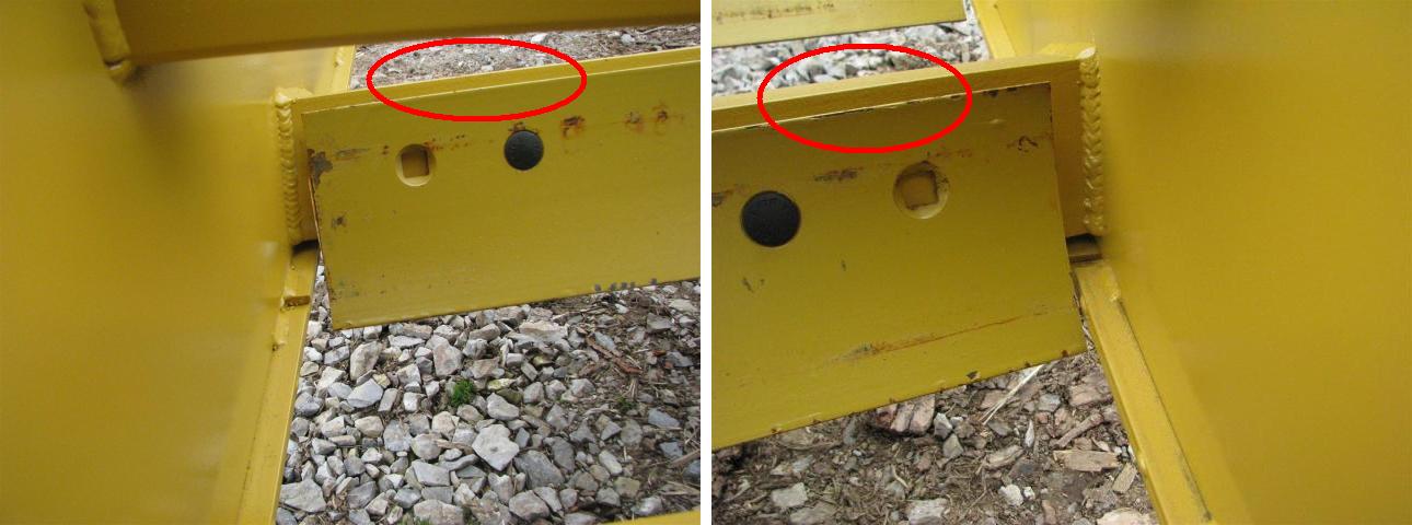

Lookin' good :thumbsup: ... although it doesn't look like the blade is higher on one side than the other - The space between the top of the blade & the top edge of the member it's mounted on looks to be pretty much the same left & right:

I was thinking the same thing. :confused:

It is hard to tell in the picture but there is about a half inch difference. The pic of it full of gravel shows how much migrates to the left or center of the roadway.
I will say this, a 7'er is really almost too big for small one lane driveways because on the return pass it puts the crown way off center. I think a 6'er would have been a better choice, but then again maybe I should just widen the driveway some;)
   / Any GradeMaster owners here? #54
I think that just means you need to tilt the left side up a little more so that the left skid doesn't touch the ground, i.e. that the right skid does skid & only 3 or 4 feet of the blade touches ground, not the entire thing. Does that make sense?
That is, of course, if you're trying to crown your driveway where it has a peak in the middle.
