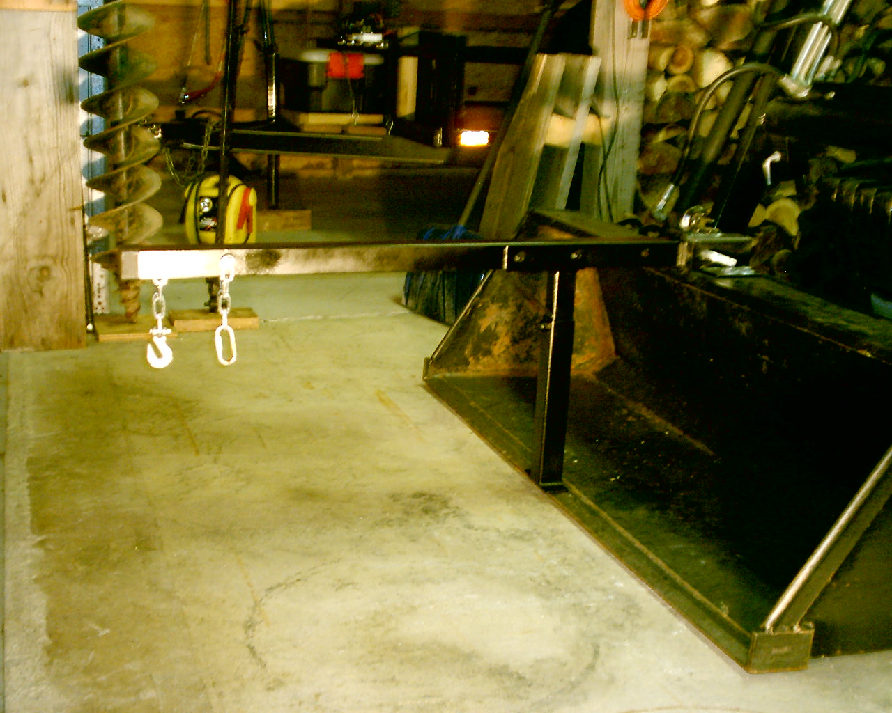

I have a boom pole and its pretty much worthless with a FEL. I have not used it in 5 years. I did make a boom pole for my FEL. It fits in my bucket hitch and adds another 4' of reach. Its plenty strong. I have lifted my concrete counter weight and 5' 600# bush hog with it many times.
