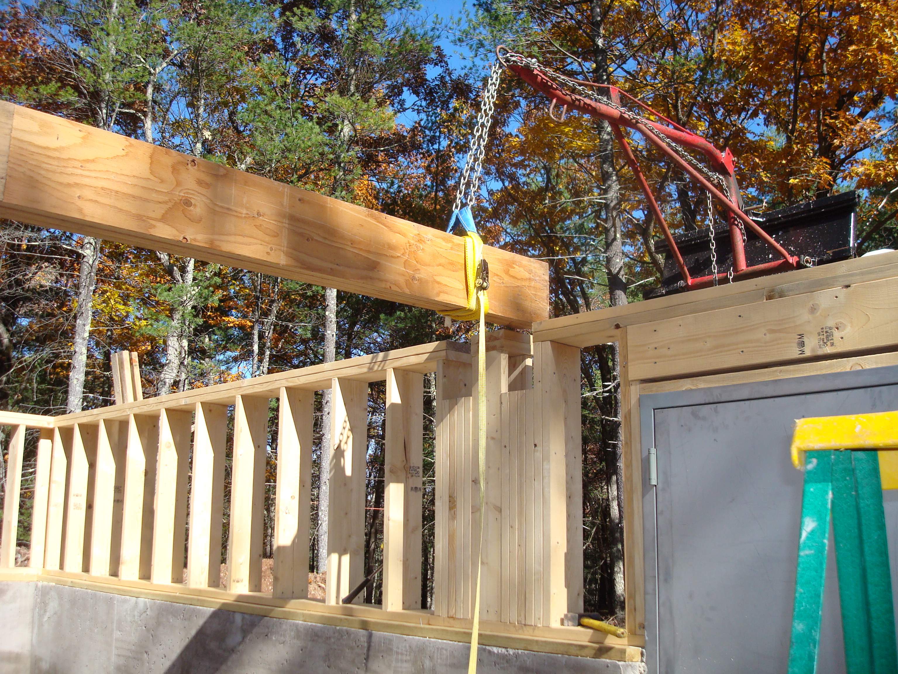

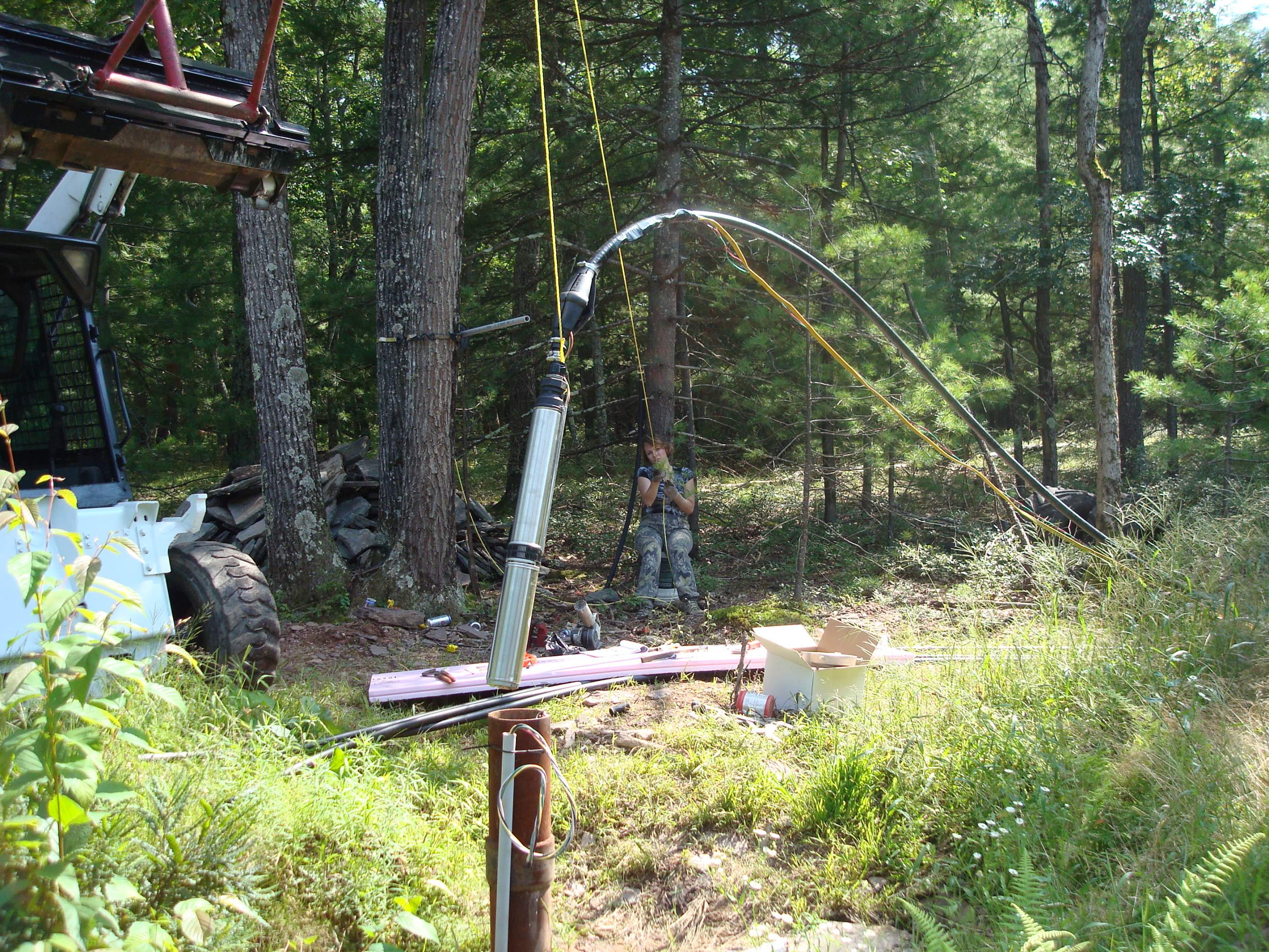

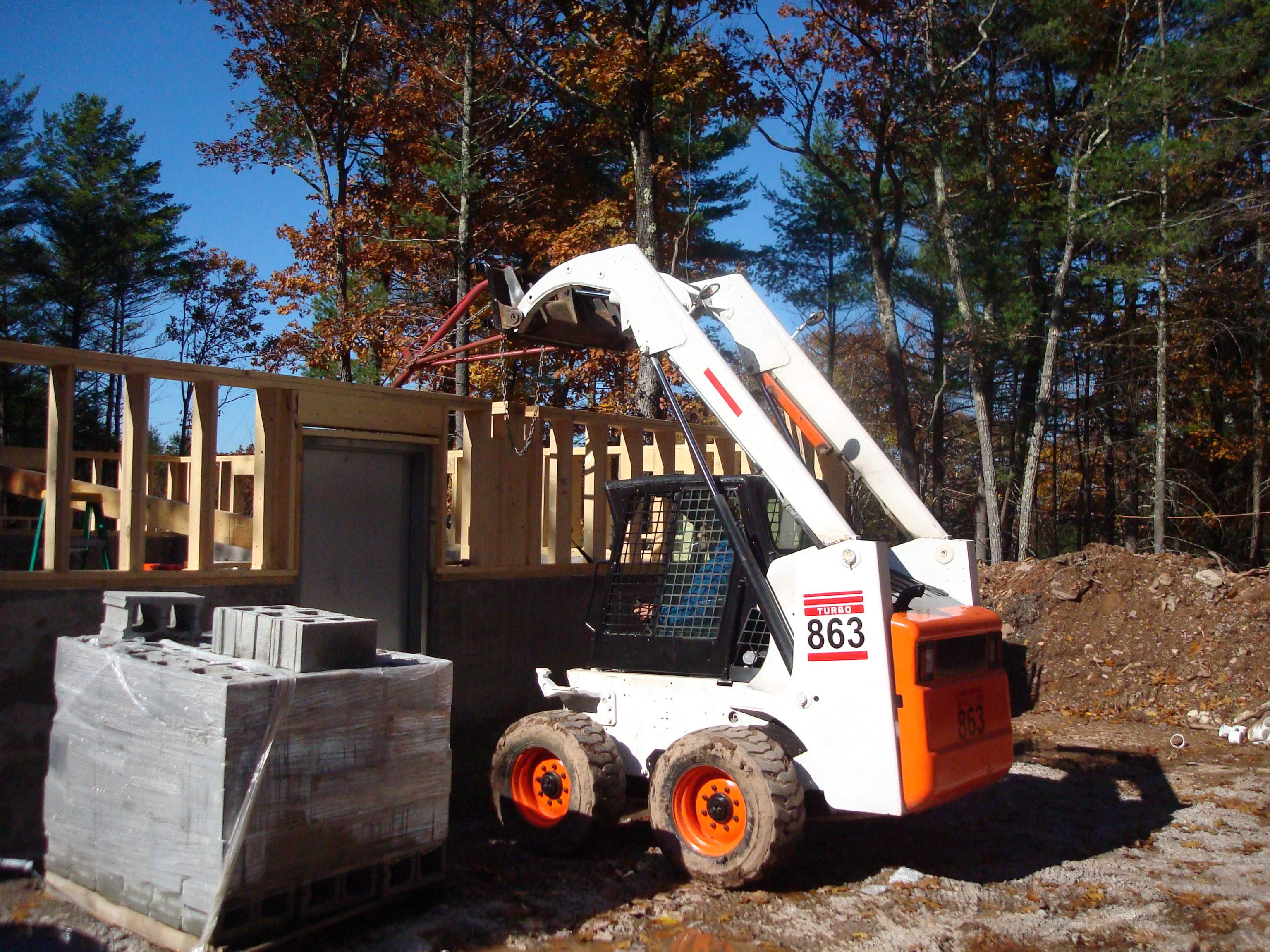

I have a 3 pt. plate for my bobcat and 3 pt.boom which I got whit my 9N, it's very handy ...
In one of the picture I replace the pump for my water well , in the other two I am installing the main been for the floor .

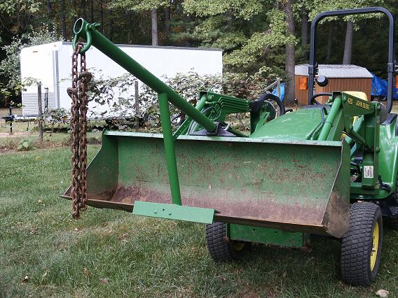

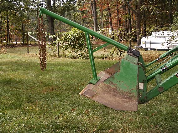

Depends on what ya need to lift. The 3pt will lift more weight than the loader but not as high. The loader will lift higher but not as much weight. I made this for my bucket for picking up stuff.

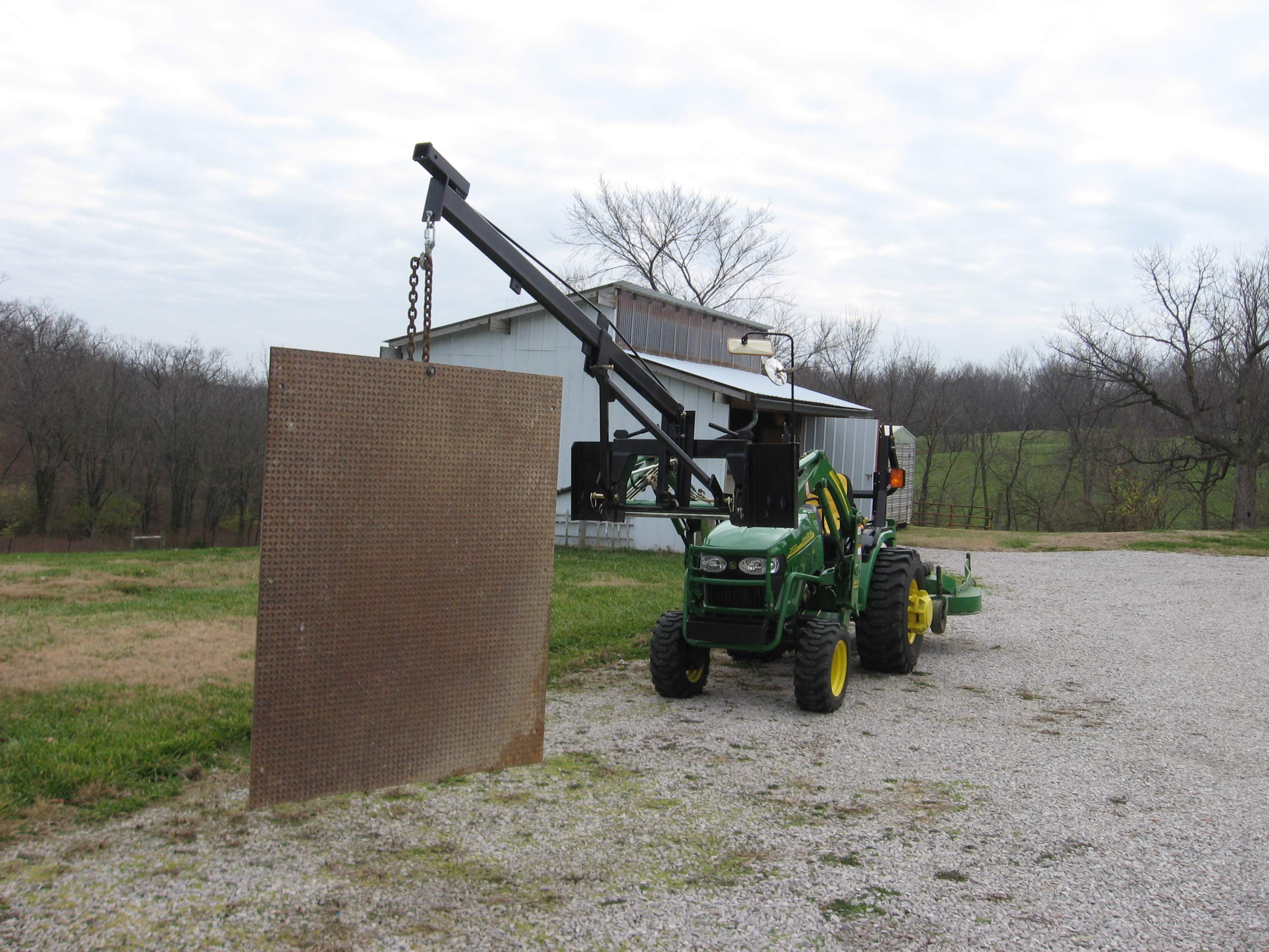

My most recent boom pole use was lifting the top for the welding table I'm building.
   / any use for a Boom pole? after having a FEL. #46
That's a project , when you start the table make pictures .
I wish you easy weldsssss

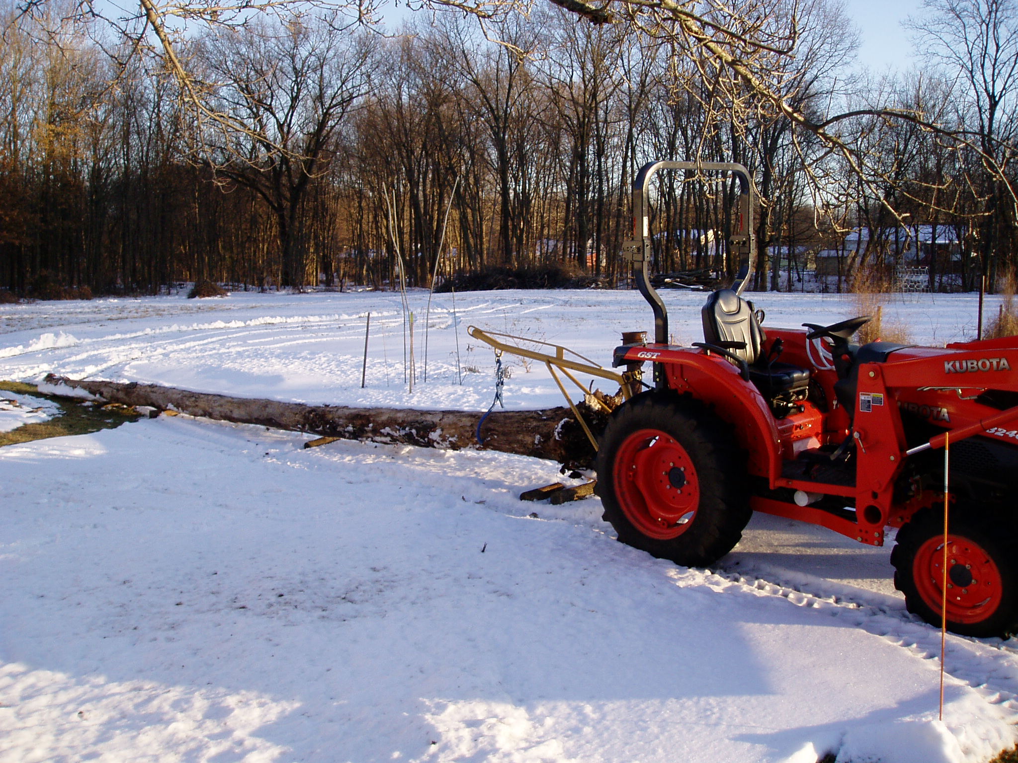

I use my 3 point pole to lift trees after I cut them down. Makes it easier and faster to cut to fire wood length than working on the ground.
