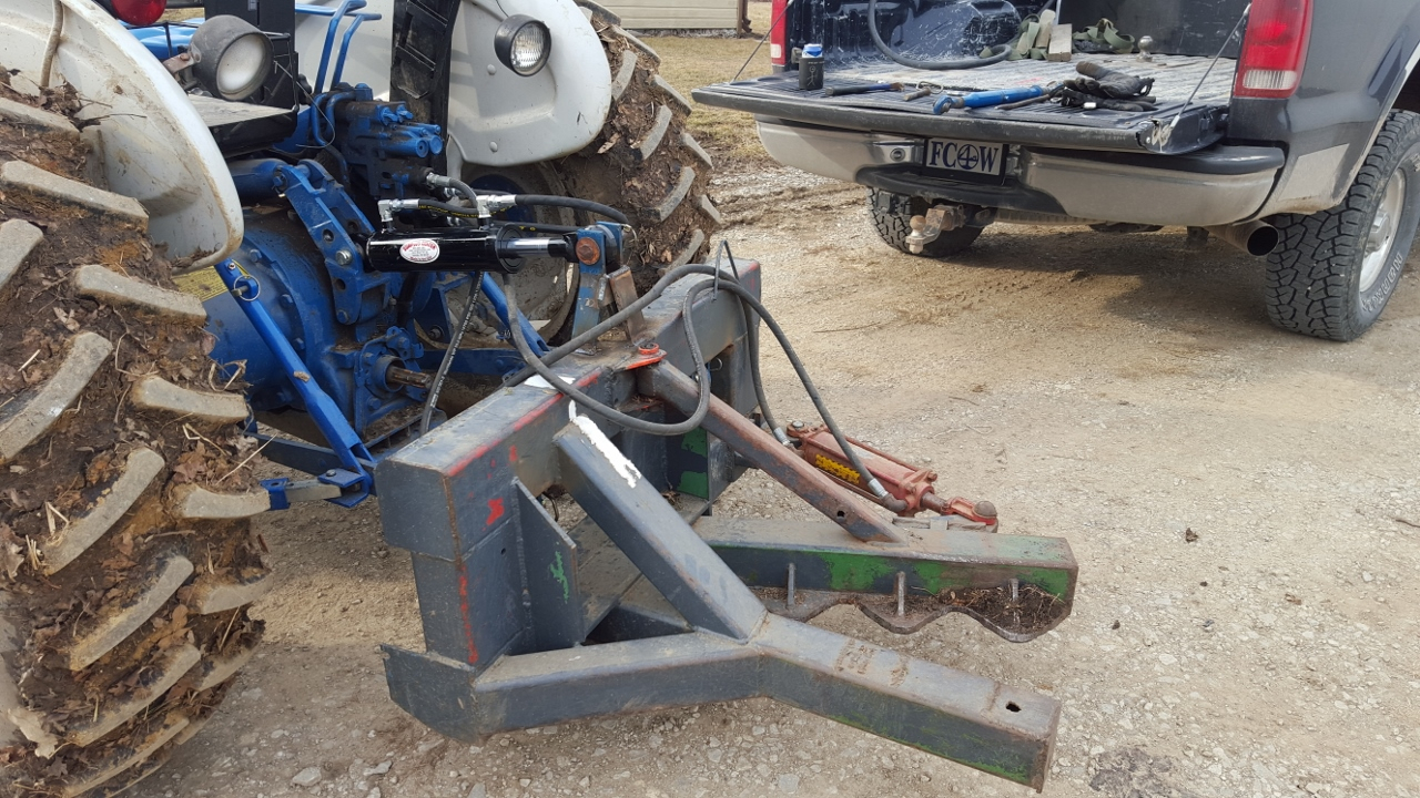

I built a SSQA tree puller. Then added 3pt capability to it. But it also won't fit my QH.
Off topic but I have a similar homemade tree puller. It's a great tool. Handles 3-4" trees with a 45 hp Cat. 1 tractor. Lift and pull at the same time to double the force on the tree. I pull out the trees and carry them straight to the pile.
I've pulled hundreds of trees with mine. Great attachment.

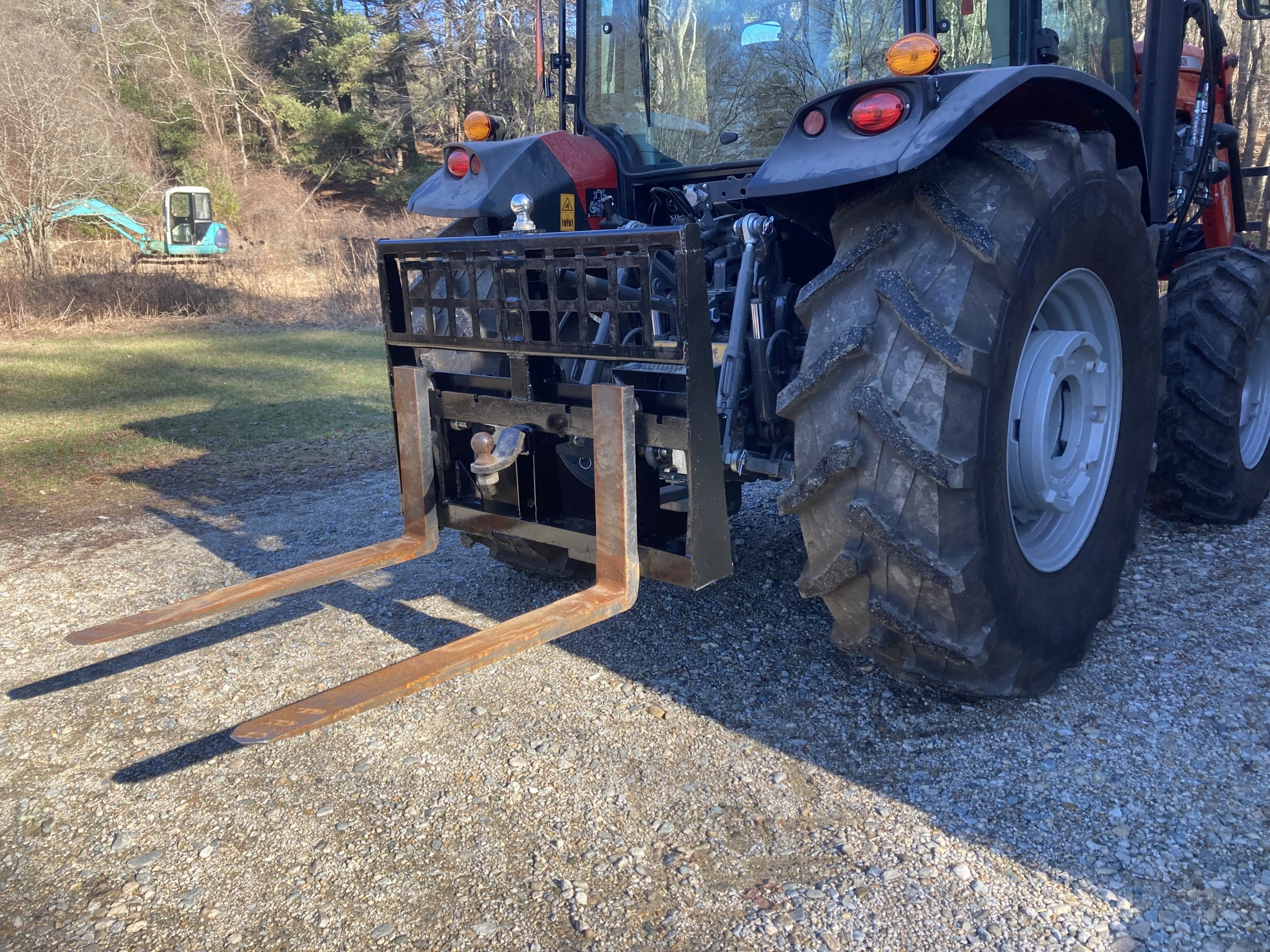

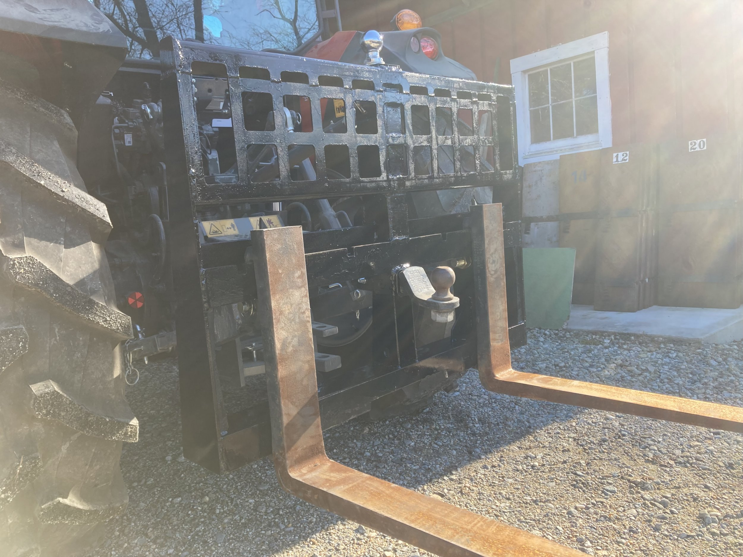

OK, I finally finished it. I converted a SSQA backing structure for forks into a 3pt hitch setup. Also added a conventional hitch and a gooseneck hitch. Forks can be put on and taken off fairly easily. I imagine they'll be left off most of the time as I tow trailers around the farm more than any other task with this tractor. I also had to take a few inches out of the top of the backing structure in order to lower the gooseneck ball.
Here it is:

Very nice!!!!
To remove the forks you slide them to the center where the notch is cut out of the bottom guide?
The load on this tool is going to be on the vertical stem that the top link fastens to. Your tractor will apply a serious load on that part when lifting something toward the tips of the forks. If you think it'll handle the load, everything should be plenty strong!!!
Good work and thanks for the pics!!!!

You can't tell from the pictures, but the gooseneck tower goes all the way to the bottom. Also, the top rail is beefed up towards the tractor.
   / Anybody ever see a 3pt attachment that did the following.... #20
Yep, I studied the pics closely. How far down the tower goes isn't the issue. The issue is the leverage applied from the top rail of the fork mount upward to the top link bracket. It's really hard to laterally brace this. You can't brace forward with any effectiveness. You can't brace rearward with any effectiveness. So you are reliant on the tower itself.
I couldn't tell for sure but it appears you fabricated the tower? If so, the material used is critical. For example, I doubt 4" 1/4" wall square tubing would handle the load. But I don't know the lift capacity of your tractor at the pins?
There are some very intellectual members here. Maybe one of them will see this and chime in. If you share the construction materials used and a few measurements they'll tell you exactly how much force the tower will withstand. I'm no where near that smart. So I tend to overbuild.
