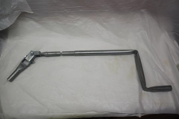

Who needs a clutch, gears or hydraulics? Its 1903 and the pto stops when I get tired, maybe the shearpins will break before my arm does?
If I can get the rpm up at 540, everything should run fine! Need to invest in one of those new fangled overrunning gizmos cept I heared they are powered by black majik an the devil!
