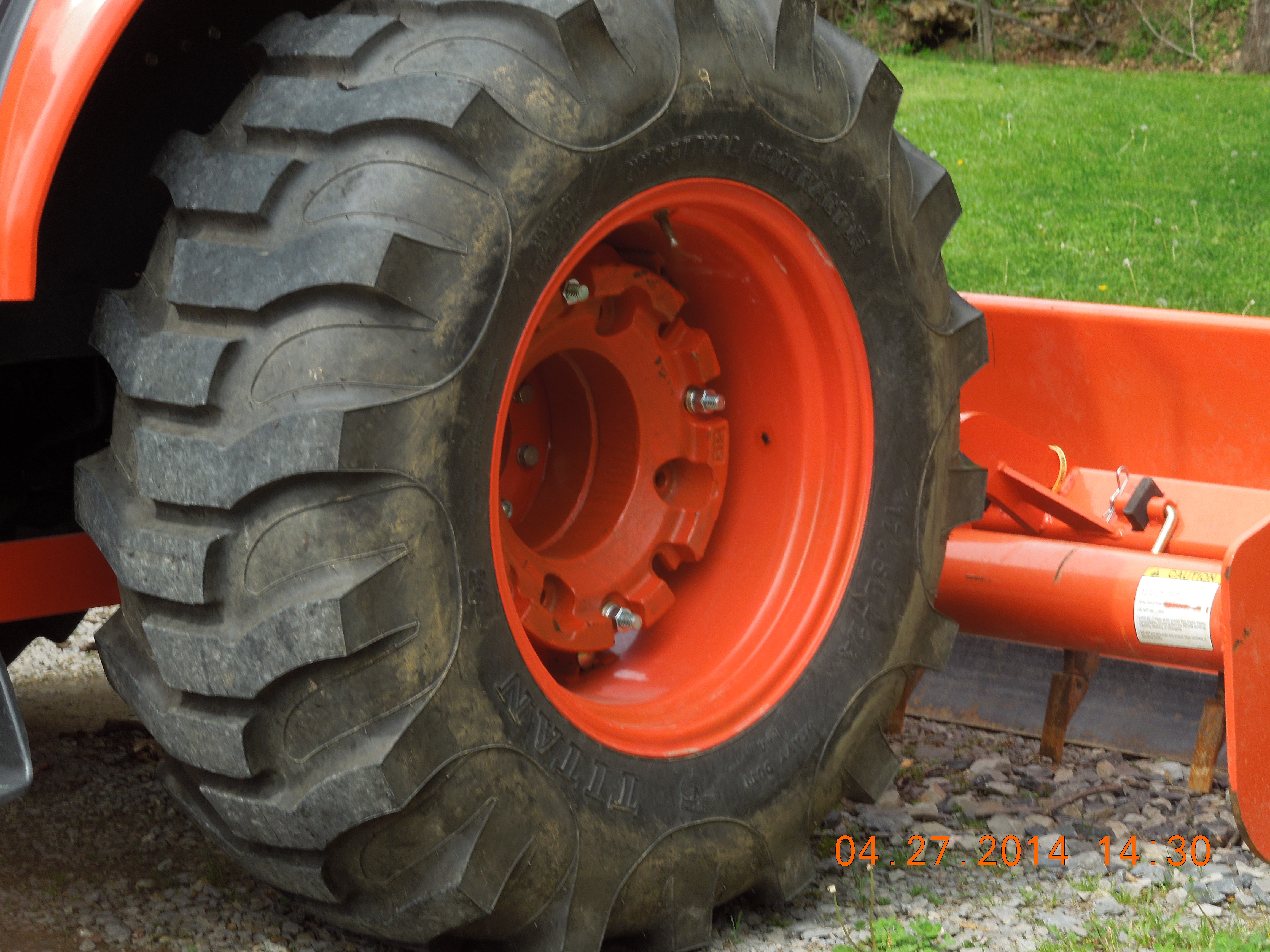

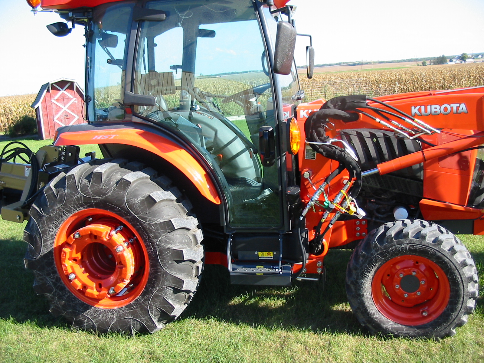

I bought a Kubota L6060 in late 2016, it now has about 400 hours on it and it has been a great machine. I have 4 sets of rear wheel weights and 55 gallons of windshield washer fluid in each of the rear tires, traction isn't a problem for the use I have for it. Inside the cab, left of the seat and to the rear is tool storage area. Cab is great, hydrostatic drive is great, hydraulics are great. Phone Pics 010 (2).jpgIMG_1945.JPG
   / Anyone Own A L6060? #27
I bought a Kubota L6060 in late 2016, it now has about 400 hours on it and it has been a great machine. I have 4 sets of rear wheel weights and 55 gallons of windshield washer fluid in each of the rear tires, traction isn't a problem for the use I have for it. Inside the cab, left of the seat and to the rear is tool storage area. Cab is great, hydrostatic drive is great, hydraulics are great.View attachment 593134View attachment 593135
How heavy are your wheel eights? I have two sets a side as well, but yours stick out more; dealer said I could only use three each side, but I don't need it.
   / Anyone Own A L6060? #28
The Kubota weights are 106 Lbs. each + bolts.
I have two on each side as well and plan to add a third to each side because a third will extend only slightly beyond the rim.
I never use liquid ballast because I repair/change all of my own tires.

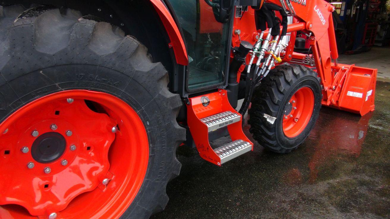

Here are the steps I got.
#30
We must have our wheels set differently. We fix flats on ours too, but we still put fluid in. Now when we get one on our M8540 we call a service truck; just one flat and we decided, naw too old. As time passes, we'll probable take the tire off and trailer it to the dealer.
Do you find the steps on the right side useful? After 55 years of driving tractors I don’t ever remember getting out on the right side.
