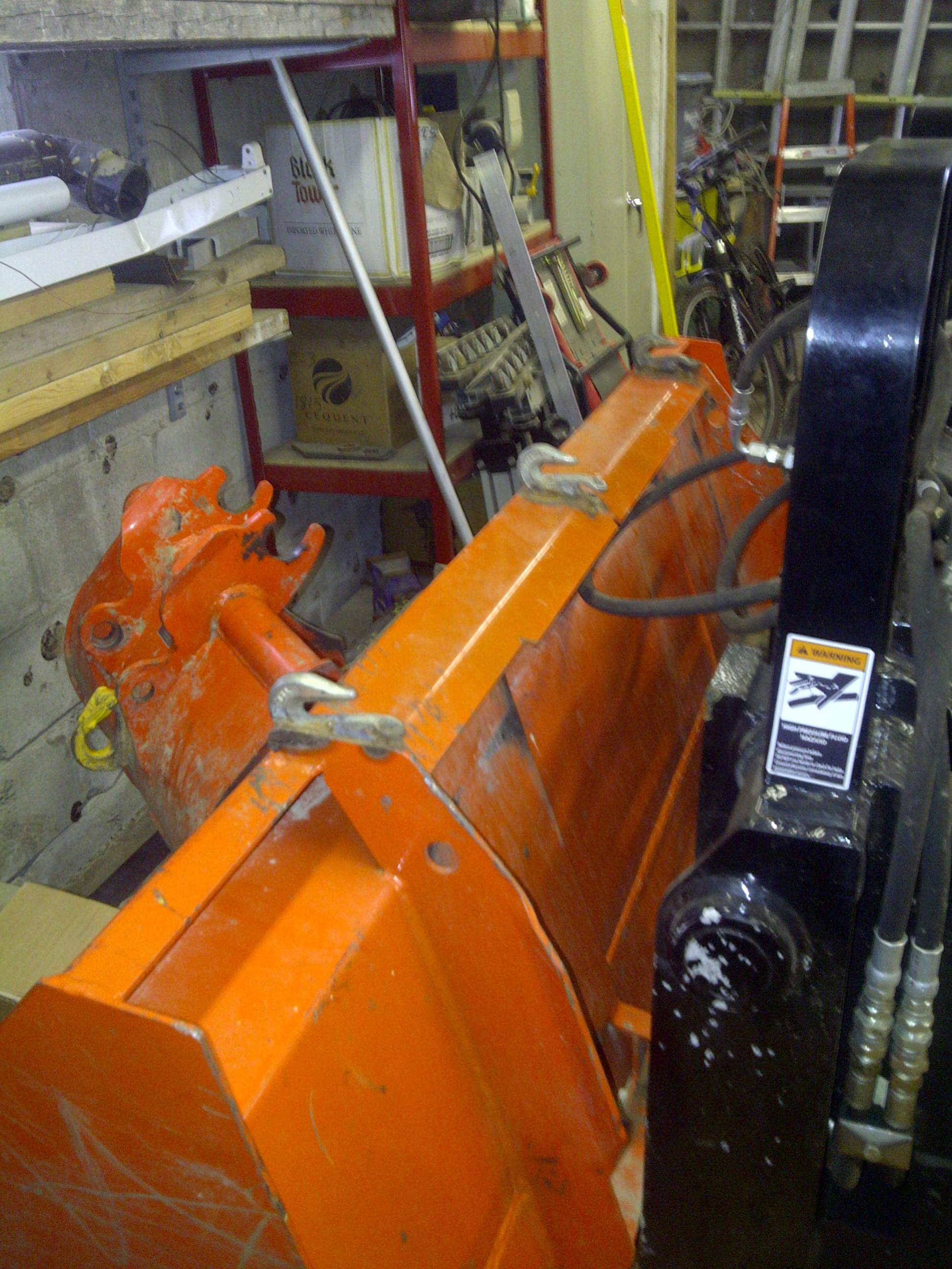

Ihansman thanks for the input. :DQuick question, I want 3 bucket hooks. I have read numerous posts and see that in line with cylinders is the way to go. My question is 5/16 grab hook for all 3? Regarding bh bucket type and location, (I figure the dealer will know but like to be sure. Thanks for all the help and pics to follow.

I have attached a couple of photos showing the hooks on my buckets Rhino421. I used 5/16" grab hooks on the loader bucket as I do have some 5/16" chain. I primarily use 1//4" alloy chain for lifting as it is much stronger, safer and lighter to move around and it works fine with the 5/16" hooks. The front bucket in the photo is the light duty one for the B26 and there was no metal shoulder at the outside edge so I had them welded on near the QA brackets where there was a shoulder as this is wide enough for me. On the heavy duty bucket for the B26 I welded them right at the outside edges as that bucket has a lip there from the side gable. I just think the hook is a little more secure from side loads when it is welded both on the bottom and the side but that is just me.
I have also attached a close up picture of the hook on the backhoe bucket. I do not know what these are called but these are available form a number of lifting accessory suppliers. These yellow hooks even have a curved back to them to conform to the backhoe bucket. The one in the photo is a 1 ton rated unit which is more than enough for the B26 hoe. Note that the safety latch is of the same heavy duty construction as the rest of the hook so if you are lifting something heavy and curling the bucket you do not need to worry about the chain slipping and breaking through the safety latch as with some latches. I also tuck the hooks in as tight as possible to the pins in order to keep it out of my way as much as possible when digging. Unfortunately these hooks are quite a bit more money but I think the safety factor makes them worth it.

My opinion is go with 3/8's hooks. If you use smaller chain you can at least loop around and hook to itself. If you have smaller hooks you are out of luck with larger chain.
