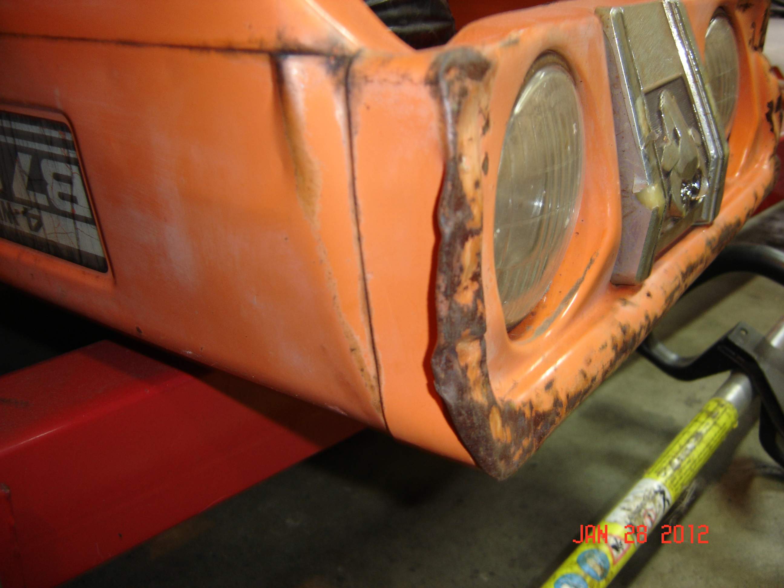

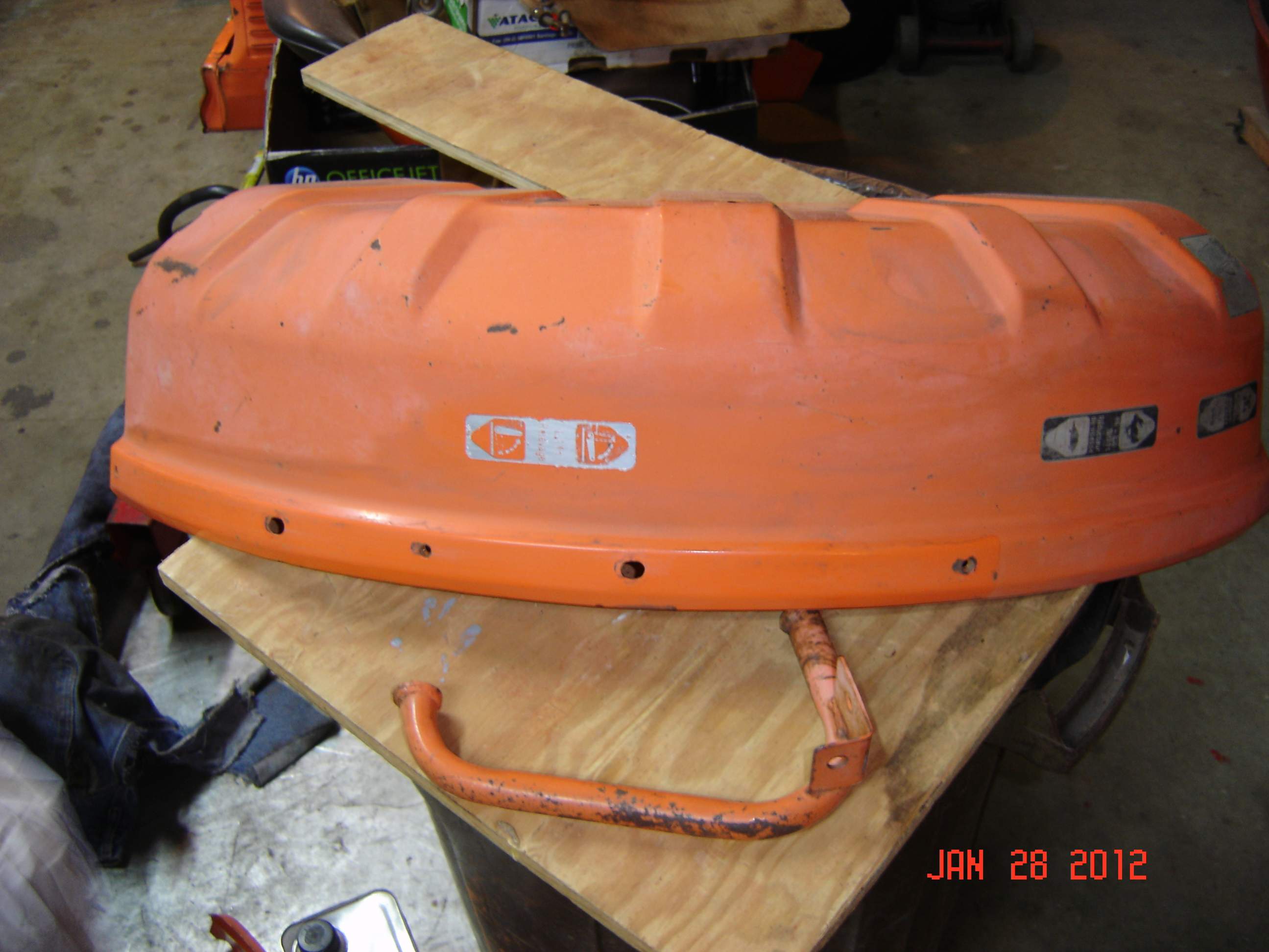

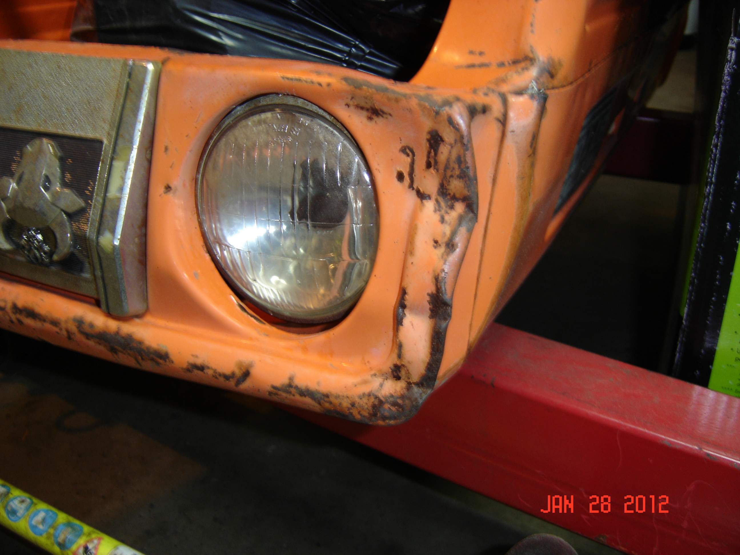

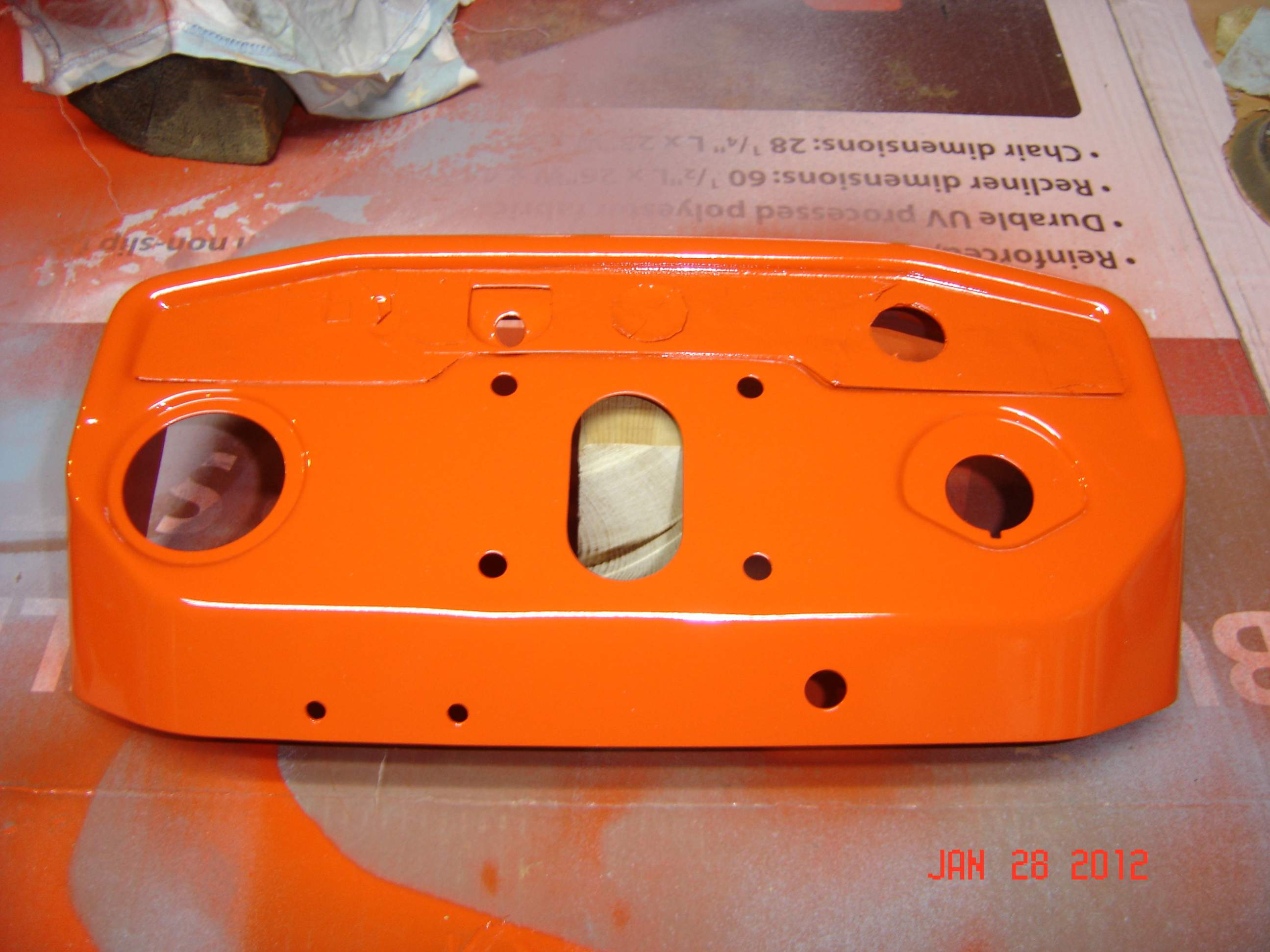

Old paint,new paint.Spent he day sanding, priming, and painting sheet metal parts. Decided to use the newer Kubota Bright Orange to give my tractor a more current look. The hood is beyond repair and still haven't located one salvage. DSC03899.jpg

   / B7100 Restore Project Has Begun #66
You primed your cat?
Actually, your parts are looking good. Hope your able to locate a hood.
   / B7100 Restore Project Has Begun #67
Nice work! I wonder how someone does that much damage to their hood. If you're careless or make one mistake, it happens once. But it looks to me like that hood had multiple impacts. Wow.
Wow, that hood looks way worse than mine and mine is beat.

Ordered the transmission parts new yesterday. Tired of looking and finding. used parts that were as bad as mine. Finished painting the fenders and then hammered out my demolished hood to the point that lots of body putty would fix it but the chances of cracking would be high. Still looking for a real good salvage hood. I know that there are lots of B5100,6100, and 7100 tractors out there that have been parked to kill weeds for an eternity if only I could find them.
