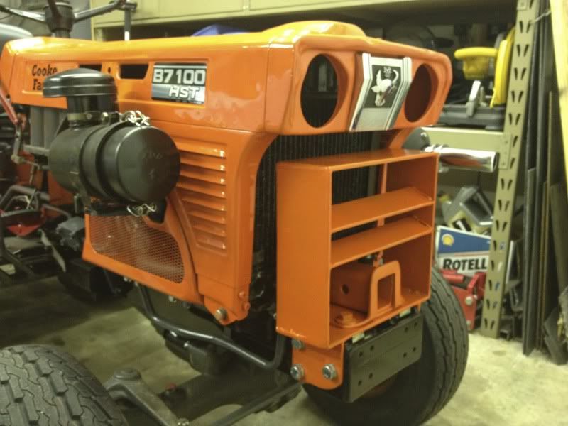

Meanwhile I built a front grill pictured below. That radiator was too exposed for me - my boys seem to run into everything when they 'tractor'. I did not put any expanded metal on the front of this one (unlike all others) since wanted to be able to reach in and clean the radiator front. It looks a little awkward, but then so does anyone over 6 ft sitting on this little machine - but that gives it some of its appeal to me.
That's pretty cool. How do you open the hood? As for the headlights, I've wondered if I could fit some 12volt LED spotlights in there. My son's LED Maglight is really bright but the wrong voltage.

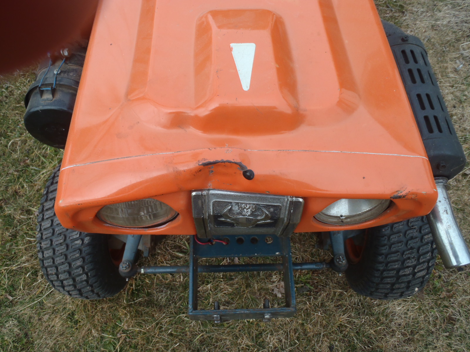

Here's a picture - think I can knock that out? Doesn't have to be perfect:
Yea, it can be straightened and filled like mine or as has been suggested new sheet metal formed and welded over it. I have been giving some thought to using aluminum to form a new front and cutting a sheet to cover the top center which is wavy. Original may have to change to custom before its finished.

Thats a really good job. It looks tough enough to handle any youngster and blends in to look like a factory front bumper. As for head lights I have been looking for replacements also. Have found out that some old Murray riding mowers had a headlight that would fit our hoods. Have also tried a round equipment sealed beam bulb and it fits behind the opening and could be mounted with a fabricated bracket.

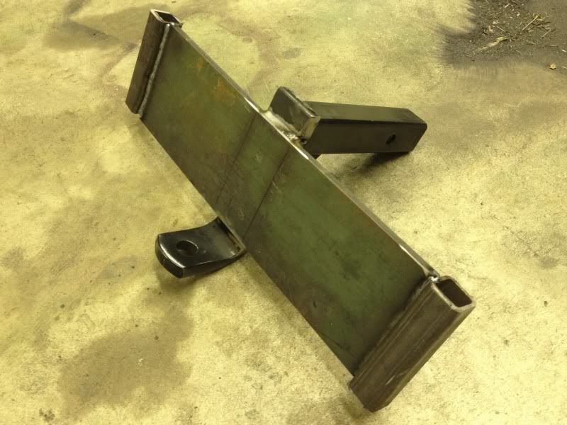

I am "fabbing" up a mount to hold suitcase weights on the front. I get a kick out of seeing adds for old Kubotas and other tractors with all sorts of pieces of concrete and boat anchors hanging off the front. A "field expedient" solution I realize but not the definition of "high speed low drag".

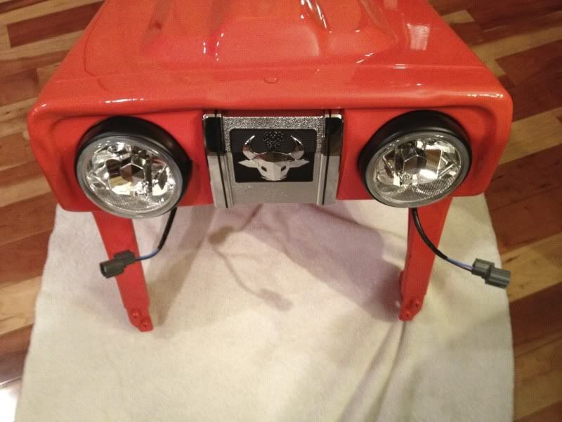

Headlights still a mystery to me. Can get replacements from Messicks, but at $60 each, I'd rather improvise something - anybody can buy 'em. How can we be creative and solve this....

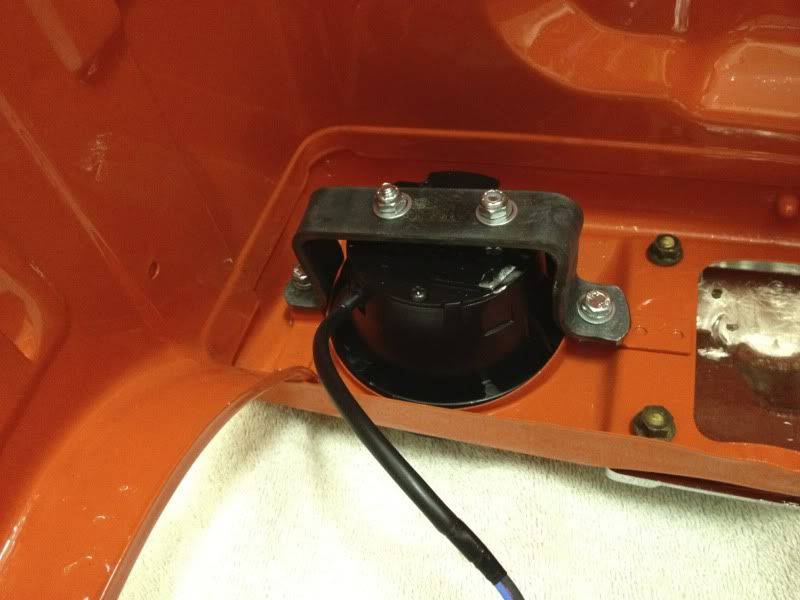

Honda Pilot fog lights. They are sold on ebay for about $50. Come with wiring harness and other parts to be thrown away. 55watt bulb. I already tested the electronics and they do work. They work off a relay and a fused direct battery connection. Spent some time fashioning the bracket to hold them in place. Pretty solid now. If anybody goes with these I can give you more detailed instructions of how I modified the wiring harness, etc. I will do a test night image next few days once I have it back together for good. Thanks.

#88
Looks like they will work. That is similar to what I was thinking with my Dodge driving lights. They are 3.75" OD and fit the opening good. I still haven't started on my hood yet. Due to a major brake job on my sons badly rusted truck my shop and time has been tied up all week. I was able to get the tractor halves back together tonight after I ran out of parts for the truck. Still have to clean and paint the body, wheels, and hood.
