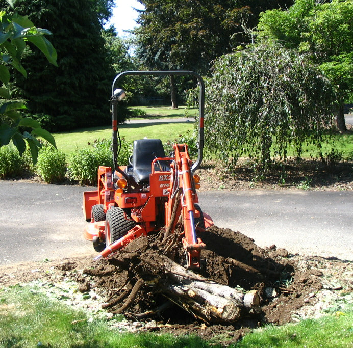

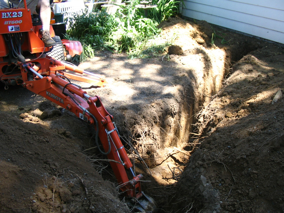

I own/operate a BX23...Very similar to the BX24...I dug a 3' deep x 50' trench for an electrical "lay in" with it and it took maybe 6 hours...I don't do it for a living so an experienced BH operator would probably cut that time by quite a bit...The bucket on my BH is 10" wide...I've removed quite a few stumps and the BH is a very handy item to have around the place...Good luck with your choice.
