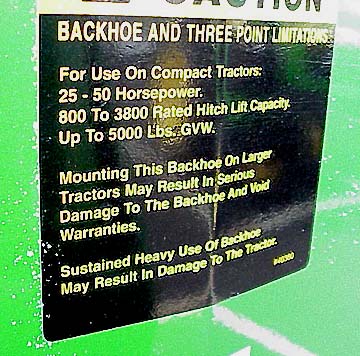

Perhaps what ultimately keeps me away from the L series is the big increase in weight from the B series, more than 1500 lb. It would mean needing also to buy a larger tow vehicle for those times the tractor will get to go play out and about.

/ Backhoe quandary #28
Lawsuits against both manufacturers usually work that way. Ask the people with the
Class "A" motorhomes how hard it is sometimes to resolve
problems between the coach manufacturer and the chassis
manufacturer.
It can still fall on you. Why put yourself in such a
position right off the bat? To me tractors and tractoring
is something I do to relax, and lawsuits don't figure into
that.
I've learned from this thread as well. I have not seen
a non OEM backhoe that is frame mounted but it appears they
exist or are coming; and I've never seen a Kubota 3-point
backhoe and it surprises me they would sell such a device.
It's much quicker if you don't have to remove and replace
the 3 point arms to use a backhoe, but every inch a backhoe
is mounted rearward makes it less useable for ramp clearance
issues, off road issues and stress on the tractor.
What would be really slick is if someone came up with a
"backhoe hitch" design that all the OEMs' used, very strong
just for a hoe. The 3 point is designed for implements that
have to move up and down which a backhoe doesn't. If there
was some sort of massive frame mount structure to mount a
"built for that" hoe everything would be solved. Like the
skid-steer mounting system.
Any hoe would work on any tractor without question, come off
and come on without much delay and be structurally sound.
Someday maybe!

/ Backhoe quandary #29
"What would be really slick is if someone came up with a
just for a hoe."
Maybe that's what Woods is heading towards with the permanently attached frame I mentioned in my earlier post. I haven't seen any info on it yet, just know what my dealer told me. What I like is the fact that it is bolted to the tractor instead of pinned. Seems like it would be more solid. Also might give some protection underneath from stumps, etc. Mayhaps would strengthen the whole tractor. I couldn't find any information on the woods site about it.

/ Backhoe quandary #32
</font><font color="blue" class="small">( "What would be really slick is if someone came up with a
just for a hoe."
Maybe that's what Woods is heading towards with the permanently attached frame I mentioned in my earlier post. I haven't seen any info on it yet, just know what my dealer told me.... I couldn't find any information on the woods site about it. )</font>
They call it their "four point hitch" backhoe frame, and it's already available for Kubota compacts... I saw one at my Kubota / NH dealer. Unfortunately for me, it's not yet available for NH compacts.

Your choice of a subframe mount will allow you to use the backhoe to pick the machine up off of its feet in order to (gently) move it right or left and set it down exactly centered on the dig line.
Without that capability, it would take me forever to dig a perfectly straight trench.
Be sure to raise the FEL off of the ground a couple of feet so that the machine rotates on the front tires during the centering process.
