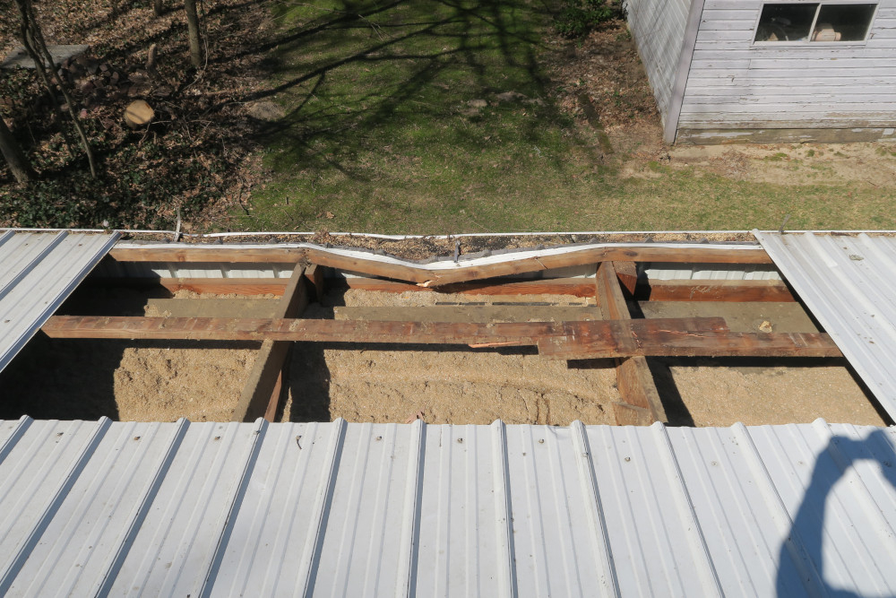

You insurance co. may be your best bet. I say this because from the picture the roof is bent below the bottom Purlin which means if you do have structural damage it will be the eve strut ( and possibly the Purlin) The Eve Strut is much more detailed than a purlin the eve strut ties the two bays together supports the roof sheet as well as being the component that the top of the wall sheets are secured too. To change the Eve Struy all the wall and roof sheets must be unscrewed if you have the typical vinyl backed insulation it will need to be detached from the eve strut and replaced but on the other hand from the picture you may not have enough damage to go to the expense to replace all this. Oh well just an obersrvation from an old building erector. After all it is you call I hope all goes well for you.

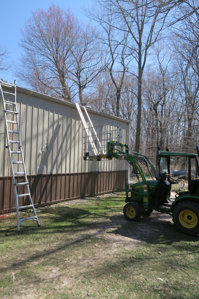

when you get ready to clean it up I highly recommend a boom. If you have a Home Depot rental near by you can rent a tow behind one pretty reasonable and take it down in small sections. Just take your time and think before you cut.

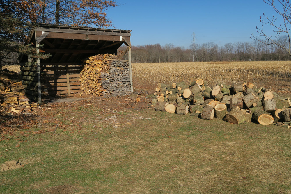

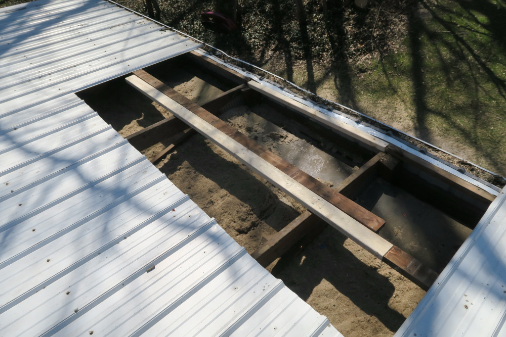

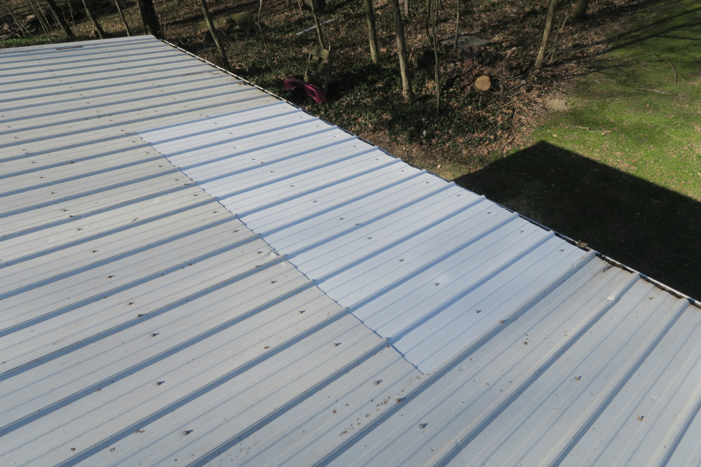

A quick update. All the wood is cleaned up and I've ordered the replacement metal. Should be here next week. I haven't taken the damaged roofing off yet, so I don't know if the eave purlin is damaged, but if it is I think I should be able to scab in a replacement. Fortunately I have trusses on 4 foot centers, which takes away a lot of the structural concerns with the purlins.
More to come. Silver lining in all this is that, combined with another tree I took down last month, I'm about set to restock the firewood storage.
