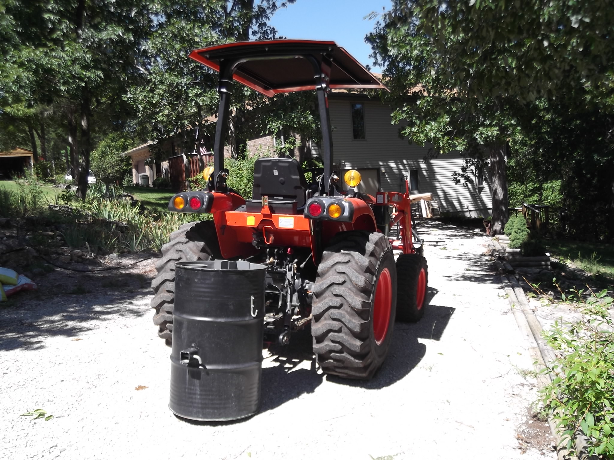

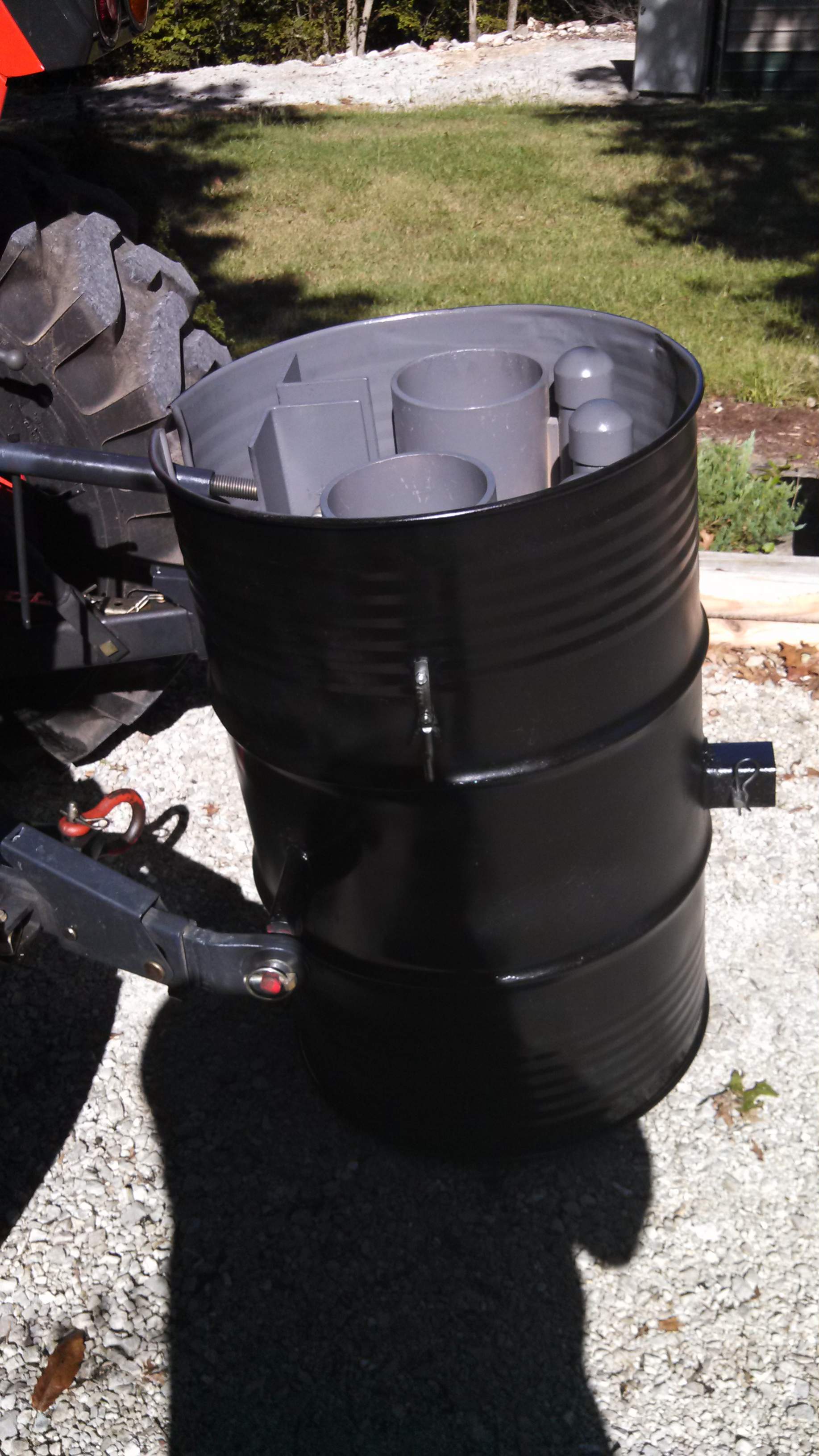

Nice! Dare ya to paint "Jimmy Hoffa inside" on the box! :)
Sent from my iPod touch using TractorByNet
/ Ballast box--how big? #43
You will have the Feds busting it up to check! :)

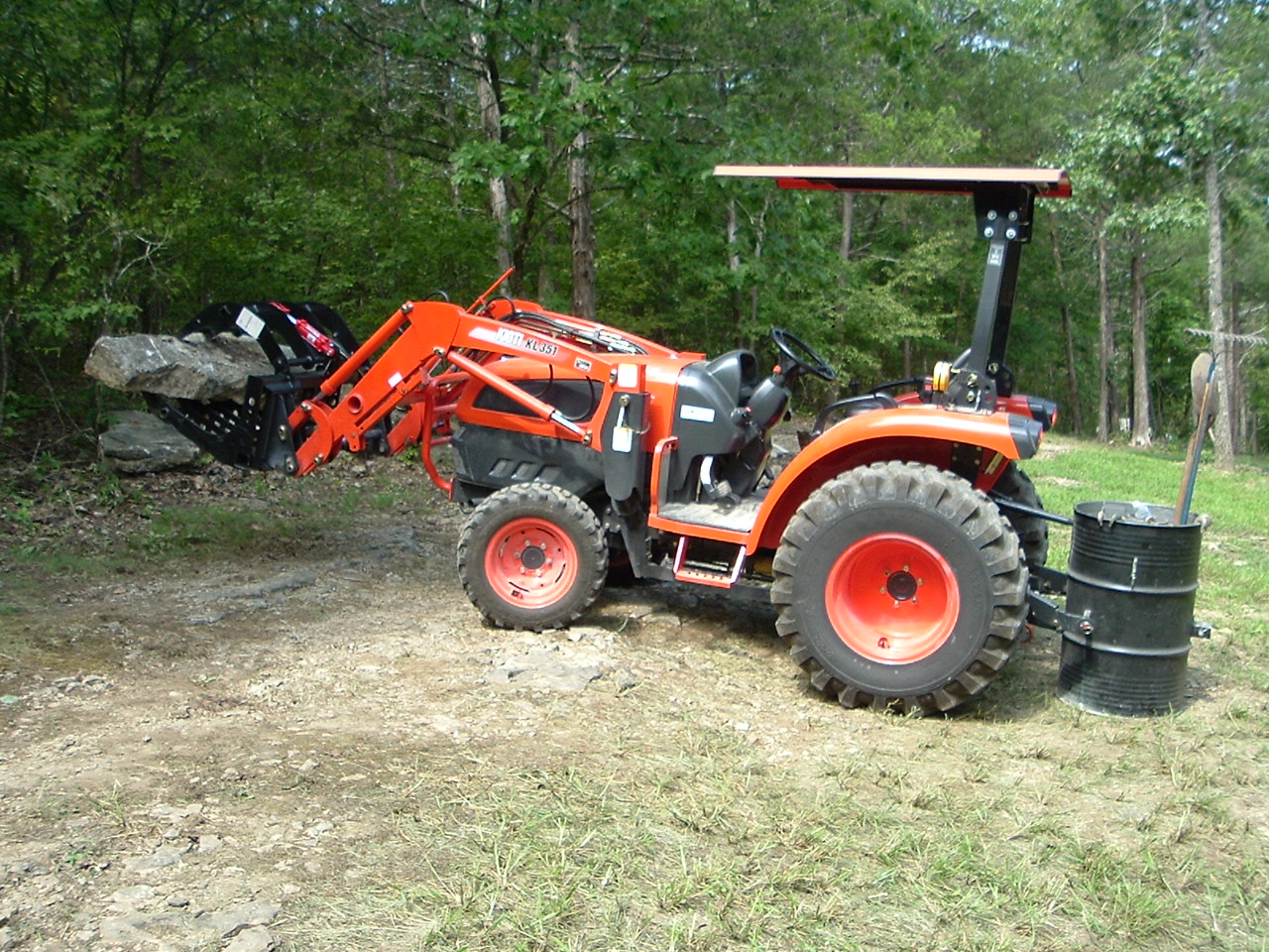

This is critical, because the front axle of compact tractors is not designed to take the full weight that the loader can lift
Hi guys, been watching for awhile but this is my first post, thanks for having me... what a great message board!!
I found joshuabardwell comments a little troubling. Is this a fact, generically speaking? I mean, it would be irresponsible (and bad business) for engineering to provide a FEL option and not design the under-carriage to support the rated load? I appreciate the physical advantage of having rear ballast, but does not having it when doing loader work constitute abusing the machine? That could create a mess WRT to warranty issues not to mention long term reliability, just saying. I interpreted those numbers to be what the tractor/FEL was rated for.
I'm not challenging your expertise, this is my first "real" tractor and I'm just trying to learn. Thanks to all for sharing your wealth of knowledge and I welcome your input.
Mike
/ Ballast box--how big? #58
Mike
Welcome aboard Mike!
This is a topic that always seems to generate a lot of discussion, with little agreement. I think most folks will admit that compact tractors don't have nearly the front axle strength of dedicated TLBs, wheel loaders, or backhoes...you can look at them and tell that's true. I think most people would also agree that if a machine can lift the rear wheels off the ground with a heavy load on the FEL, it can't be good for the front axles. Even if they don't fail, it has to cause faster wear than if you add a reasonable amount of counterweight, and lighten the load on the front axle. People want to add weight to the rear tires, because it's more convenient, and they may not lift the rear tires any longer, but they're not taking weight off the front axles. Having the tractor rotate around the rear tires is the only way to do that, and you need 3pt weight to make that happen.
If you go by the manual for your Kioti, they specify an actual weight for the 3pt while doing FEL work. Going off memory, I think they spec something just over 1K on the 3pt for a DK40SE. I know that 800lbs wasn't enough on the 3pt to keep my rear wheels planted when I tried maxing the loader on my LS, but with my 1,400lb counterweight, everything stays planted on the ground.
I have to figure that if Kioti thought it was important enough to spec an exact number, and publish it, there's a good reason for it....just seems to make sense. As far as warranty issues, I suspect any damage would be considered wear, or improper use, not an actual warranty issue. I also suspect that barring pretty blatant abuse most will make it past the warranty period before problems crop up.
/ Ballast box--how big? #59
As Bart outlined this always generates controversy, but I can think of one member that claimed he never used ballast and then after several years had failure and excessive wear of front end components on a Kubota. He is a proponent of ballast now. I don't think anyone is saying if you do FEL work without ballast on the 3pt you are going to pop something immediately on most of the quality built tractors, but it has got to add extra wear, don't you think?
/ Ballast box--how big? #60
I recently added about 900lb to the rear of my DK50. As much as the wear issues, I found it frustrating to work without the rear weight when the tractor wanted to do a headstand.
