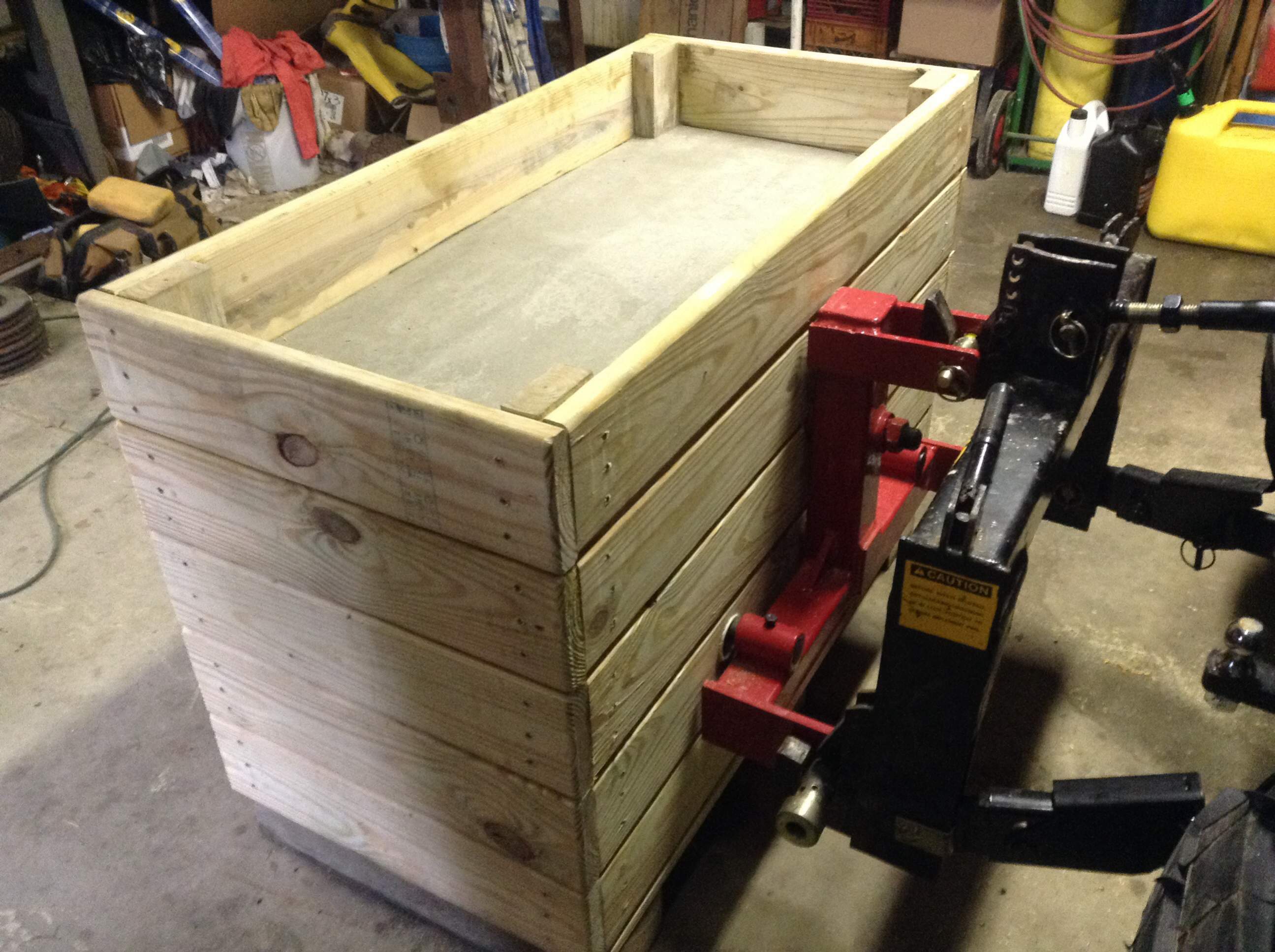

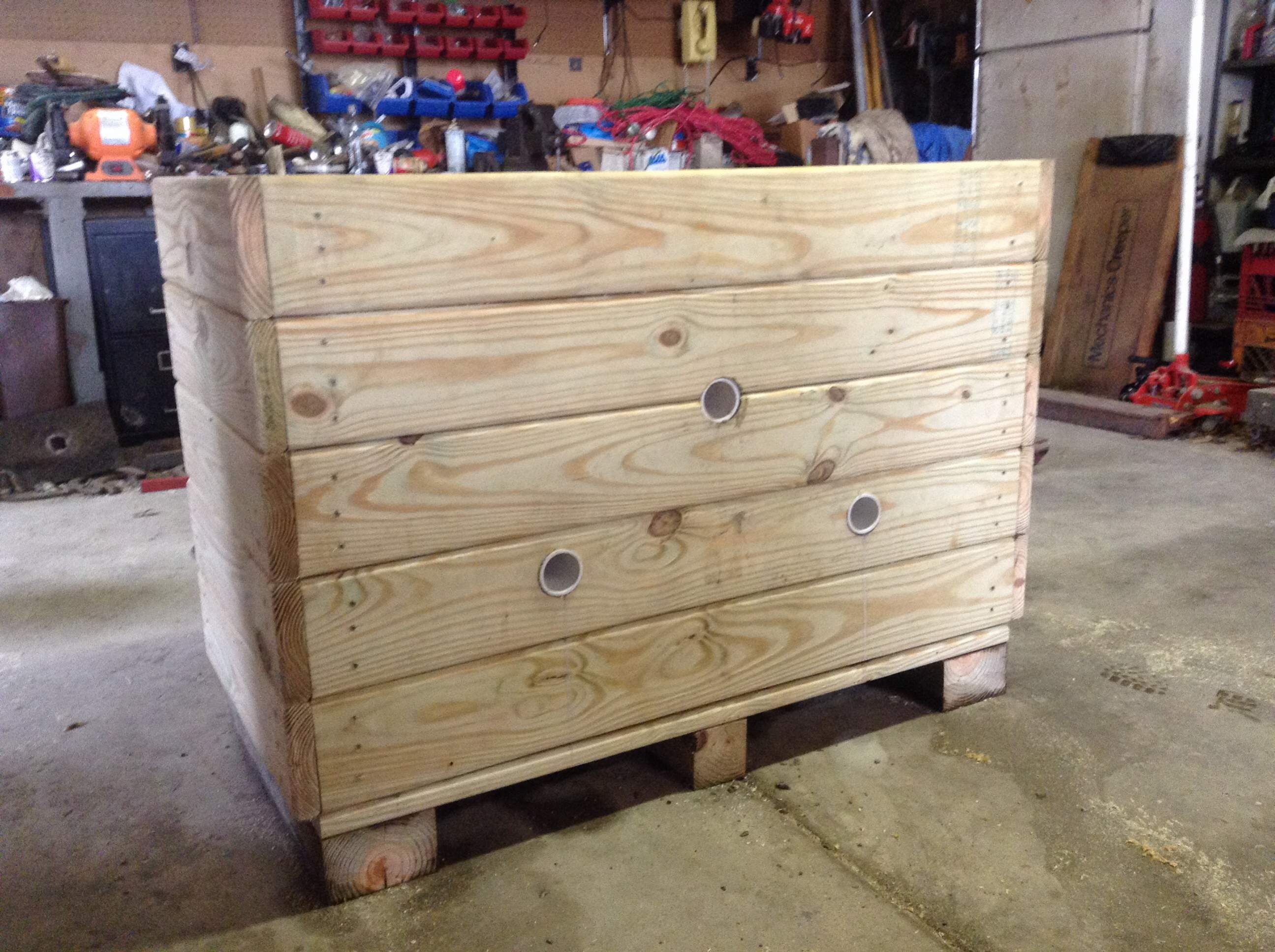

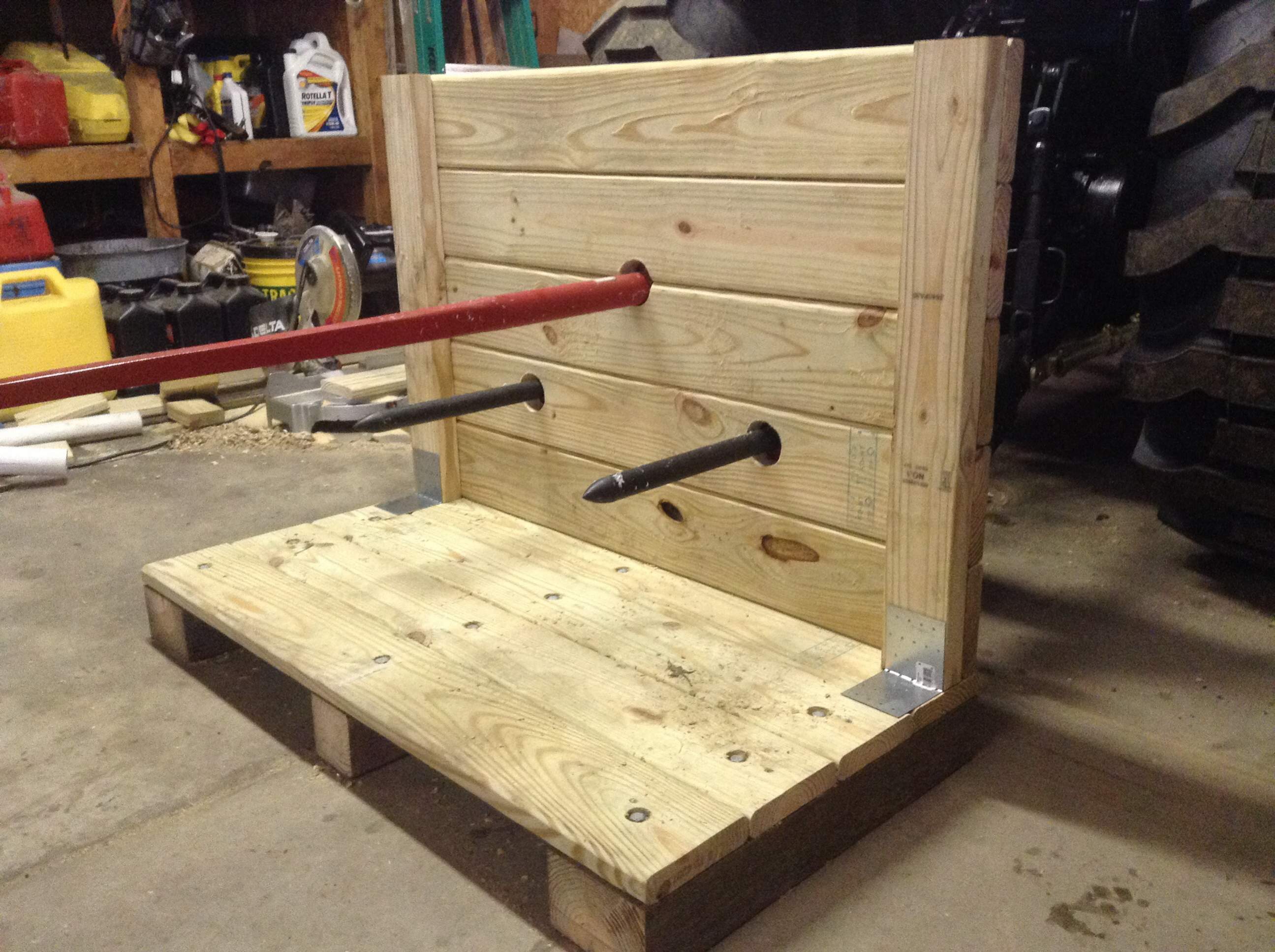

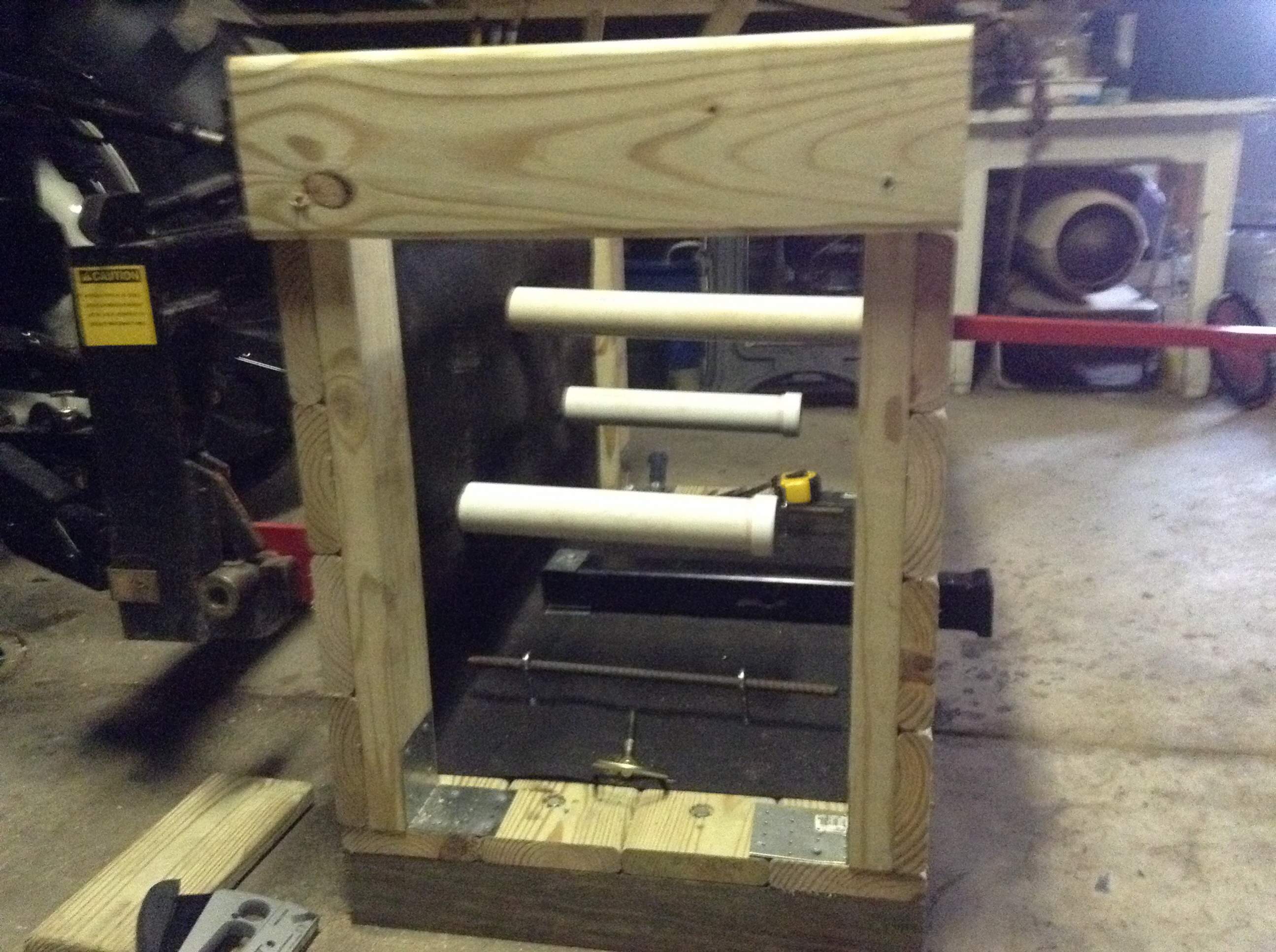

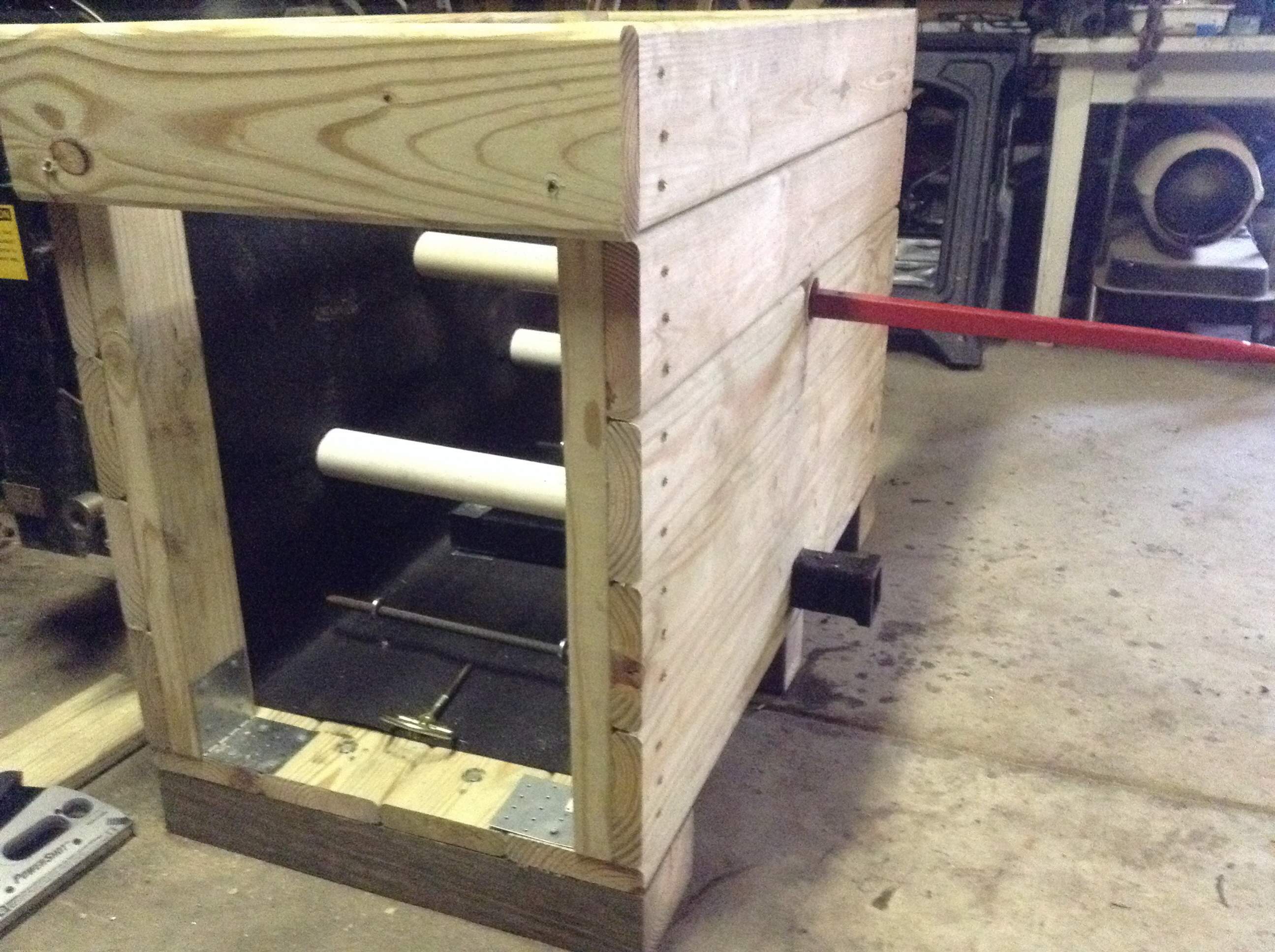

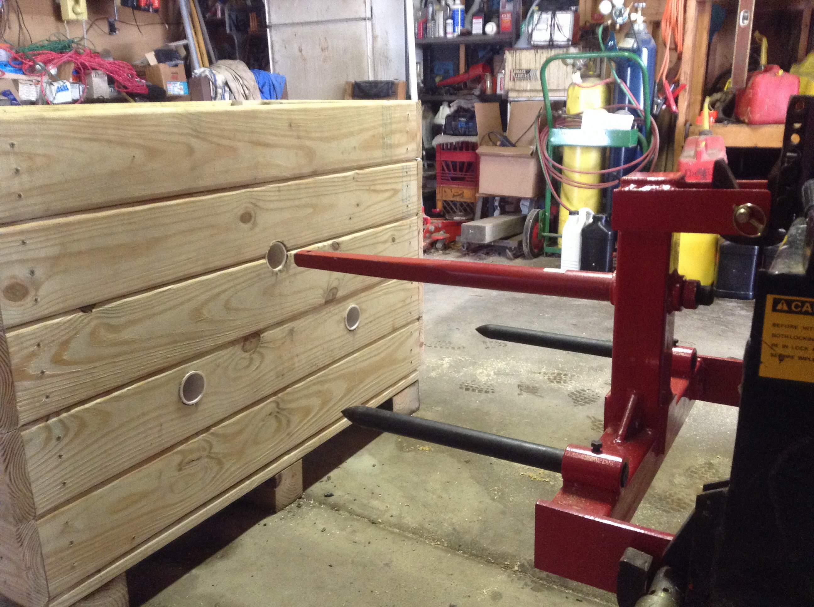

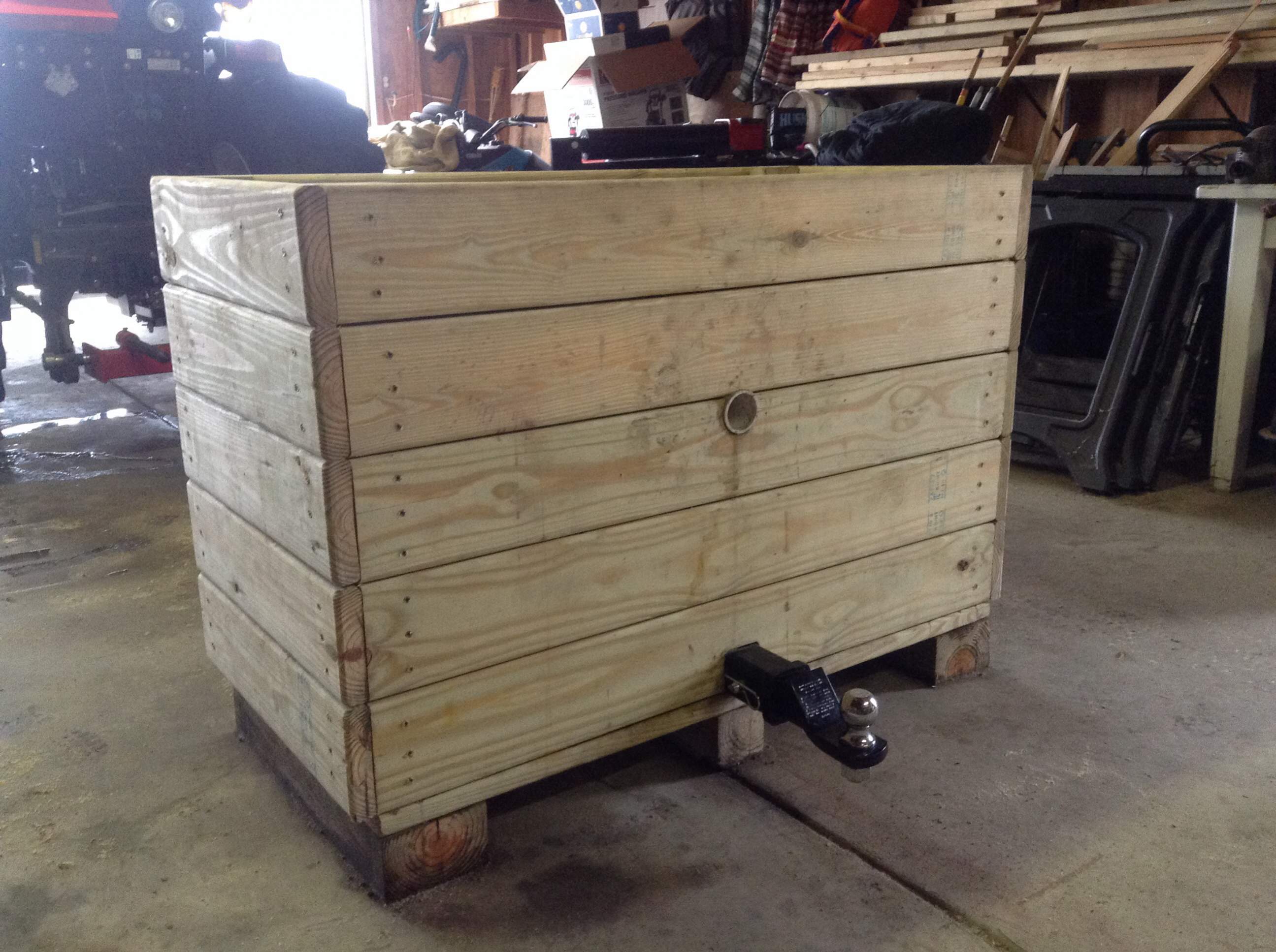

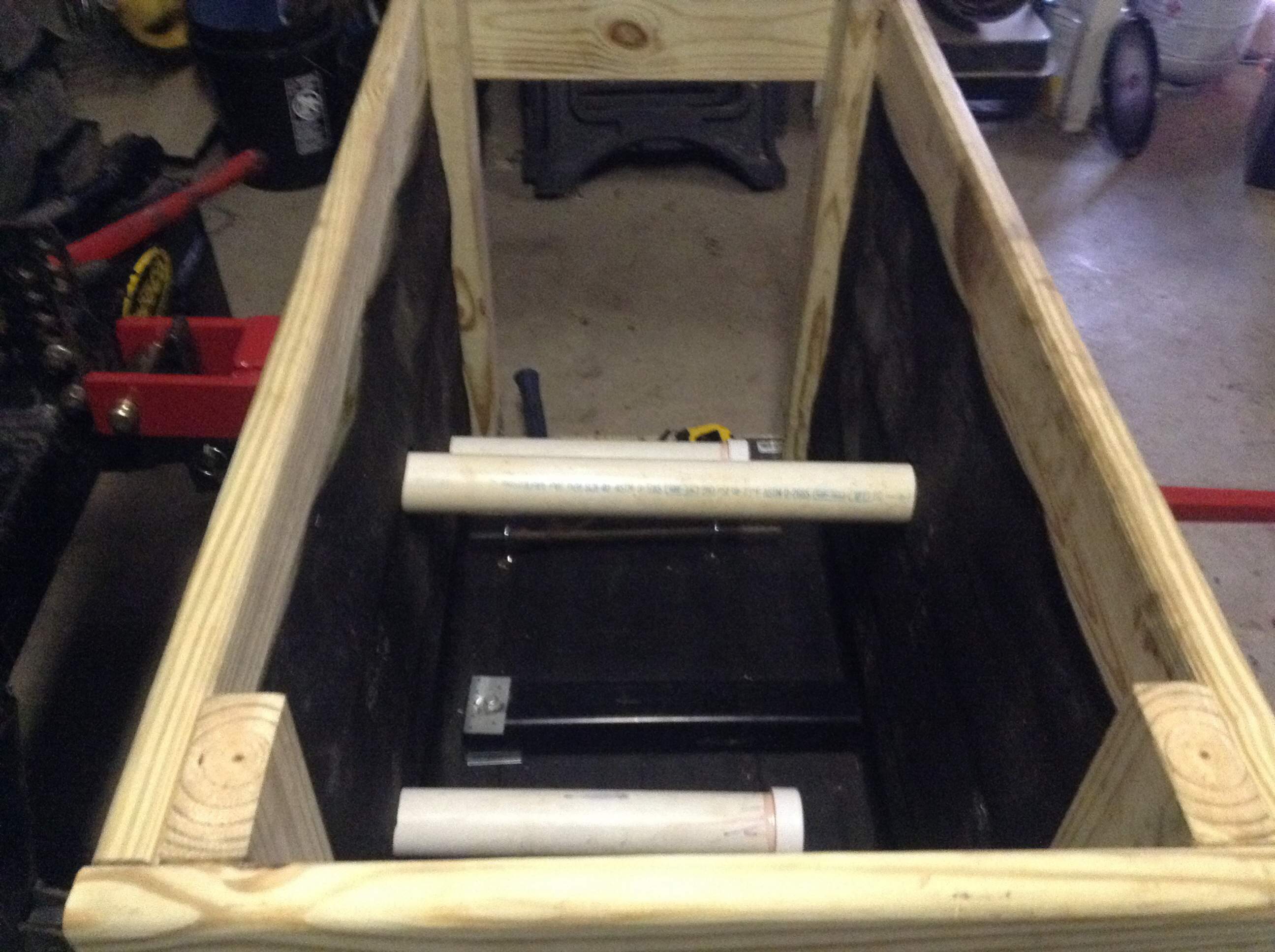

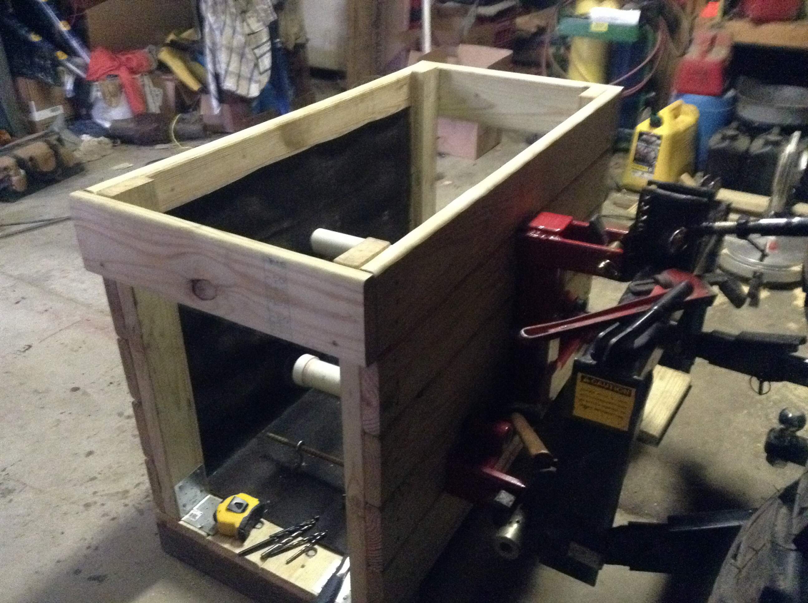

I am in the middle of building one with a 3pt bale spear ( Titan - $169. ). The spears will slide into PVC pipe so the spears can be pulled out if need be. I will be cutting the center spear off and putting a hitch pin thru it to keep block from sliding off. The concrete level will be down 5" from the top so I'll have a storage area. I will be leaving the wood attached. The inside dimensions of the concrete block are 20.5" W x 44" L x 22.5" H (approx 1600#)
View attachment 367041. View attachment 367042. View attachment 367043
View attachment 367044. View attachment 367045
NICE!!! Very NICE!!! Your weight is carried a little farther back off the 3 point, so you will get a little more leverage out if it. Should perform well!

Just remember them little spikes don't hold weight very well . The break and bend easy .
Sent from my iPhone 5 using TractorByNet
   / Ballast box--how big? #35
Usually rated for a 2klb round bale, but good point to check.

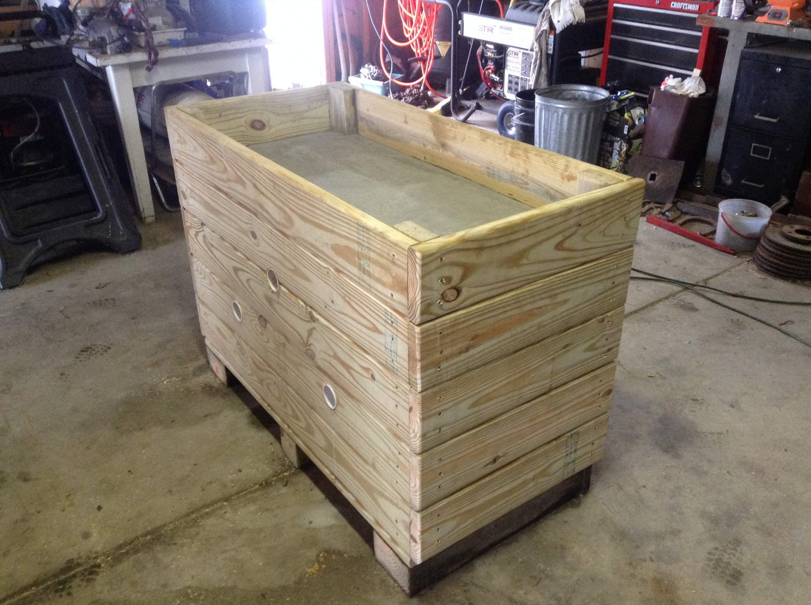

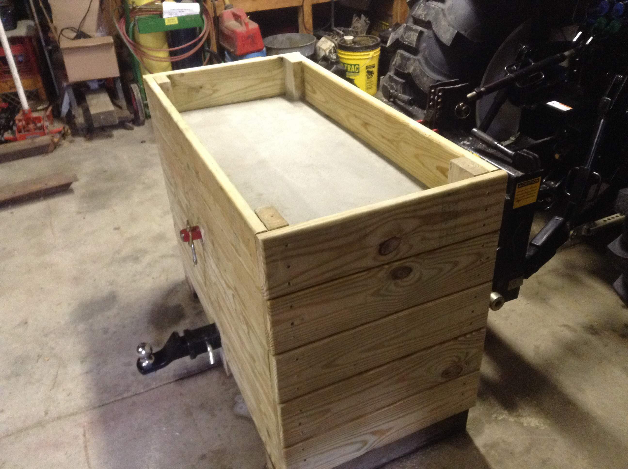

Finished my ballast box today: concrete weight is 1600# the wood box is approx. 200#. The total should be real close to 1800#.
