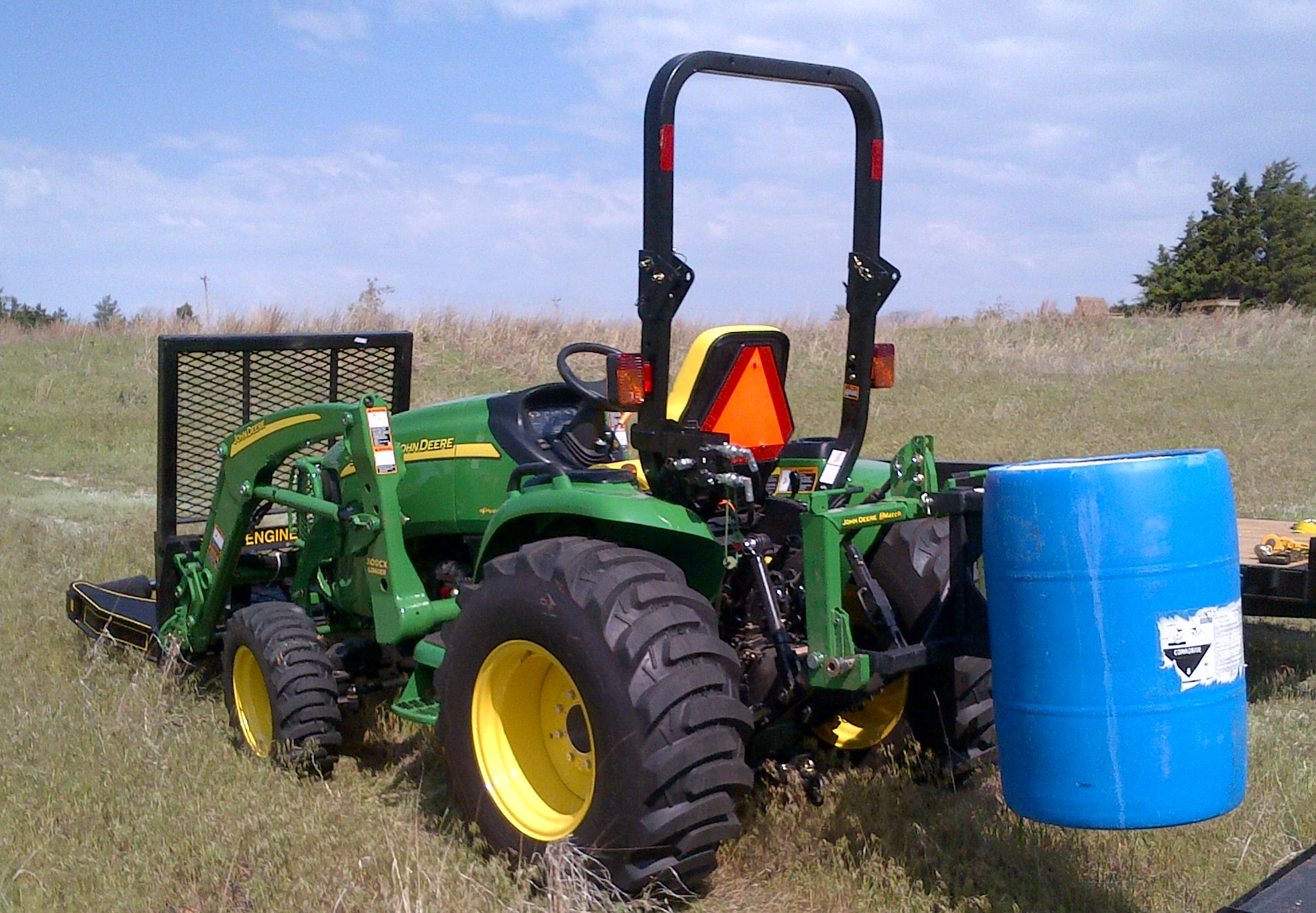

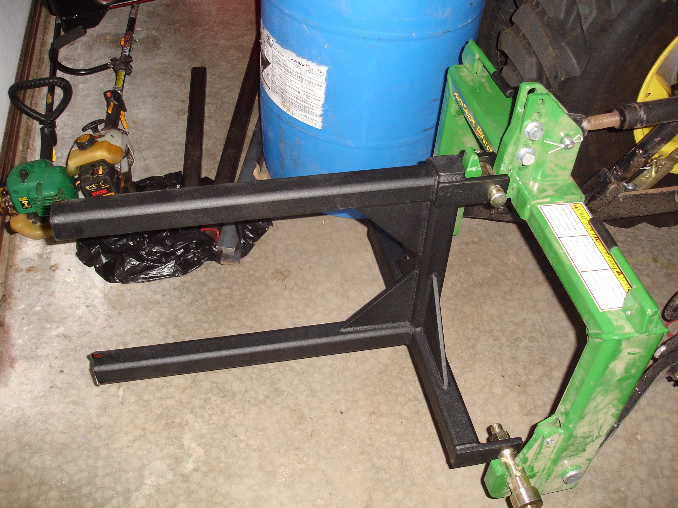

That's my tree shear on the FEL, an M&M.
I put 975 pounds of concrete into it. I brought all the bags home in the bed of the truck, put the mixer on the tailgate and mixed/poured directly into it. That's 2X2 steel and 1/4 inch thickness.

THANKS for the pics, Dan! But I have a dumb question - is the steel not permanently attached to the to drum? That's pretty cool!
