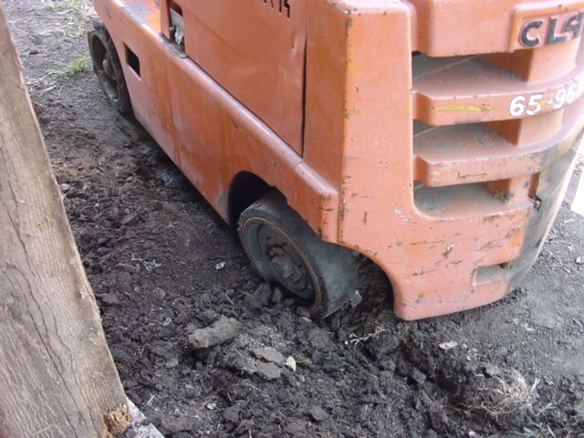

</font><font color="blue" class="small">( Went back and tried again, soil on this side was remarkably easy to drill. The fence posts I had set before were quite alot more work as I hit wet clay about a foot down and it just gummed up the bit and sent it into an out of balance frenzy. Sank it to the cover, bit is 3 1/2 Ft long. )</font>

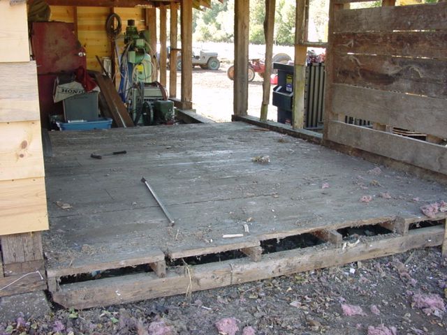

I am getting to the point where I have to deal with the floor, so that meant clearing all my stuff out of the barnshop. That meant creating some kind of temporary shelter. I had 2 10x20 shelters that I had been using before but had trouble keeping on the ground due to winds. I found some 8' galvinized poles and drove them in to the ground and bolted the awnings to them. Then I cleared the barnshop out....
This is a kind of overall progress shot, one of the shelters is hidden behind the structure. I placed them close to access my tools and compressor.
