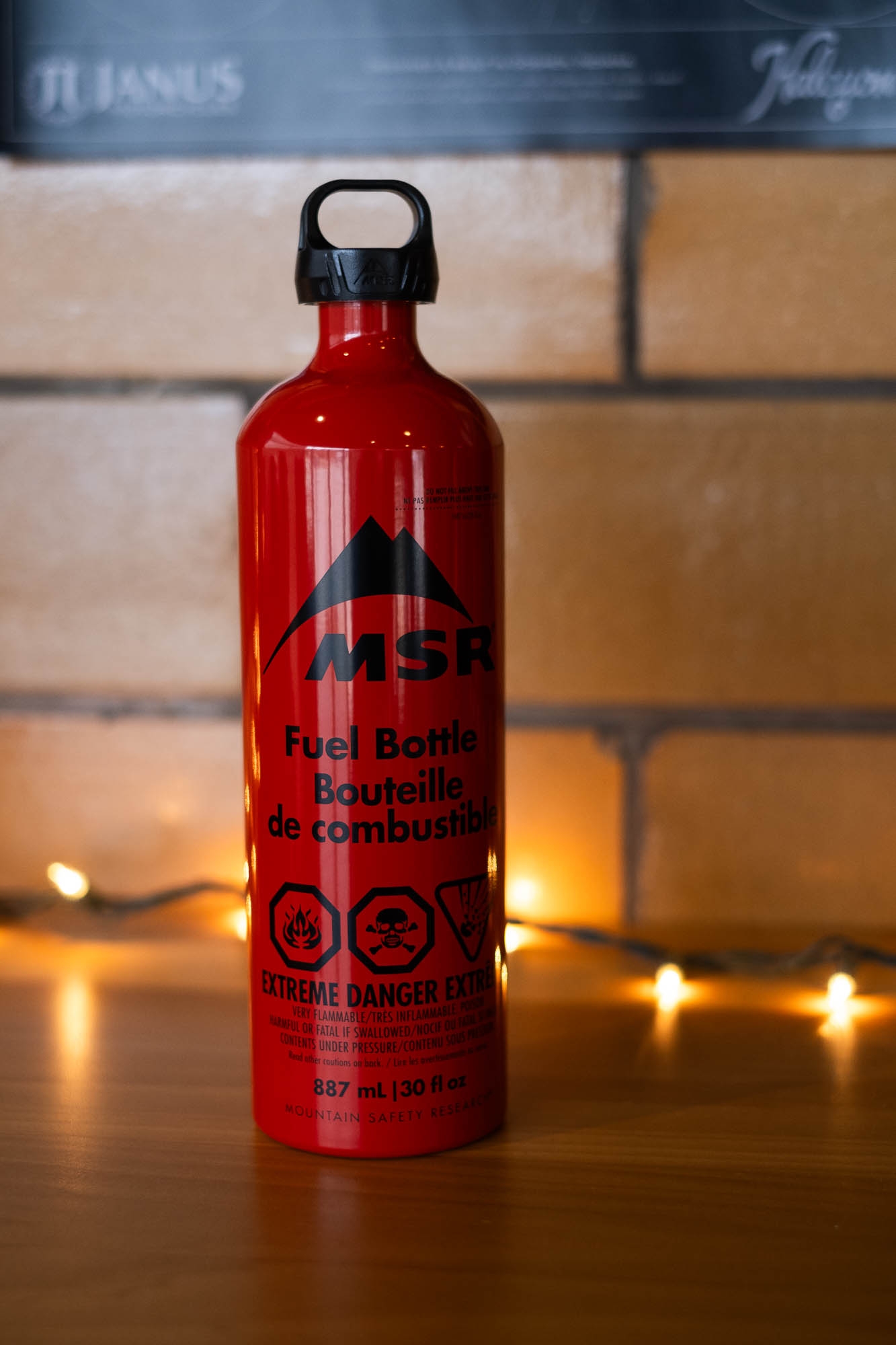

I don't think comparing battery weight to gas weight means anything. An electric saw without the battery is lighter than a gas saw with an empty tank.
It matters when you consider refuel weight and bulk. How much liquid fuel do you need to cut 3 hours?
How many 4 pound batteries do you need?
My battery saw weighs more with 30 minutes of runtime (battery installed) then my gas Echo full of fuel.

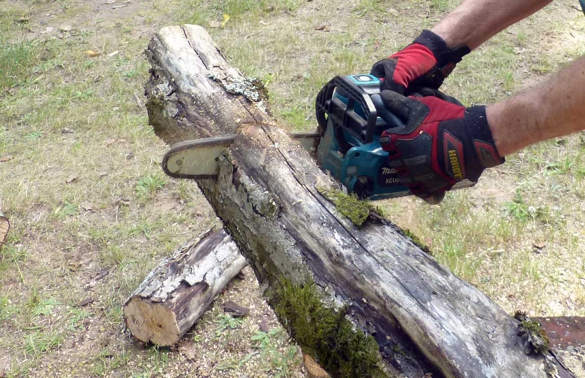

Except that an empty gas tank or without a battery is not how you use the saw. I own 1 battery chainsaw and 3 gas saws.
My Milwaukee electric saw is about the equivalent of a 40cc gas saw. Its spec. weight is 13.9 lbs without the battery. The 12 AH, high output battery weighs 3.4 lbs. That's 17.3 lbs total without bar oil. (It's not clear if the Milwaukee weight spec is for PHO or includes the bar and chain. I'll assume they are included.)
My smallest gas saw is my old 50cc Jonsered 2152. weighs 11 lbs (powerhead only). A full tank of fuel (16.9 fluid ounces) weighs 0.8 lbs. The 16" bar & chain adds about 1.0 lbs. This gives a total weight without bar oil of 12.8 lbs.
The Jonsered 2152 will cut rings around the Milwaukee M18, will run much longer without refueling/recharging, and weighs 4.5 lbs less.
I use different saws for different applications. There are times I prefer the Milwaukee M18. It's great when noise is an issue (when I don't want to disturb the neighbors, or when cleaning up the outdoor classroom area behind the local elementary school). It can be more convenient when I'm just cleaning up, making a few cuts around the yard or when taking a quick spin to clean up minor blockages on our trails.
I don't even consider the battery saw when doing even a half day (let alone a full day) of tree felling or storm damage cleanup out in the woods.
Why is the minor weight difference an issue? I often carry a second battery in my pocket, but wouldn't consider carrying a container of gas that way.
I spend more to buy pro-level saws to save a pound or so (in addition to the better long-term reliability and repairability). 4.5 pounds is a big difference when using a saw all day. My battery saw weighs about what a 90cc gas saw weighs. Maybe I would have considered it a form of weight training when I was 20-something. These days, weight training is not on my mind when working in the woods.

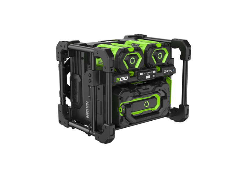

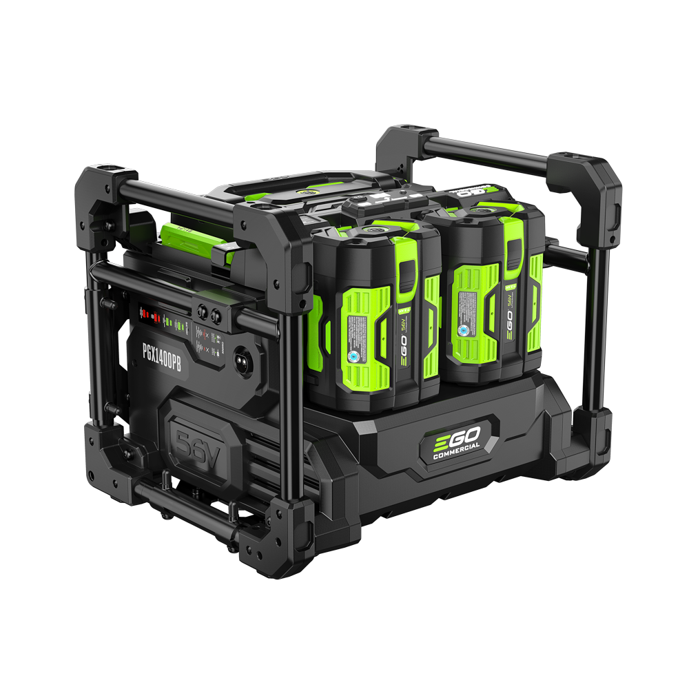

EGO is coming up with a unique remote charging system:
It isn't going to be particularly cheap, but it would allow recharging tools on the road. Although, for that price, perhaps one is better just getting a pile of batteries.
Greenworks is putting big "suitcase batteries" in their mowers. But, I don't see a remote charging solution yet. Undoubtedly it is coming.
They do have inverters.
