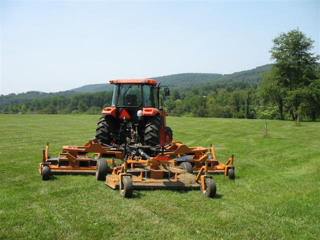

You can run it with one remote just fine. Raising the batwing during operation can damage the drive shafts. Having three remotes allows you to operate each wing separately and can speed things up when just have to lift one wing for clearance around a tree for instance
/ Batwing with a single remote? #23
Flex wing finish mowers are a different animal. Most come standard with all 3 deck lifts plumbed in parallel operating off one single acting circuit. Batwing rotary cutters, not so much.
/ Batwing with a single remote? #24
It is not clear what you are thinking when you say "one remote just fine". Surely, you are not activating all 3 cylinders concurrently.
I'm not sure where you get your information regarding damage when raising anything. I have owned 2 and can attest that there is no damage, and I have done lots of it for various reasons.

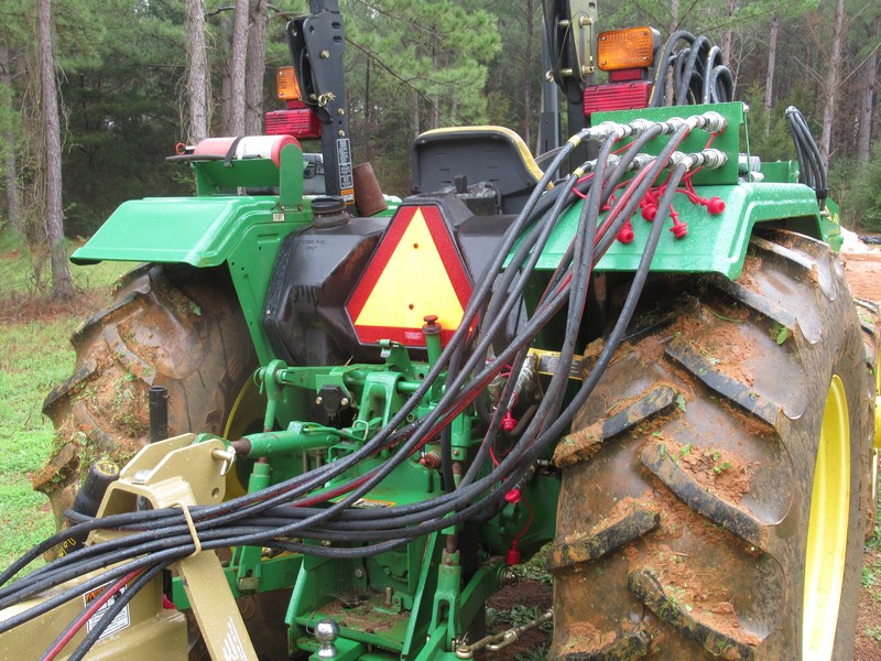

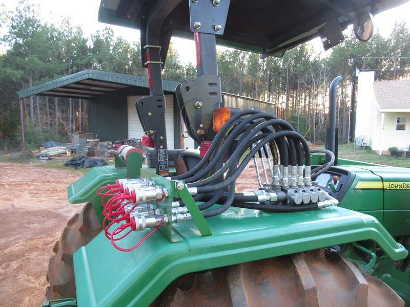

I see some people arent understanding the differences in design between a flexwing finish mower and a batwing brushcutter. most flexwing mowers use a single hydraulic line plumbed to all the decks and require all decks to be down to use. they have a set cut height that cant be changed while in use. batwing brush cutters require more functions. If a finish mower would suit your purposes, then you're all set and you could just find a flex wing. If not, its really not that difficult to add a valve stack with as many remotes as you want. Ive put together remotes for 2 tractors for like 1/3 of the cost of one bought from the dealership.

Hey now, I like that layout. Do I see that right - 5 SVC plus the loader joystick? I've been wanting to add rear remotes to my Kubota ROPS. However, if you follow his link, you should see that the OP is considering a 2WD Cab tractor. Kinda hard to get all of the output hoses from inside the cab to the outside - not an impossible task, but complicated.

I have a Progressive TD65 16 foot finish mower. It has one pair of lines to work all three double acting cylinders to fold the side decks and raise the rear deck. I do have 3 remotes, but it only uses one. And yes, it would be a costly mistake to fold it up while the pto shaft was still turning.
