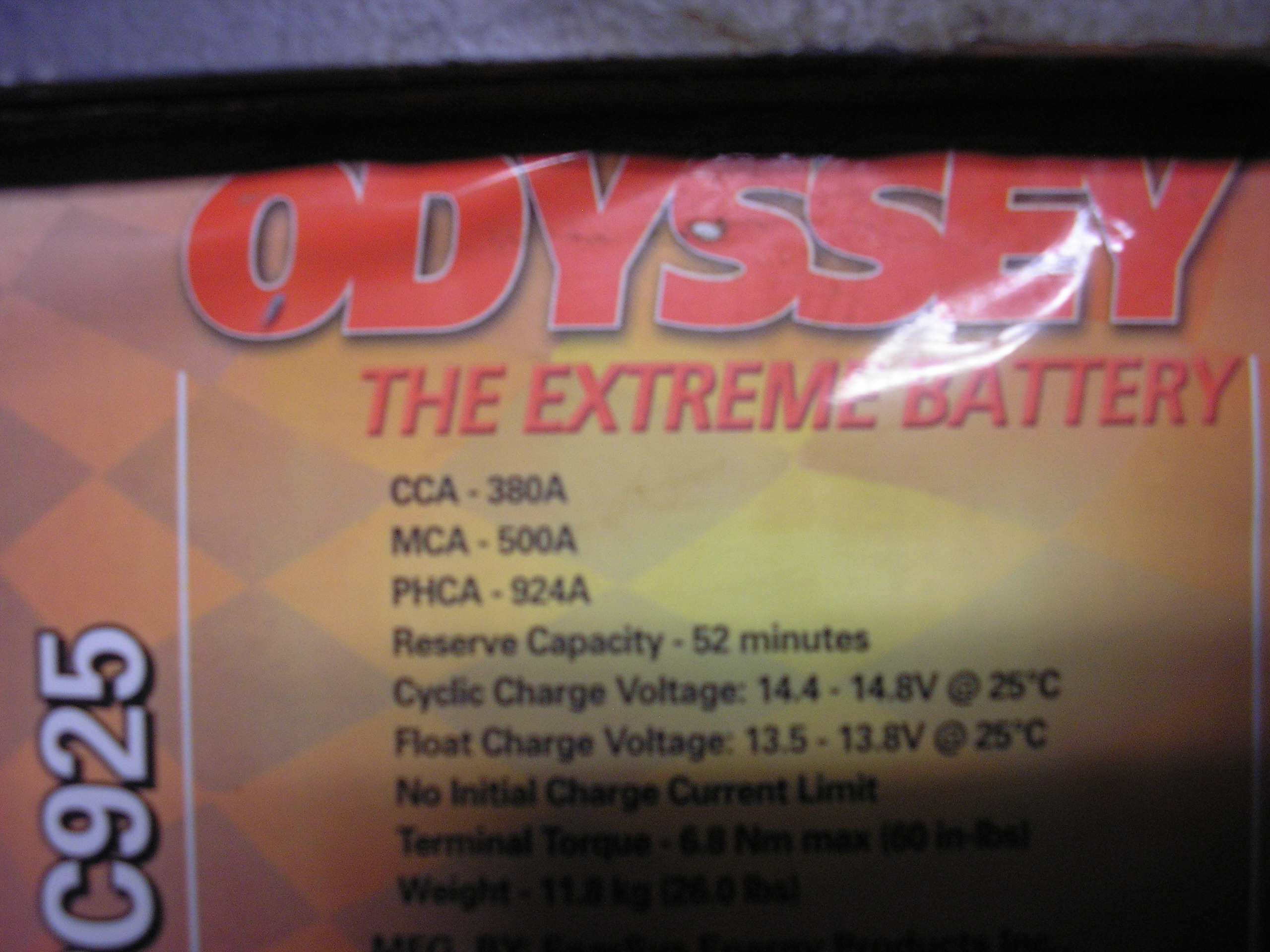

Thanks for the thread links. I'm leaning towards an AGM battery like the Odyssey.
The PC925L will fit (as LarryD has proven). My concern is the CCA rating. There seems to be some discrepancy in the rating for the Odyssey PC925. Most vendors on Amazon state it as 380 CCA (though the label on the battery in their pictures says 330). The Odyssey site says 330 CCA, so I'm inclined to believe the 330 number.
The stock New Holland battery in my tractor is 420CCA.
I might gamble 380, but I'm concerned that 330CCA is too low for the cold winters here, especially as the battery ages. The Optima D51 size battery might fit, and has 450CCA. I've got to do some more accurate measuring to make sure.
   / Best Tractor Battery / charging system issues ? #26
Your comment prompted me to go look at my battery. As you can see, it states 380CCA. I wonder if there has been a change to the manufacturing process or just a downgrade in the advertised specs. :confused:
I did mount mine on it's back as that was the only way to clear the hood latch. It moved the terminals away from the radiator as well which made me more comfortable when blowing out the radiator with a long metal air nozzle. I suppose any "reversed" terminal battery would put the connection up front.
420CCA is the rating in the manual but I live in a temperate climate anything below 20º is rare. We did get a pretty good winter storm in '12 that remained in the mid 20's for about 10 days, had to move snow a couple times and the battery worked just fine.
   / Best Tractor Battery / charging system issues ? #27
420CCA is the rating in the manual but I live in a temperate climate anything below 20コ is rare. We did get a pretty good winter storm in '12 that remained in the mid 20's for about 10 days, had to move snow a couple times and the battery worked just fine.
I wouldn't worry about an Odyssey and cold temps. They actually work better at low temps than standard wet cell types. They don't tout the CCA so much unless you do a bit of digging but they also rate theirs in 5 sec pulse current, it's part of the model number, They list short circuit current too which is useless info. It's enough to know that if I drop a wrench across my battery terminals it will likely vaporize. I have two PCL1200s in my truck so that's over 5000 short circuit amps available. You do not want to short and spark jumper leads together alike a lot of folks do with these types of batteries. The internal resistance is much less than a wet cell battery.
