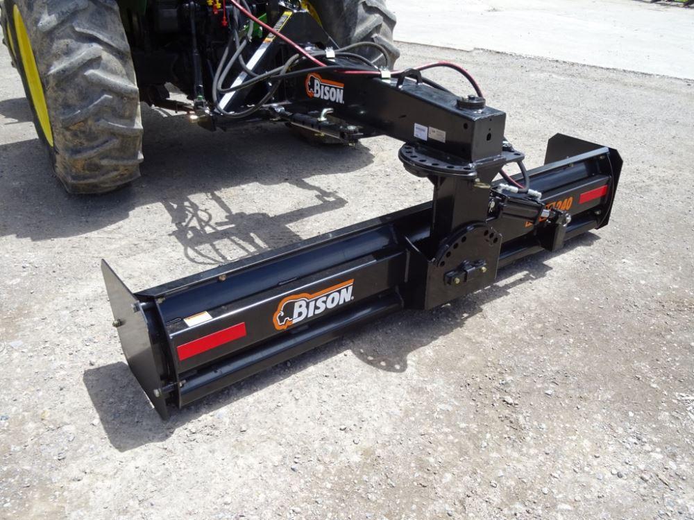

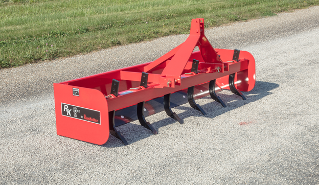

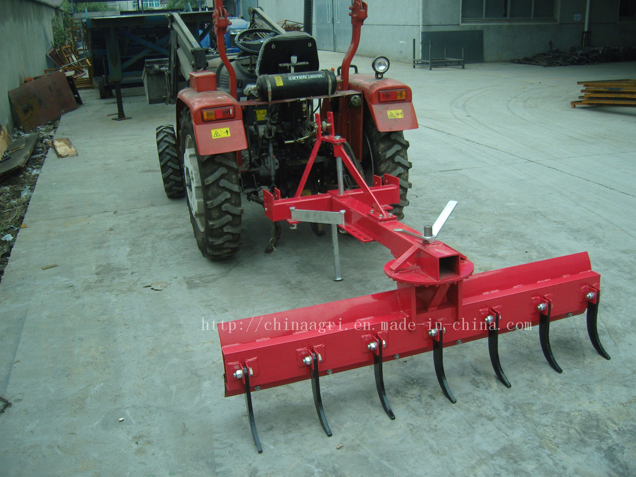

Don't fight gravity. Move dirt sideways or down.
Put side plates on your rear blade, or buy a box blade. Scarifiers on either may be a big help.

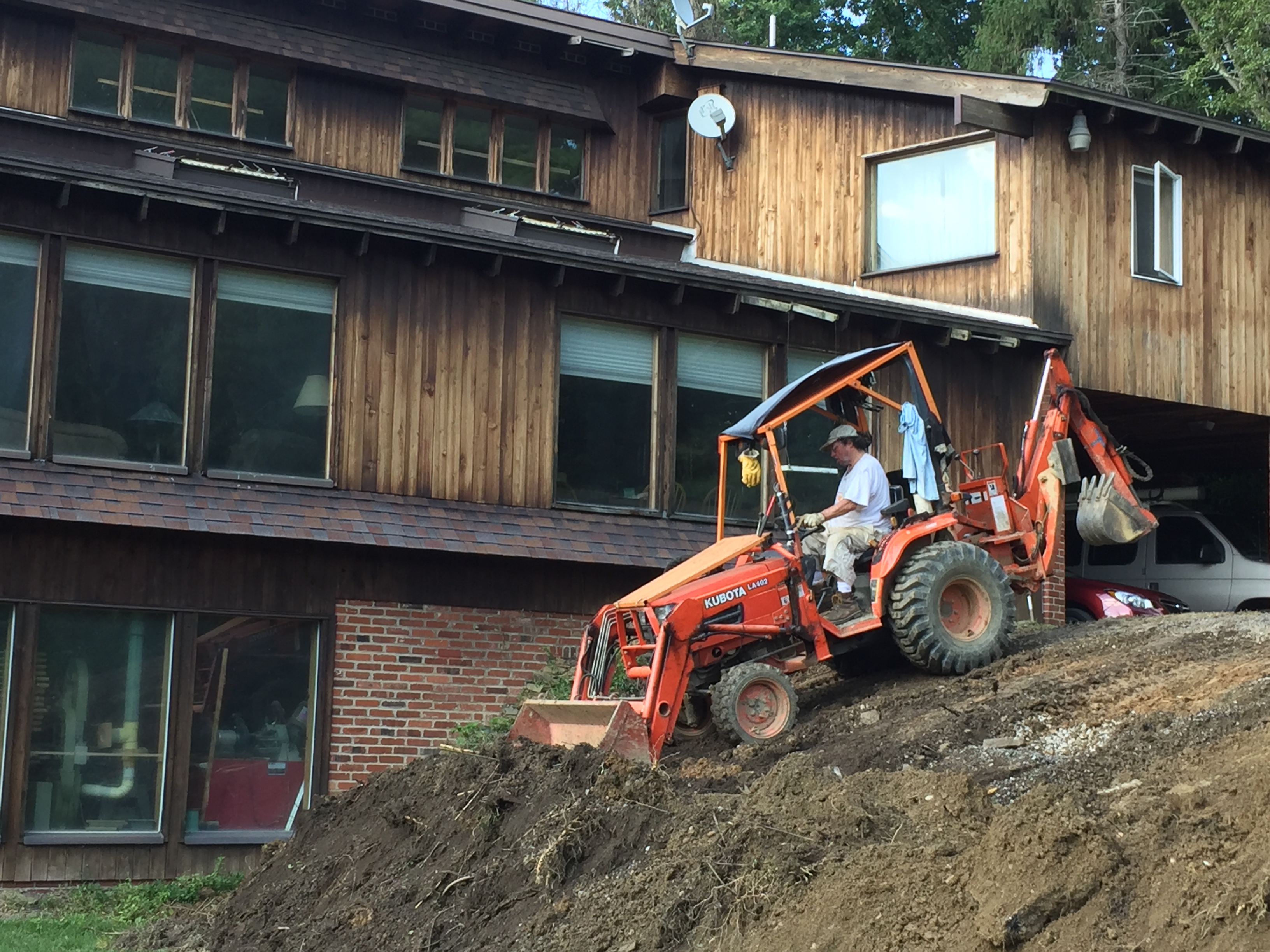

As stated above, take material off the top and use it to fill in the bottom.
I recently did this on a bank at my place in front of the house. About 80 or 90 feet long. But not as high as yours. But the technique is the same.
Work your way down gradually. Take a cut on the top and push it down a bit, then take another cut and push it down, using what is in the bucket to push the previous material further down. Do this gradually and the slope can be changed relatively safely.
Also, you really need a good tooth bar on your loader when you are doing this work.
Action shot:
PS - remove all the top soil first if possible. Use it to cover the final surface so you can get something to grow. Box blade works good for this if the tractor can handle the current slope.
