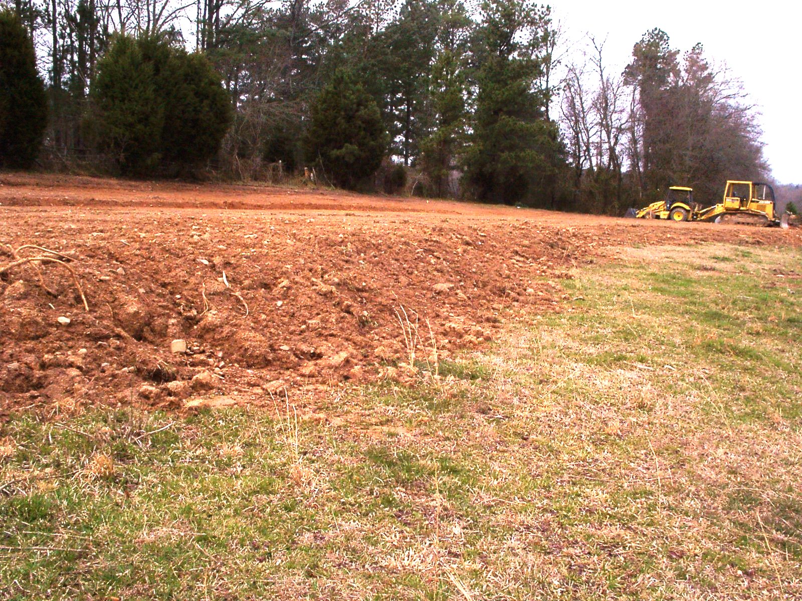

You can do it yourself with a box blade using the scarifiers to loosen the soil and the FEL to pick it up on the next pass. It does take a lot of finesse to control the box blade and use the FEL at the same time, but you can move quite a bit of soil at one time that way if yoursite prep.jpgIMG_0836.JPG tractor has the power and traction to load the FEL while deeply scarifying the soil AND dragging a load of dirt at the same time.
Dont forget that you need to compact the relocated soil as you dig out the top.
I used the above method to dig out a hill and level the are where my shop is located. I had to move about 3 feet off the top and put it toward the bottom of the hill. I just eyeballed the level but when the builder took out his transit to check it, it was within 2" of level all around for the slab which was good for him to work.
I did hire a dozer to level off the area for the house (see photo of house area and shop) which was about 300 feet in length in total plus about 100 feet wide.
