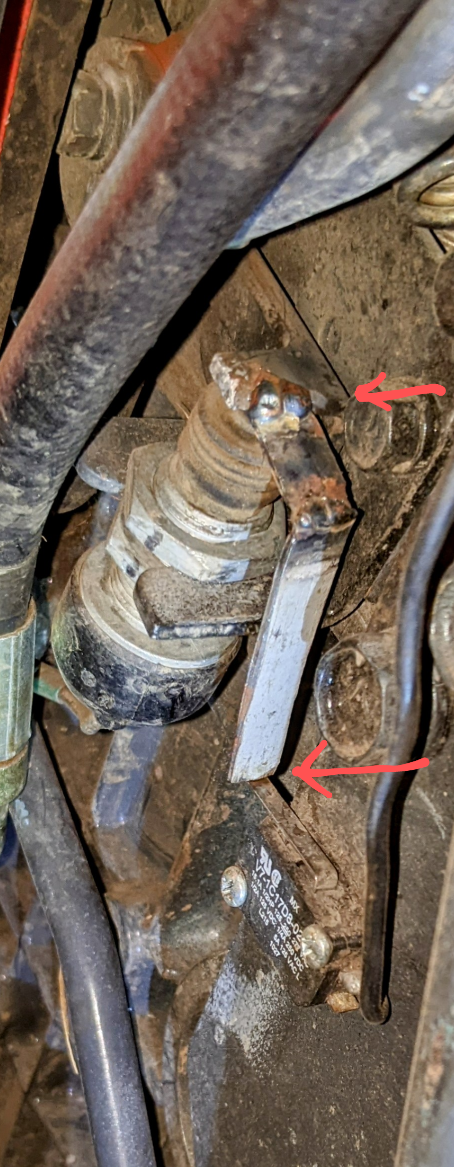

I had the same problem with my 2005 Kubota B3030 HST so I put a switch on the brake pedal assembly and a light on the top of the dash but that still escaped my attention.
So, I added a single high tone car horn along with a second switch (in series) on the HST linkage. Now when the brake warning light is ON and I apply the HST pedal the horn sounds, scares the crap out of me and I release the brake, every time!
My HST has a complicated linkage under the floor and one of those little levers moves in only one direction regardless of pedal movement for forward or reverse. That's the one I used to activate the micro switch.
I used micro switches with the thin blade attached that presses on the tiny button. This made switch location and movement range easy to set up.

/ Better parking brake warning needed. #77
Took these shots lying under the tractor tonight :oops:
The one with the arrows shows the extension I welded to the one of the pedal levers and the point of contact with the switch lever.
Two holes were drilled and tapped into the frame for the machine screws to hold the switch.
The other photo shows the tab welded to the brake lever so it will actuate the switch lever.
Two holes drilled through the floor tab to mount the brake switch.
You might be asking yourself what happened to the pedal end of the foot brake lever 🤔.
Well, it's been moved over to the left side of the tractor to make more room around the GO-pedal on the right side. The second brake pedal has gone AWOL and the independent L & R braking welded together. In 18 years I have never had need to make a brake U-turn (nor have I tried) and those two brake pedals hovering over the GO-pedal were a PITA 🙄.

That is a proper fix. I salute your tenacity in making that work. Modifying these little tractors for personal use can be great fun and a reward with each use. Thanks for sharing.
