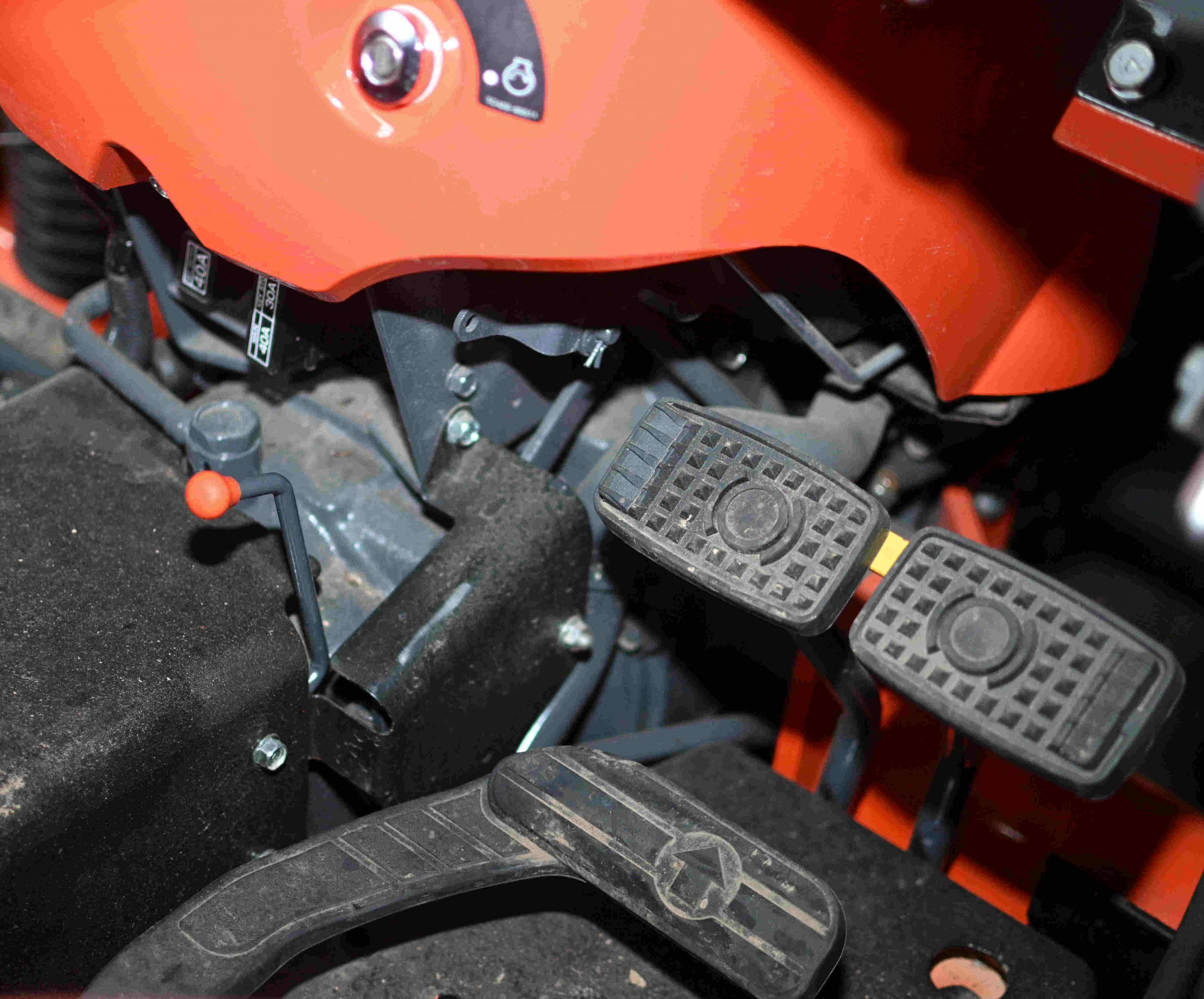

Disappointed. I got the motorcycle brake switch linked in this thread and took a look at where I might best anchor and connect it. Well crap!. Nowhere I see. The complete throw of the linkage is about 1/4 inch. It does not look like a promising mod on the MX5200.
   / Better parking brake warning needed. #51
I received the motorcycle switch as well. The actual travel of the brake assembly when viewed from underneath the tractor is a fairly short throw. I think it would be possible to make the switch work under the tractor, but I decided to order another switch to mount on the top of the brake lever housing.
I also thought that I could just turn on the hazard flashers when I use the brake.

That's the same as for the hand brake on our 2007 vintage M59. Last summer I decided to take a look at the hand brake system to see if there was some problem. Why was the hand brake so hard to pull but did so little? And could I mount a solenoid for electric control?
I disconnected one cable end to see if the cable was bound up - it wasn't. Then with camera, mirror, and calipers I looked at the mechanicial advantage. Basically there isn't much. Not nearly enough. Nothing was wrong, juat overly complex yet inadequate.
After looking at the photos for awhile I gradually came to realize that what I was looking at was an afterthought - almost certainly added sometime after the basic tractor was designed. Whatever box it checked wasn't one concerned with function.
All in all, the hand brake is more of a curiosity than a concern. If I want this tractor to stay put, I just put the bucket edge down firmly.
The travel is short and always connected to the brake lever by an extension spring so that the brakes light will turn on even when the brake lever throw is adjusted for very little free play...but not pull the switch apart when adjusted for longer throw. Usually the spring comes with the switch.Screenshot 2023-02-10 at 11.32.53 AM.png
