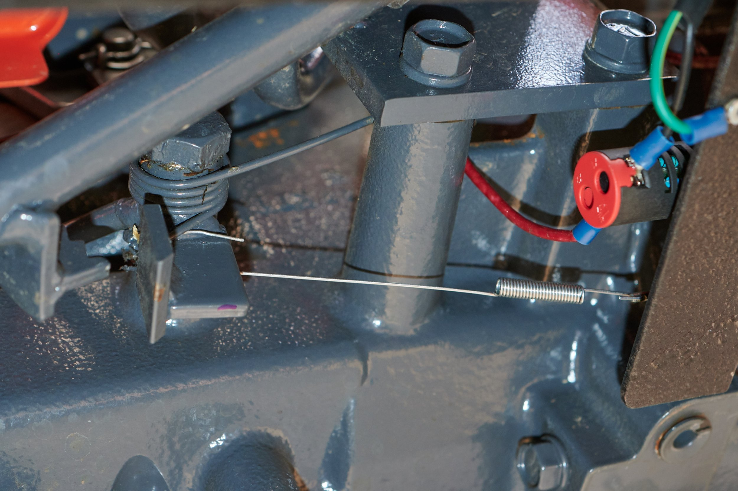

A better parking brake warning is needed. The MX52 will walk away with the parking brakes on without braking a sweat. :oops: :(:cautious: Happened twice now...
I'm thinking about adding a big flashing light. The tiny indicator in the cluster is nearly useless.

Thanks to ruffdog for posting the motorcycle brake switch and thanks to Fuddyduddy1952 for posting the light/beeper, I now have a warning on my L2501 HST parking brake.
After looking at some other options, the motorcycle brake switch has enough adjustment to activate the switch when the parking brake is engaged. There isn't much travel on the parking brake lock itself under the tractor compared to the range of motion for the parking brake arm itself. The motorcycle brake switch works fine for this application.
I opted to put the light/beeper under the tractor on a bracket I fabricated rather than drill a hole in the dash. I also figured that if the beep was pesky enough, I'd rather have it under the tractor anyway. It doesn't seem overly loud, however. It is an intermittent beep so it should get my attention when I set my parking brake.

I thought about a buzzer but I usually set the brake to exit the tractor and connect a 3pt or grab the phone off the bench or such and a buzzer would be super annoying - But it may be needed if I get any more forgetful... Me driving along thinking hmm? Wonder what that noise is? :LOL: :D:p;)
I had a chance to use the brake/light warning today. The buzzer is loud enough to hear on the operators station while the tractor is running, but isn't bothersome when I get off the tractor even though I mounted it under my L2501. The warning light is big enough that between the light and the buzzer, it would be hard to ignore if you mount it where the light would be visible.
The only downside I see is it takes a pretty good sized bit to drill the hole for it. Not sure that I'd want to leave it in the rain, either.
I bought one of those too to evaluate. Cute light buzzer combo. Worried about durability in an open station tractor with rain and dust especially facing up. Fortunately the dash cover had a perfect spot for LED sealed marker light. Prefer a hole saw for thin metal or plastic. Rubber grommet make easy attachment and nothing to loosen from vibration or impact. Much brighter than any dash light. Obnoxiously bright.
Motorcycle switch has proved to be reliable and durable. Has required no adjustment or maintenance since installed.
