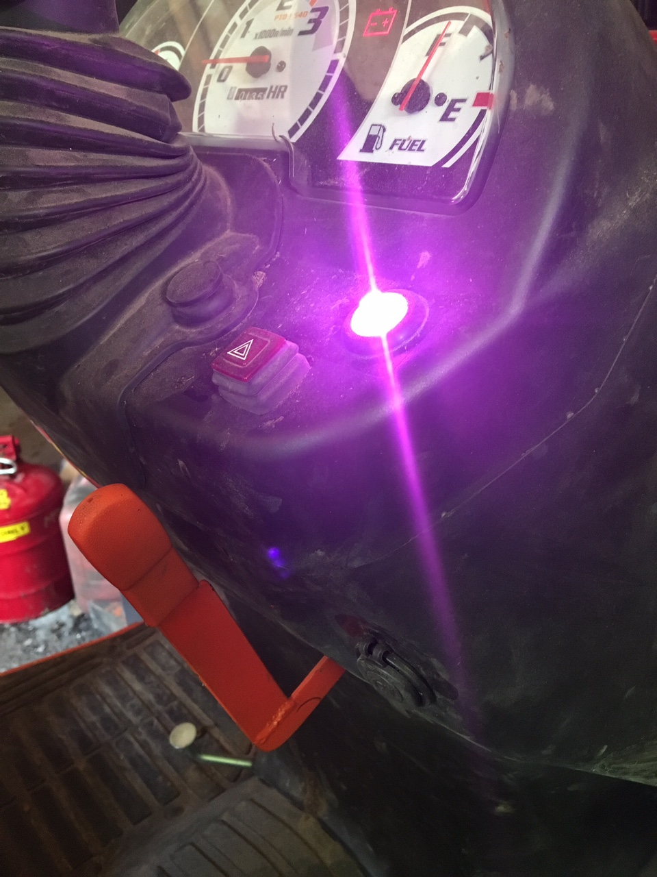

Good posts! I'm ordering the motorcycle brake light switch from Amazon $6 and change. I'll make an extension like Smokey did. I remember seeing that inspiration before. It's hard to press down and touch your toes Kubota :LOL:
Got mine from Digikey. I suppose any petal switch will work however.

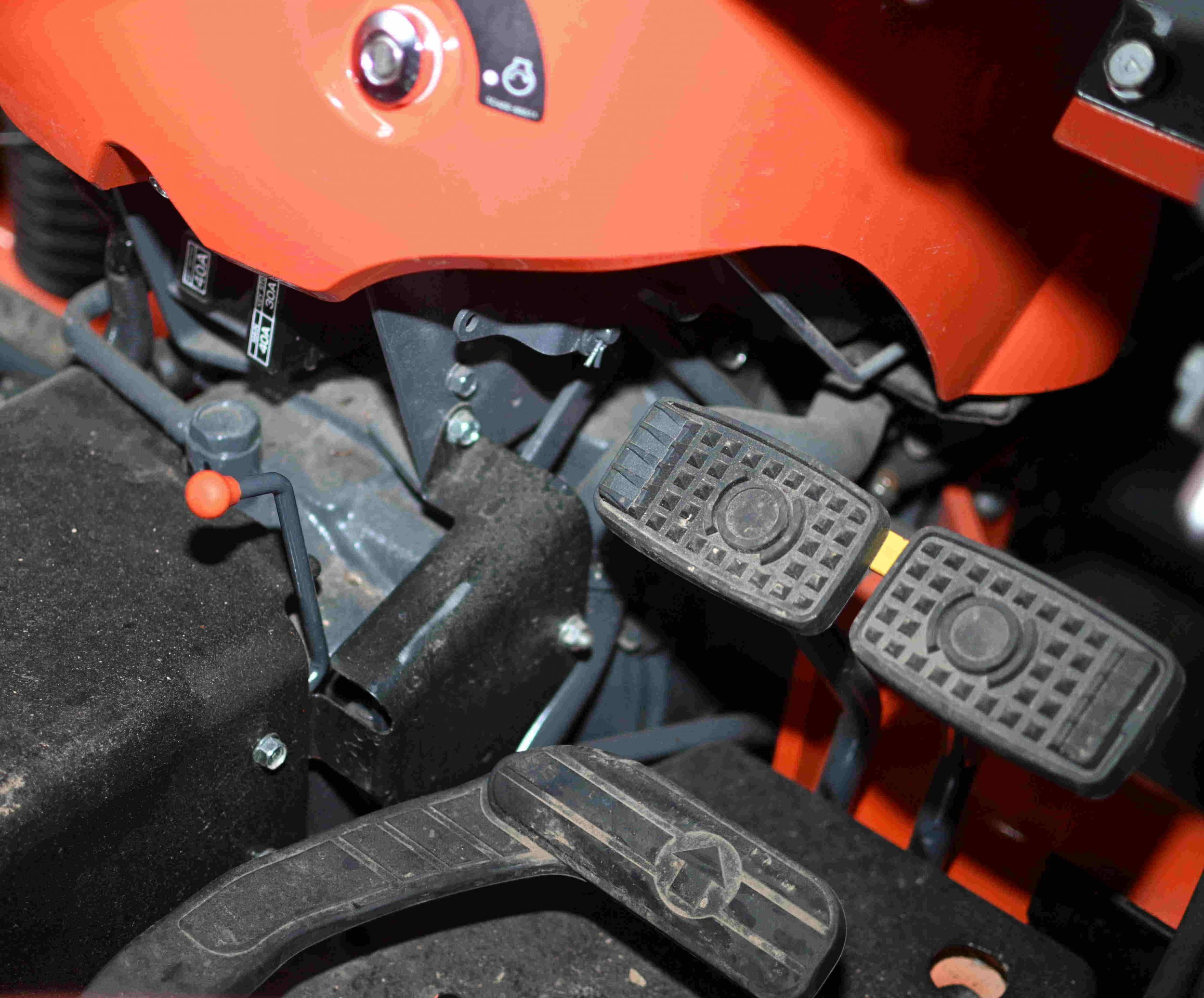

The the parking brake on my L2501 is this small lever that has to be pushed forward to engage. When pushed forward, the little red knob on it is completely blocked from my view. So I keep forgetting it is on. But I have just ordered the switch linked by ruffdog and a warning light to install.
Would like to see the bottom part of the lever Smokeydog made for his B26. I'd rather have a more accessible brake lever than the one that came from the factory.

The parking brake linkage on the B26 is different from your photo. I simply had to add a piece of flatbar at right angle to the OEM short handle. Not having to bend over to engage while pressing the brake so much easier. Can feel the notches of the ratchet paw easier and set the brake firmer. Better of two modification. Both improve multiple user operation.
There might be a way to bring your lever up and function better.
Lowering the FEL, 3pt, turning wheels and setting parking brake all important on our hillside farm.

I always lower implements before getting off the tractor. I only need to set the parking brake when there's a tendency to roll. This particular parking brake doesn't seem to set as hard as the brakes on my other tractors. It's been bugging me since day one so this thread was timely in inspiring me to add a brake light indicator.

Got my footswitch from amazon yesterday...
