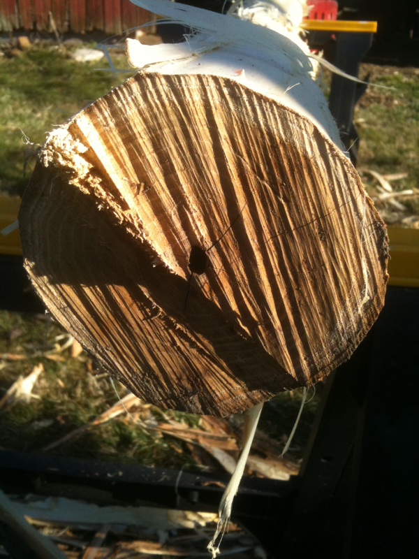

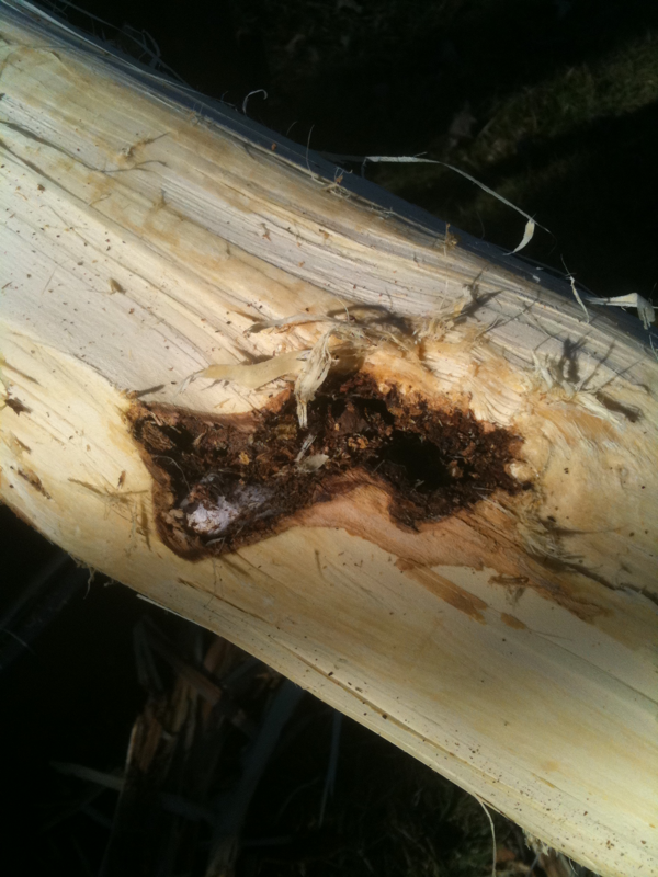

Dad used peeled locust post for years, never did really last long considering the time required to build all that fence. I suggest, bit the bullet and buy round pressure treated post and be done with it.
mark
If you want to re-do a fence in a couple years, just use pressure treated pine. Set properly, black locust posts will outlast most of us.
   / Black Locust fence posts #12
   / Black Locust fence posts #13
I'd cut them to length, stack em and let them sit a few years before "planting" them. Stick them in the ground too soon and they may grow on ya! I cut some black locust logs that had been sitting in a pile with other species for 7 years. The poplar was powder, the maple was punky, the oak was salvagable but the Locust was as sound as ever and actually had a green color. Burns really hot too.
   / Black Locust fence posts #14
Care to explain what you mean by "set properly"?
Ken
I mean the back filled soil being tamped as tight as possible. A loose fitting/wobbly post is going to have water collecting around it every times it rains, and therefore it won't last nearly as long as it should.
#15
I've heard lots of important keys are ...key in solid, life-long locust post's.
1) Season you cut the tree down (dormant cold season)
2) Curing time allowed for posts (1-3 yrs best)
3) plenty of gravel allowing for drainage in posthole along with the native dirt tightly packed.
Now for my endeavor I'm only planning on curing the logs for about ten or eleven months, since I'm planning on getting some dairy goats next year,summer/fall.
   / Black Locust fence posts #16
You’ll be fine. I think the main reason for allowing them to sure, at least to me, is to get most of the shrink out of them. 10-11 months is plenty. By then the bark will be easy take off as well, and it does have to come off. The gravel isn’t mandatory, and I’d be shocked if many posts that were set 50 years ago had gravel under them. I know this is the first year I’ve ever used gravel (for a different reason) and most posts are still good. I know there are posts on the farm that were set over 50 years ago, though most are under 30.
#17
MMagis, Thank you very much! hearing that, makes sense. After all is said and done, It will be a learning experience either way I slice it. I appreciate your time! I'm 41 years old, and just getting started with my little one acre "farm". With hopes to someday have a full fledged farm that I can pass down to my kids, and their kids. God willing! :)
   / Black Locust fence posts #18
cut them in the winter when the saps down is more important than anything else.
   / Black Locust fence posts #19
While seasoning, I would keep them off that damp spring Ohio ground. Maybe cross stack them across some scrub trees. They will cure much faster like firewood. Good Luck!
Gary
#20
Yes indeed, I was planing on stacking them in the cover of the barn, with spacers, and leaving the two (opposing) doors open for good air-flow, until mid to late summer 2012. Thanks!
