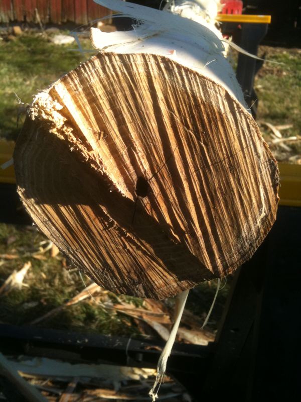

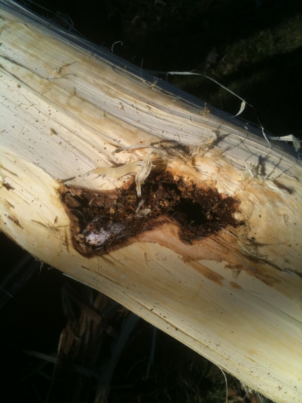

Just noticed a couple of interesting things with a post while de-barking. Any thoughts about what looks like insect holes or maybe rot at one spot? I was thinking about filling the little hole on the top with something like wood putty, or the like.. But then again black locust = rot resistance.

I can't tell for sure, but it looks to me like that is an old branch that died and the tree grew over it.
Remember, it is ONLY the heartwood that is insect and rot resistance, not the sapwood. That's true for all the "rot resistant" species (oak, cedar, b. locust, etc.)
No, I don't think wood putty would be a good idea.
