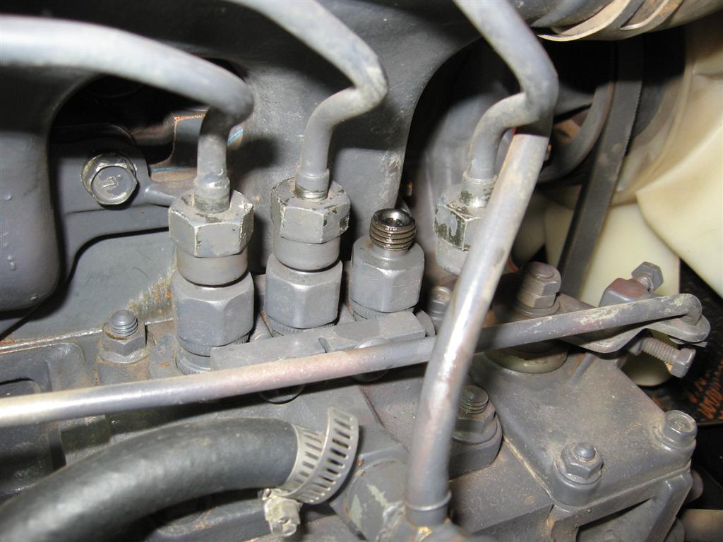

If you have a drop in bosch in-line style like this there are only a few parts. Rollers, seals and the high pressure plunger and barrel. Personally I would have seeked out a local pump repair shop first. Sometimes you never know what you get, and if there is no problem, you are only out $50 for a check up!
The pump is a bosch. But, my diesel mechanic friend came over last night to see what adapters, etc. he'd need in order to do the compression test and pump pressure test. We ran the tractor through some of its paces and his diagnosis was that if the pump is bad, there's definately something else.
What led him to this was that when he sprayed ether into the air intake with it cranking there was no pop or sputter or anything. I'm going to check some other things with it now...Valve clearances, etc. I don't know where I'm at with it now. I may end up with a nice new injector pump that I don't need.
