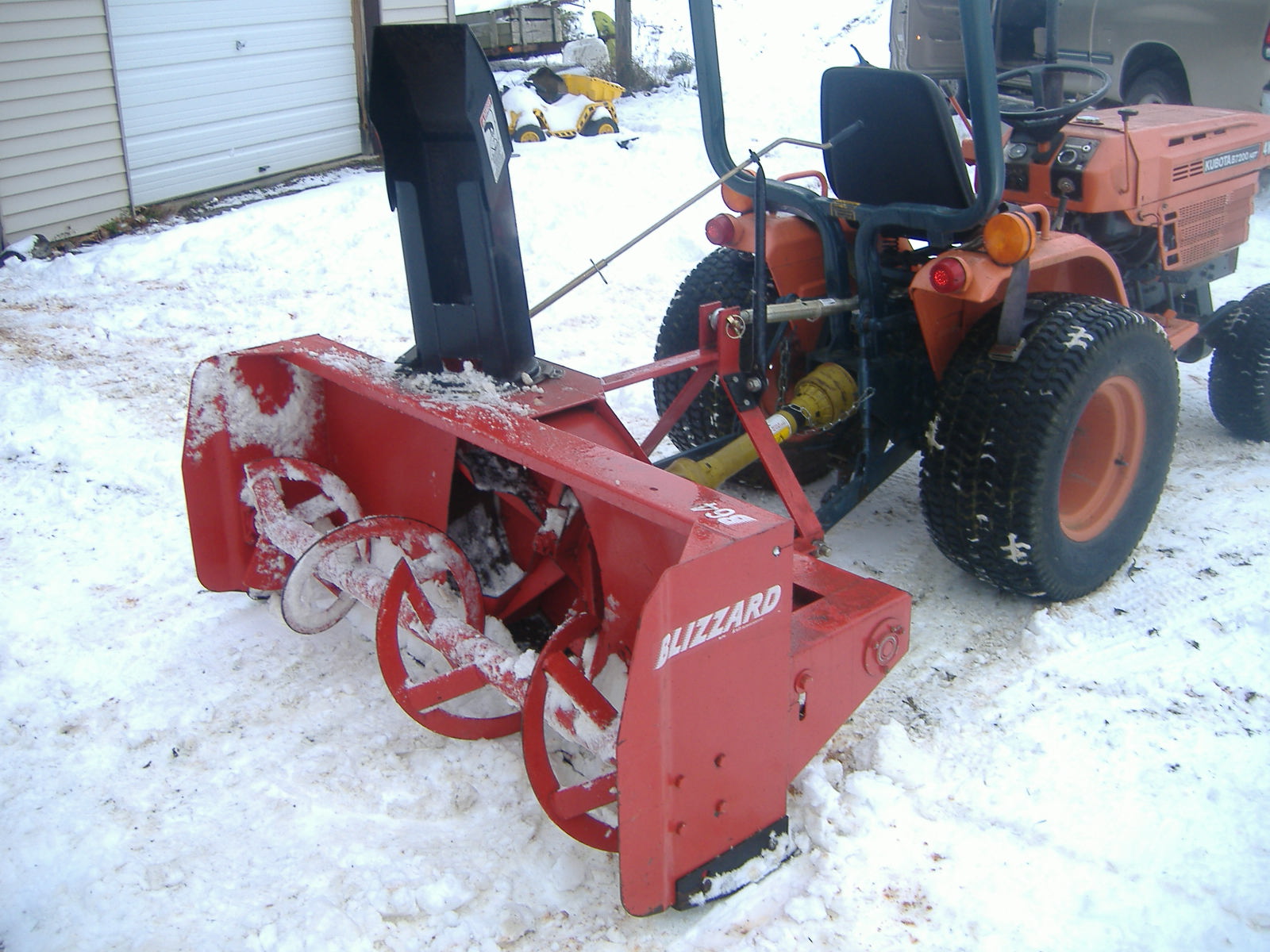

Hey Folks, new here.
I have a Kubota B7200 4wd tractor with 18HP / 12HP rear (Live) PTO.
I just purchased a Blizzard 64" snowblower that was only used twice, so I thought I was getting a good deal. It was used on a slightly larger tractor, but with a bucket .
I hooked it up yesterday, and it's apparent that this thing it just too big / heavy duty for my tractor. If I try and go forward, I spin (turf tires), and if I lift the blower up, the front tires come off the ground nearly, so I can't steer.
Is this a job for chains and front weights, or should I seek out a smaller blower? The second question is if it's the latter, anyone looking for a nice blower???
Thanks for any help. Winters Here!

I do not have a snowblower--so only opinions here! The weight may not be as much of an issue as the PTO HP required. The blizzard site says it weighs around 480 lbs but requires 20-35 PTO HP. How did it spin when you cranked it up? I would think some weights on front would help--it seems that most folks who have blowers do not need chains as the blowers clear their path for them.

Yes, it's too big for your tractor.
About 30" too big.

My understanding of Live means that PTO keeps running with clutch in. http://www.tractorsmart.com/main/Tractor Power Take Off Types.htm . From your description it seems this is a gear tractor as opposed to HST. This may be a problem as may not be able to go slow enough with high engine speed to move snow - with HST if blower load too much can slow down but maintain full RPM's.
That's a steep grade. Chains for sure. Does tractor lift blower weight ok?
   / Blower too big??? #13
Is your tractor manual, or HST ? This will make a difference.
First things first........ add some weight. At least a few hundred pounds on the front. If that doesn't allow you to get going, get some tire chains.
Yes...... that blower is much too big for your tractor. You should run one just slightly wider than the width of your rear tires..... maybe 48".
BUT..... once you are able to get the tractor moving (with weight / chains), you may be able to get away with running that blower if your tractor is hydrostatic. At least until you can sell it and buy an appropriately sized blower. Since, with hydrostatic drive, your ground speed is infinite...... you may be able to get by, creeping very slowly so you are not trying to blow more snow than you have the HP for. If your tractor is gear driven, sell the blower now. You'll never be happy trying to run it on the tractor you have (since you could never go slow enough to feed the blower slow enough).

My first tractor was a B6200 4wd gear tractor, bought it used and it came with a 50" Farm King blower. Most of the time it handled the blower well enough, also had FEL so that helped with the front weight. With your blower you definitely need a bunch of front weight added. You might be able to adjust the blower so it is closer to the tractor, even a couple of inches will make a difference. If yours is a gear tractor you will have trouble taking the first cut in heavy snow, once you have the first cut you can just take a narrower cut to match the amount of snow to your ground speed and tractor power. Only happened to me once but with a very heavy snow I had to make my first pass carrying the blower about 6" off the ground. Once I had it cut down that far i was able to set the blower back down, finish clearing that cut then take narrow cuts. If HST you will do okay with it but still need a bunch of front weight.
If the grade is too much for the tractor to blow snow going uphill you may have to drive up carrying the blower then blow snow going downhill. I usually blow snow in 2WD so that if I catch the blower on something the tractor will lose traction before hurting anything. Works most of the time.:rolleyes:

You have a tractor that is at the very bottom of the pto hp scale, and if it has been used, may not even be putting out the 12 full hp that is advertised.
The minimum pto hp for the blower you have, is roughly twice what you have, making it about 30 inches too big.
There is more involved than length.
Yes, you could possibly run a blower as big as 48" with that tractor.
But to work well, that would be a lightweight blower, that is especially made, and geared, for a low pto hp tractor.
And also, "running it" is subject to interpretation. What some consider as acceptable, others may not.
