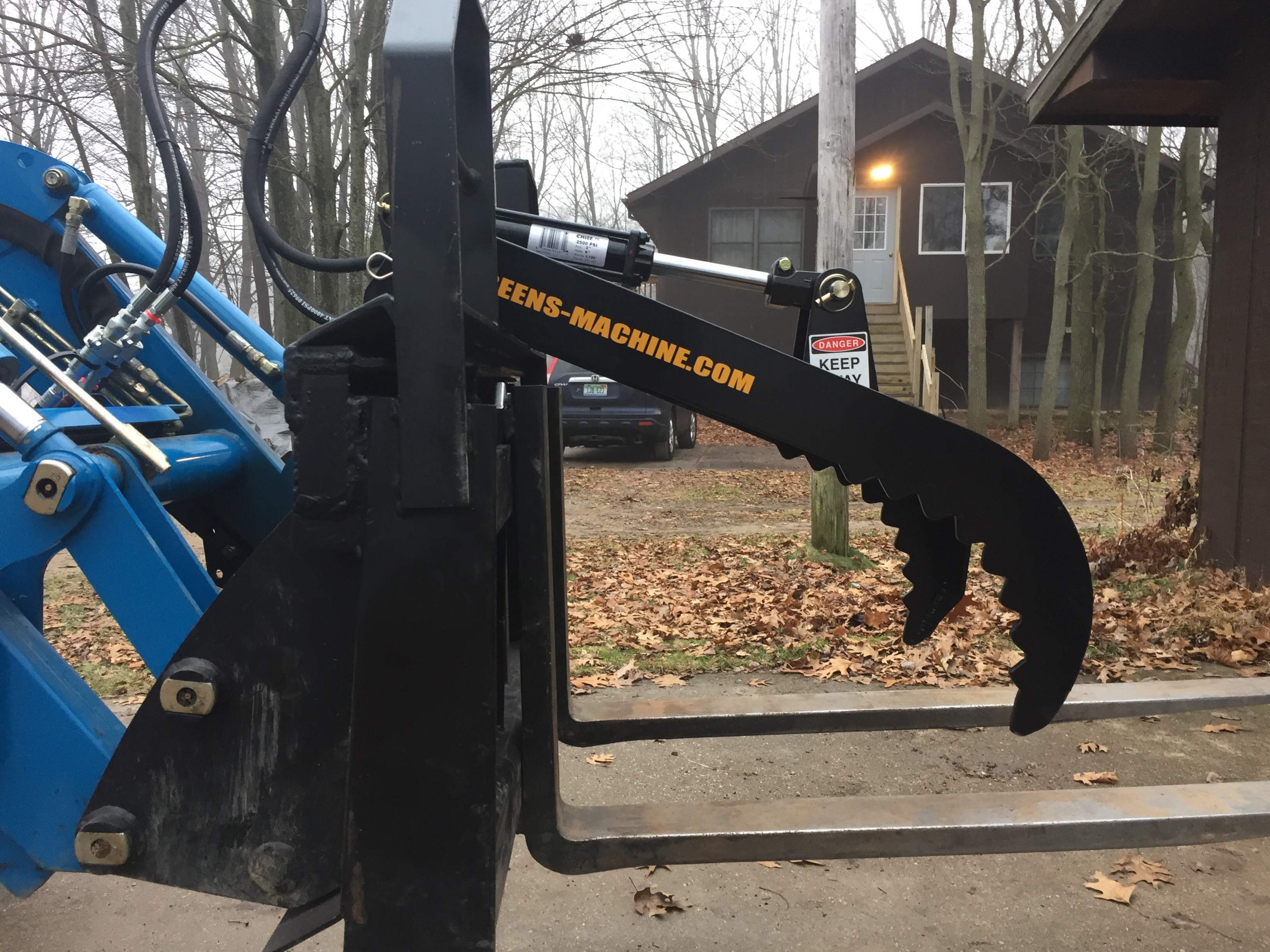

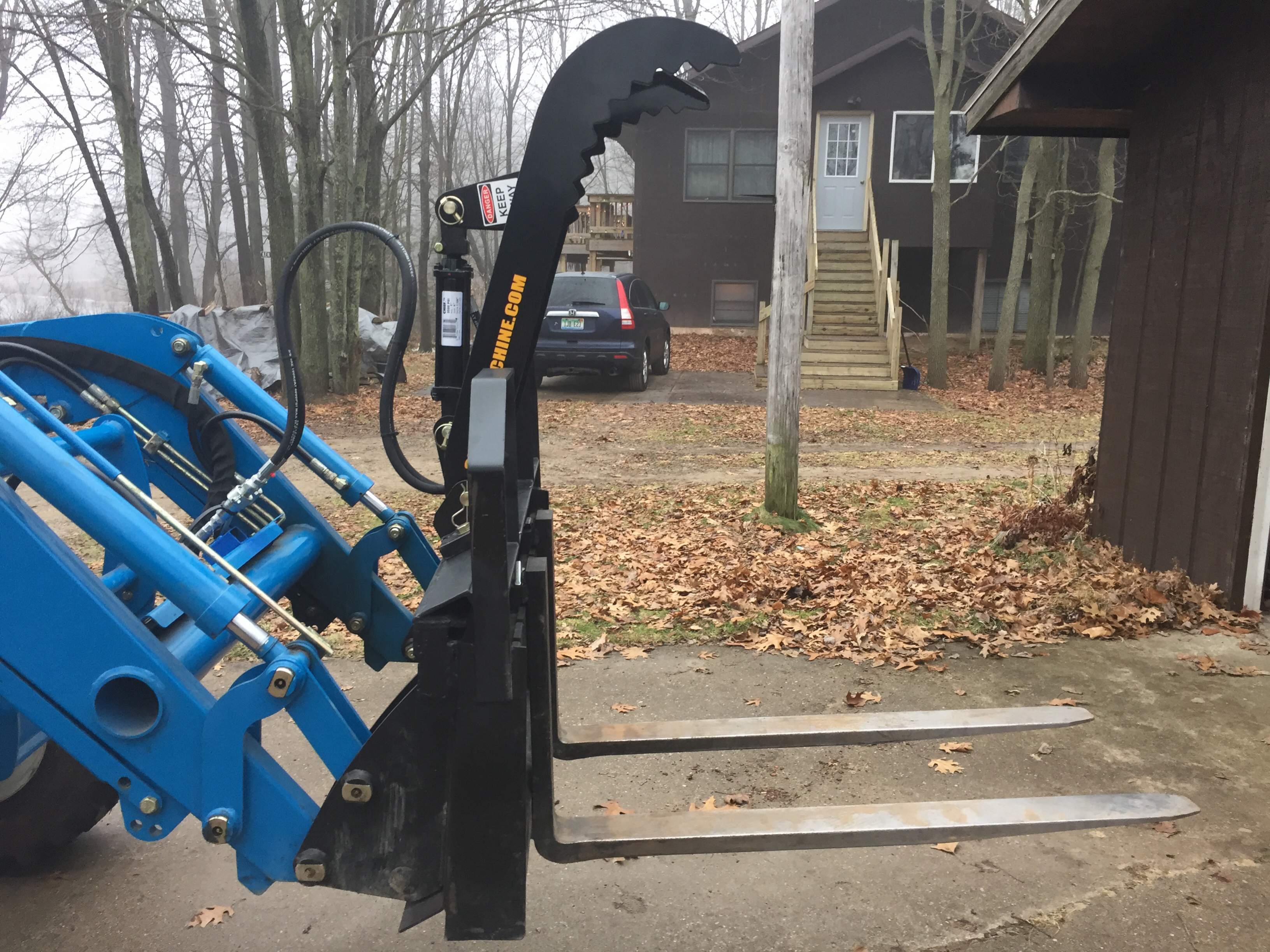

I just finished installing a Thumb on my forks;
/ Bolt on grapple #22
Underdog, I have a question for you. Where you mounted the base plate would it work out better for you if you moved it to the top horizontal piece? That way you would have a better extended length and the grapple would reach lower, also it wouldn't hit the frame of the forks. Just a thought, no criticism intended. Stanley
/ Bolt on grapple #24
None taken :).

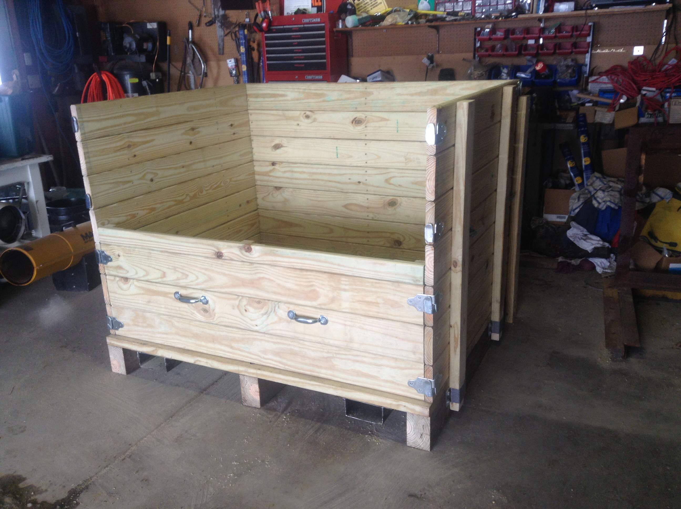

My main concern was where the thumb was in the verticle position, I have a box/carryall/work platform that I use a lot, it is about 44" tall. I also like to push on trees with my fork frame, in fact I use the forks for practically everything I do and didn't want the thumbt to get in the way.
image.jpg. And I wanted it to be up and out of the way. I figure I can always get some 3/8" steel and weld an extension on it if I really think I need it. In fact I'm already thinking about welding a second extension "tong" on the end of it! ;)
