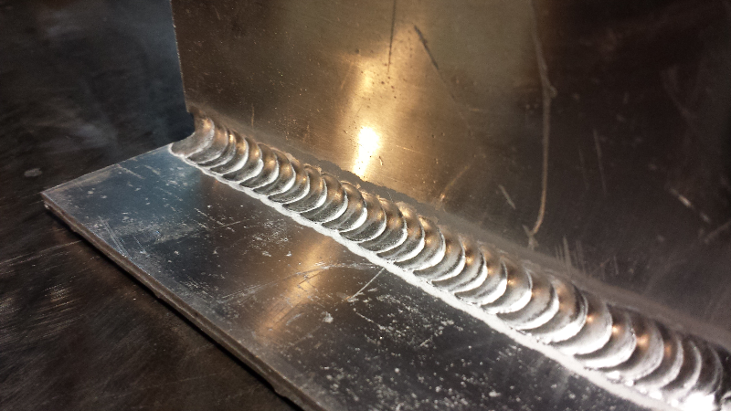

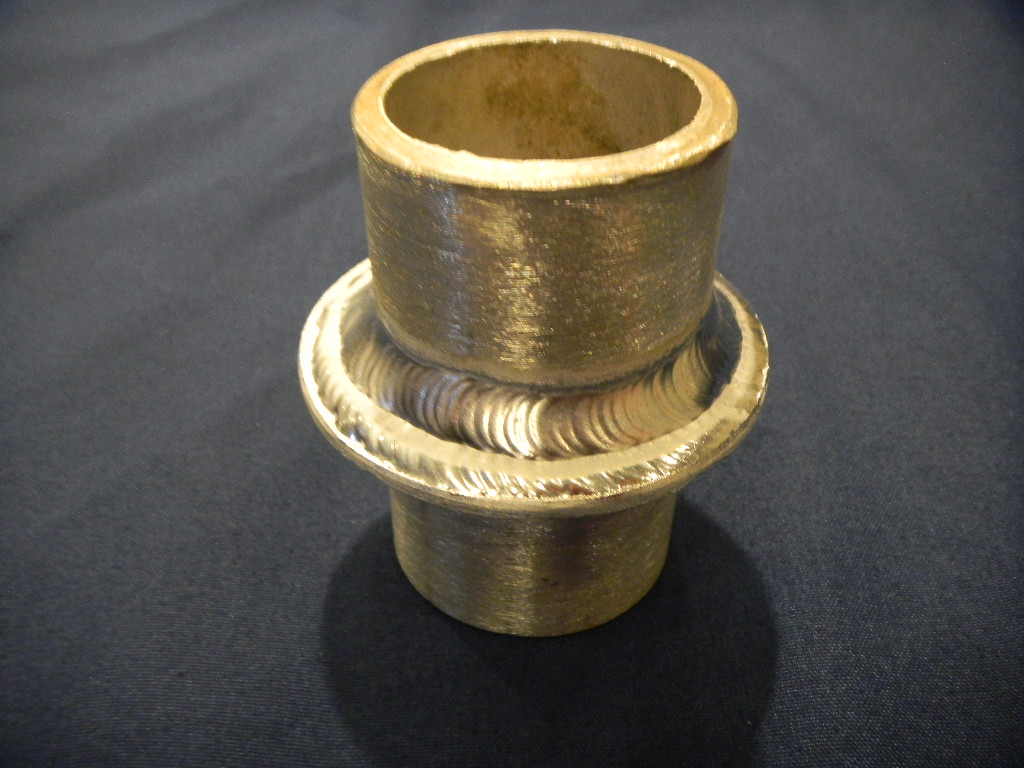

I try not to take a wire brush to aluminum anymore, unless its complete crud or something of that nature.
All the aluminum I have, has been outside for 30 + years. :eek:
/ Bought a Miller Multimatic 200 #43
I try not to take a wire brush to aluminum anymore, unless its complete crud or something of that nature. I wipe it with acetone, crank up the amps to blast away the oxide layer and then back off a bit and get at it quick. Quick feed while watching everything going on and giddy up and go.
That is sure purty! and showing off too! :laughing: I hope someday I can post a pic like that.

Mike,
Any possibility of a new thread and maybe a you tube vid on your technique for that weld?

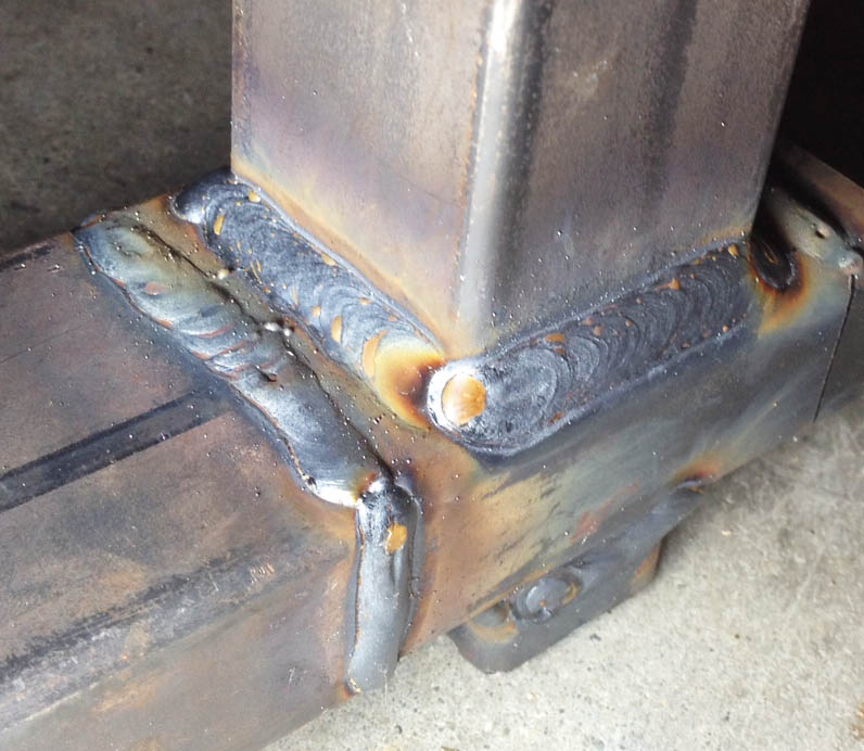

Here's the first few welds with the new MultiMatic 200.
I've never had a welder where you could set the voltage and wire speed so precisely. I'm going to like this machine.
Mig using .030 wire and 75/25 gas on .065" thick steel. Ended up using 16.5v and 150WFS of the fillet welds.

Hey looks good to me... especially pretty much right out of the box. I want one. I know I am no help to your quest but it seems the MM 200 found a home? Well done.

Mike,
Sent from my iPhone 5s 64Gb using TractorByNet
Thanks bud, I dont know how to make you tube vids but in the future I can get more involved with explaining things clearly. It really comes down to hood time and being able to multitask, meaning going off feeling while your scanning everything thats going on. Hard to explain what is going on while using a foot, both hands, and scanning bead width, spacing, feeding, torch movement and feathering the pedal as your base metal gets hotter and all at a rapid rate. Welding is one of those things that really needs tons of time to become second nature. And even then its frustrating LOL. Dedication always wins in the long run. If its in your blood, good enough sucks. To a point on some projects of coarse. So in short my technique at best is just basically being able to multi focus, but second nature helps play a big role in that as well. Thanks bud! Cheers!
/ Bought a Miller Multimatic 200 #53
Oh my mistake! Thought it looked too good to be a spool gun weld lol... Still nice though

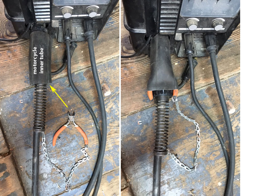

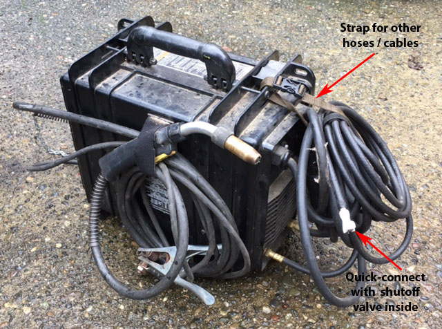

Heres some pics of how I deal with the portability.
488557d1479682057-bought-miller-multimatic-200-a-multimatic200_cables_hoses-jpg
I added a loop of webbing with a squeeze buckle (from a game camera strap)
488558d1479682057-bought-miller-multimatic-200-a-multimatic200_cpc-jpg

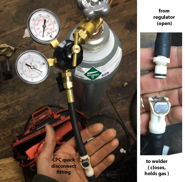

Added CPC quick-disconnect couplings to the gas hoses. 1/4" size for the Ar/CO2; and 5/16" size for the TIG nitiogen. The short side from the regulator is just "open" because I can purge it easily. The side that connects to the welder has a "shutoff" that closes when you disconnect, so the hose holds whatever gas was in it last, and you don't need to purge it. I like these connectors.
488559d1479682057-bought-miller-multimatic-200-a-multimatic200_cutter-jpg
Added a captive wire clipper that can't escape like its predecessors.

real quick, tell us more about the CPC fittings (what type and kind). Would love to have that for my mig / aluminum spool machine.
Not sure what your build was for the TIG kit, any explanation?
#56
There are many different versions available elsewhere, but these are the ones I used. These are more expensive because they have Viton seals (internal) for gasoline. I doubt the seal material makes any difference for welding gases but you can find them elsewhere for less. Search for CPC Quick Disconnect Coupling.
The 6mm fits the smaller 1/4" hose, and the 8mm fits the bigger 5/16" hose. 100-0100 and 100-0106.. I didn't use a clamp and it holds pressure for weeks.
