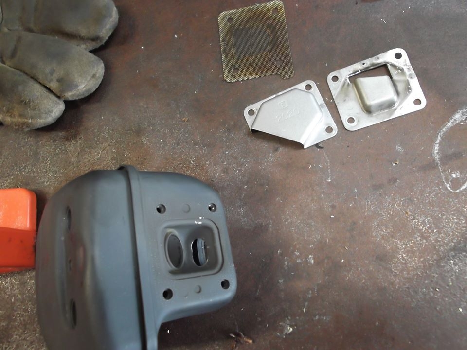

What is the billet muffler mod?

On the 590 or the CS top handle? I replaced the entire muffler on the top handle with a no cat one. On the 590, I added the billet diffuser and the air cleaner mod.

All a 590 needs is this simple free muffler mod using parts it comes with. Split the deflector. Remove the inner section that is reversed. No need to spend money.
Some like to remove the inner one and use for base for the outer once the little inner part is removed and opened up. Then set back under the top portion. I dont do that as I didnt have any issues.
Now full blown way is remove the inner tube. But I found just putting the hole behind original tube suffice.
If you dont do either of the above you havent really gained anything.
Pull the epa carb stops to retune carb. They come so lean from factory.
You mean on a 590? You take the muffler off and carefully remove the spot welded on last baffle that is spot welded to the exhaust deflector and add a couple elongated holes (I use a dremel) inside the muff directly across from the muffler. You can also buy a billet aluminum deflector inlet from SawitAgain but being the cheap person I am, I just modded the stock deflector. Modding the stock deflector allows me to keep the spark screen intact as well. Sounds real nice too. Not obnoxious, just a deep throaty rumble. Least my 590 don't have a cat inside the can but I expect that is coming as well. Like I said, I was ripping oak logs the full bar length and there was no slowing down with the saw what so ever.
