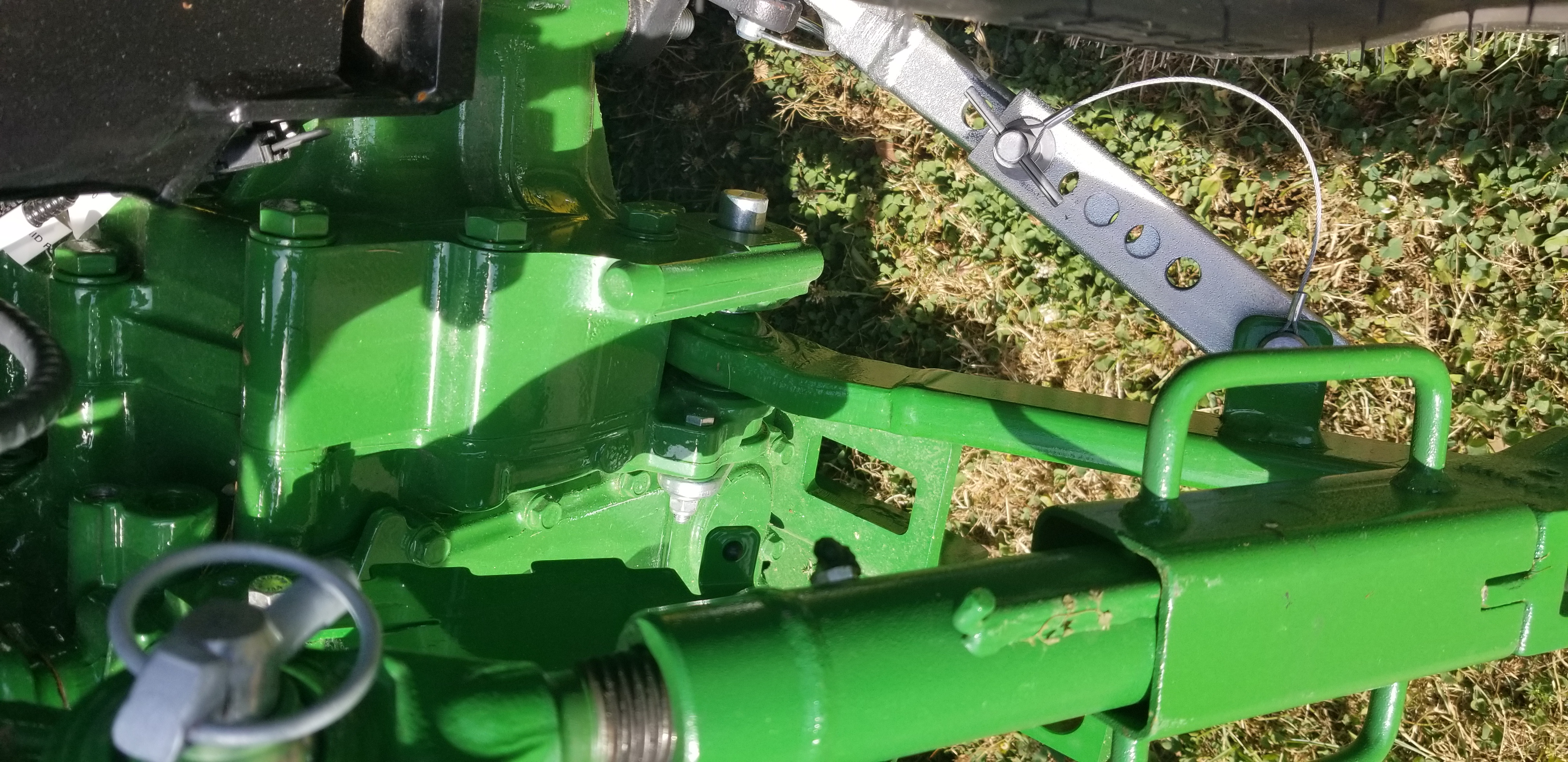

Topic being 3pt lower arm mounting designs: I mentioned earlier that my 'Bota B2150s use a single end supported pin but the pin is much thicker and mounted in mild steel rather than cast metal. Had ocassion to look at a few Deere models yesterday. The 3039R is roughly the same weight and HP as the Massey 1735. The 3039 uses a pin supported on both ends and looks to me like you could dangle the tractor on it with no damage. Very strong. View attachment 661259

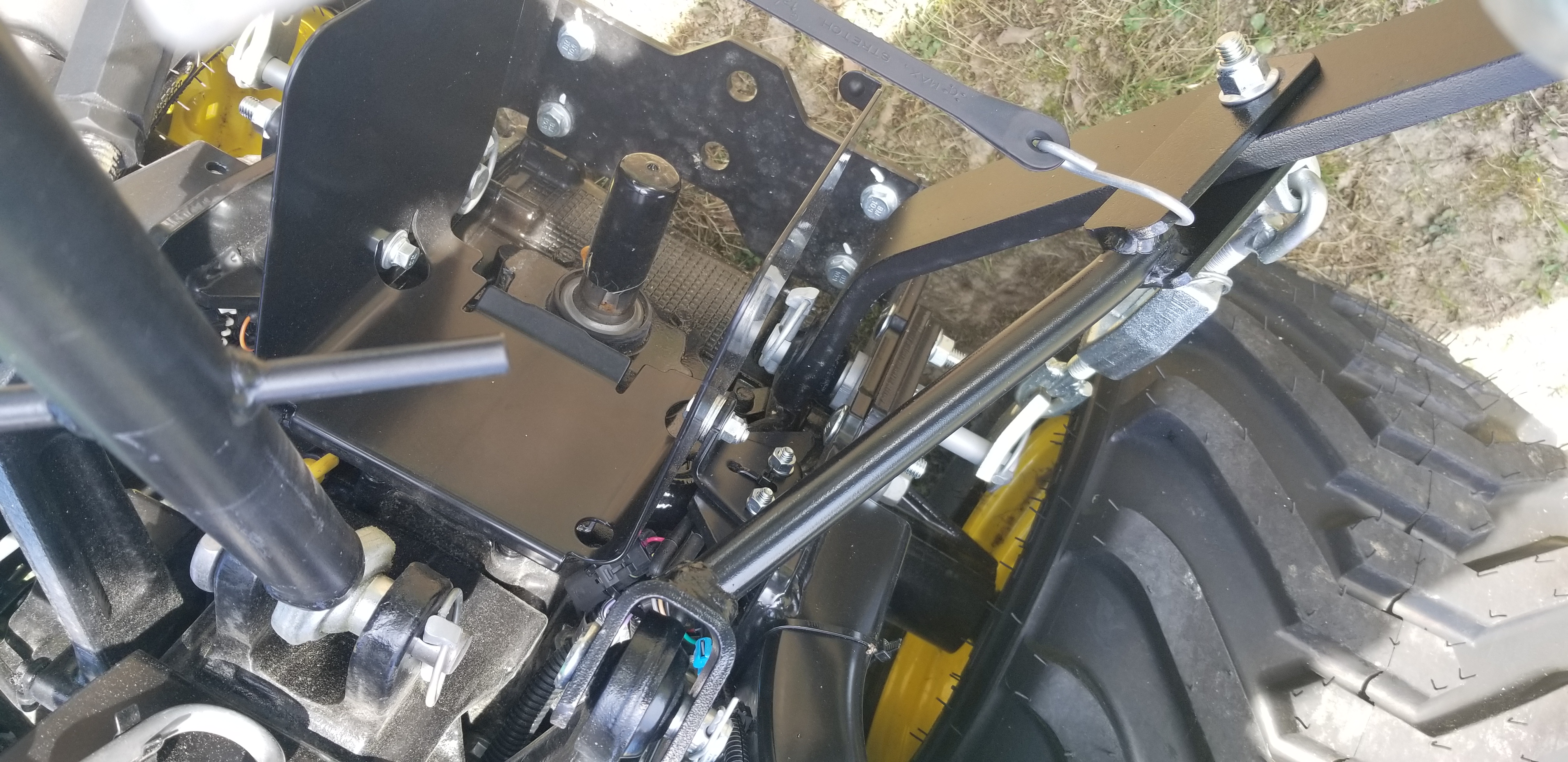

Meanwhile I looked art a much smaller Deere, the 1025R which is half the weight and 23HP. The 1025 has a custom oddball pin , not very heavy, that hosts the lower lift link on one side and the sway bar on the other side of fairly heavy mild steel (not cast) material. 20200626_163356.jpg
If the competition matters, the MF 1735 lower lift arm anchor seems light and under designed. Tends to make a case for a retrofit kit of some kind to beef up the support.
The Deere 3039 has an aluminum rear housing
It looks strong but no wheel spacers are offered because it can not take the stress
