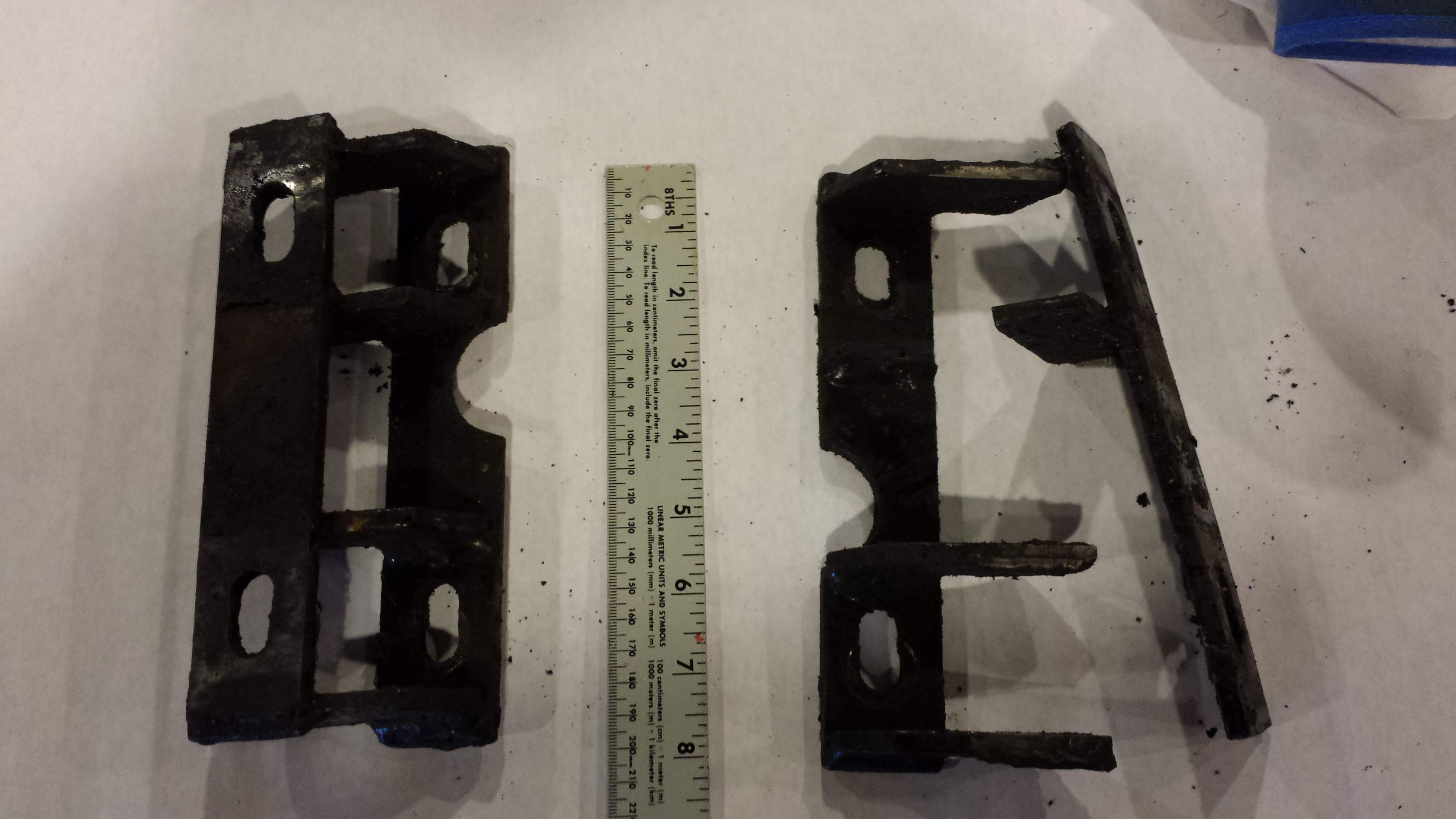

I have a 1984 Kubota L275 with a Woods Du-Al 155 Loader. There are two identical brackets that adapt the FEL cross-member to the bottom of the tractor shown in the attached photo. They don't look homemade. One is broken. I can have it welded but it might be faster if I could identify them and purchase a replacement. Does anyone recognize these? Are they a Kubota part or Woods? Thanks.

I would just have it welded, looks like a simple job doe any welding shop. If you do not weld.

If you have a welding machine, that would be less time to fix than a drive to dealer to pick up the replacement. You could also weld it a bit better than new. Looks like a bad MIG job that got very little penetration that caused the break.

I would weld the other bracket with a couple more passes on each side while it is off.

Since it's a Woods, loader, it should be a woods part, but may be obsolete, since you have a 30 year old tractor. It looks like an easy weld to make. any shop could do it. You may want to have the other side rewelded too, since the machine is down

Thanks everyone. I'll take it to work and have it welded and have the good one tuned up as well.

Poor design . Look at the weld contact area . NONE . I would come up with another design .

Turns out it is a Woods part. The price was pretty cheap which makes sense because the quality of the part reflected that. Had to be made outside the US for the money they were asking. I re-welded the broken bracket and beefed up the one that was still intact. Much better than new. It's all back together. Thanks for the input.
