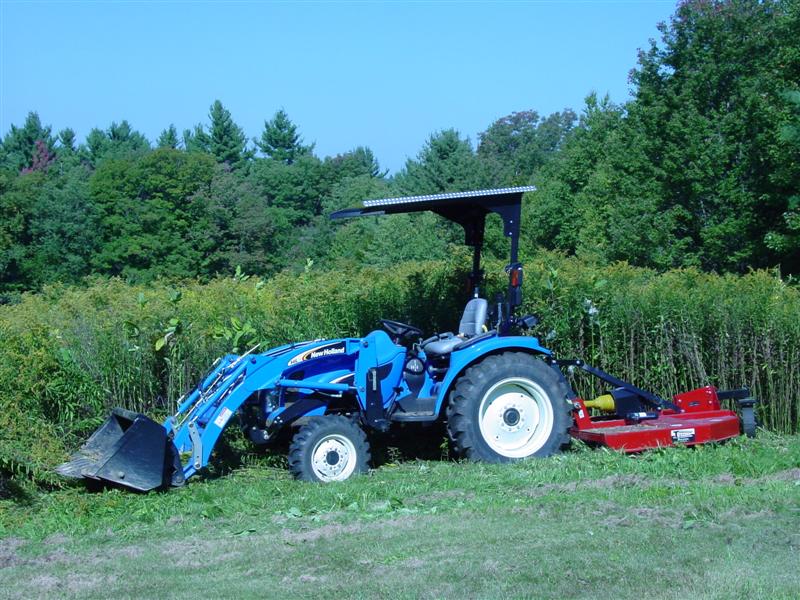

I have had a Woods and 2 Tebben rotary cutters. In both cases the manufacturers recommended that the rear of the cutter (i.e. blade height) should be ~1" - 2" higher making the deck lean forward towards the tractor. Jay
