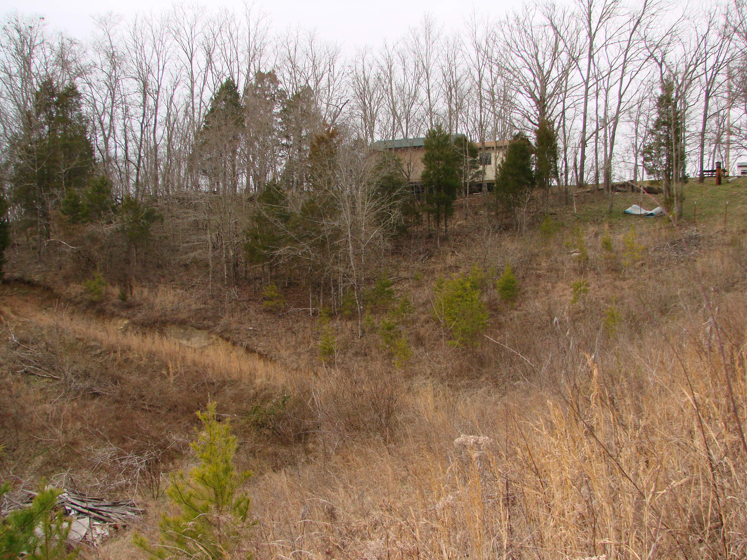

I looked again at Kents pics and don't see anything unacceptably steep for a two wheel tractor. It looks no steeper than my farm.

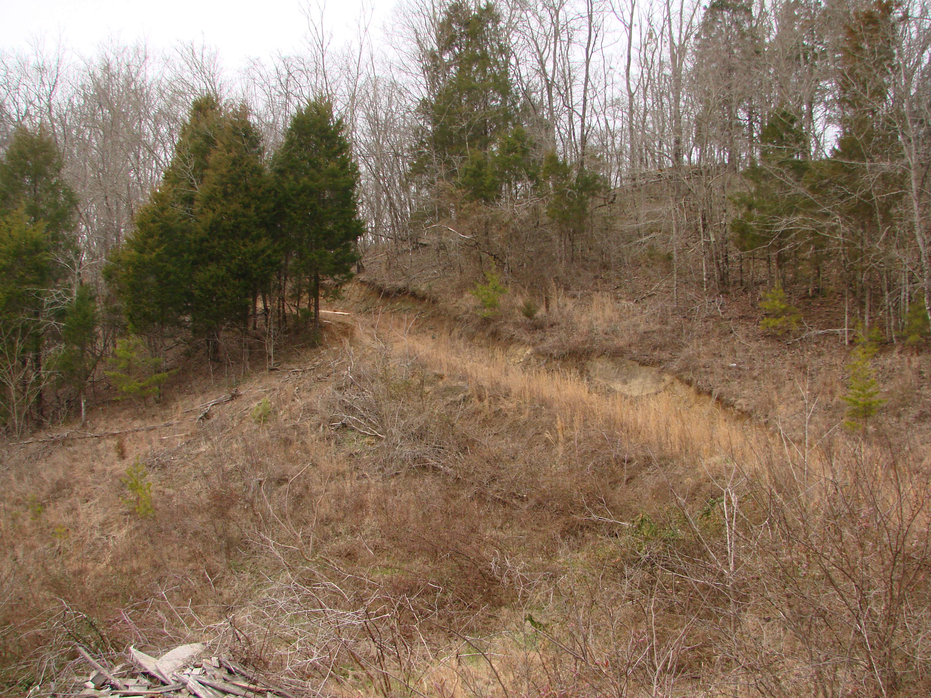

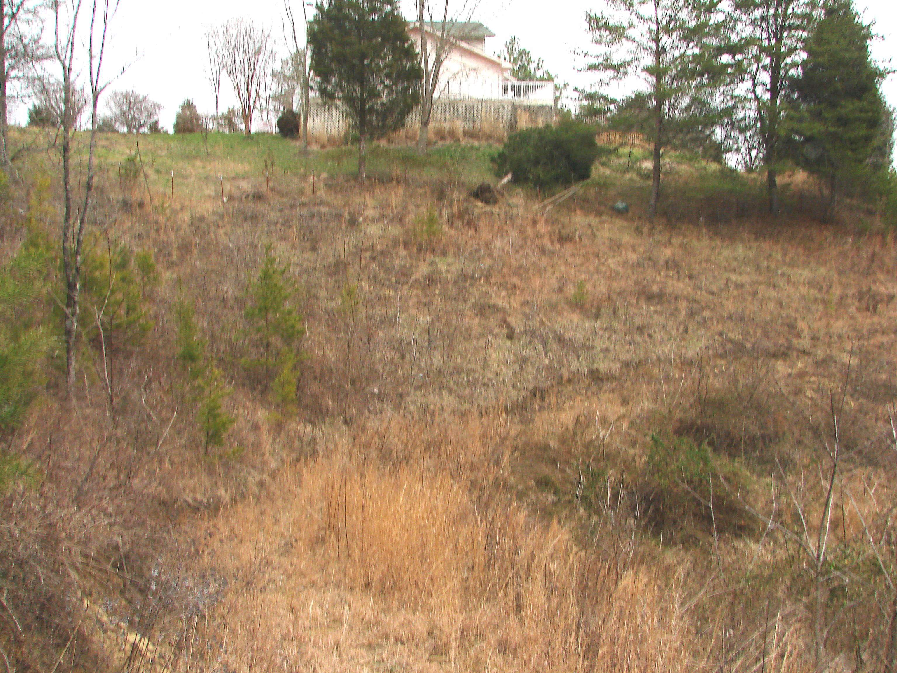

Just to close this thread out, I ended up making a deal on a clean Gravely 5260 that has been repowered with a Kohler Magnum 12. It came with duals and steering brake, has less than 600 hours on it total, and about 200 on the newer engine. He put too big a deck (50") on it, and upgraded the engine to handle it about 10 years ago...
That slope is nothing like some I'll have to deal with, but it was the steepest he had, and shows how far away it is from the tipping point. I've picked up a 30" brush cutter for it, and will likely add a sickle bar at some point. Here's a slideshow of pics, if anyone is interested. Meanwhile, it will provide a starting point, and let me know what a 2-wheeled tractor is capable of...
