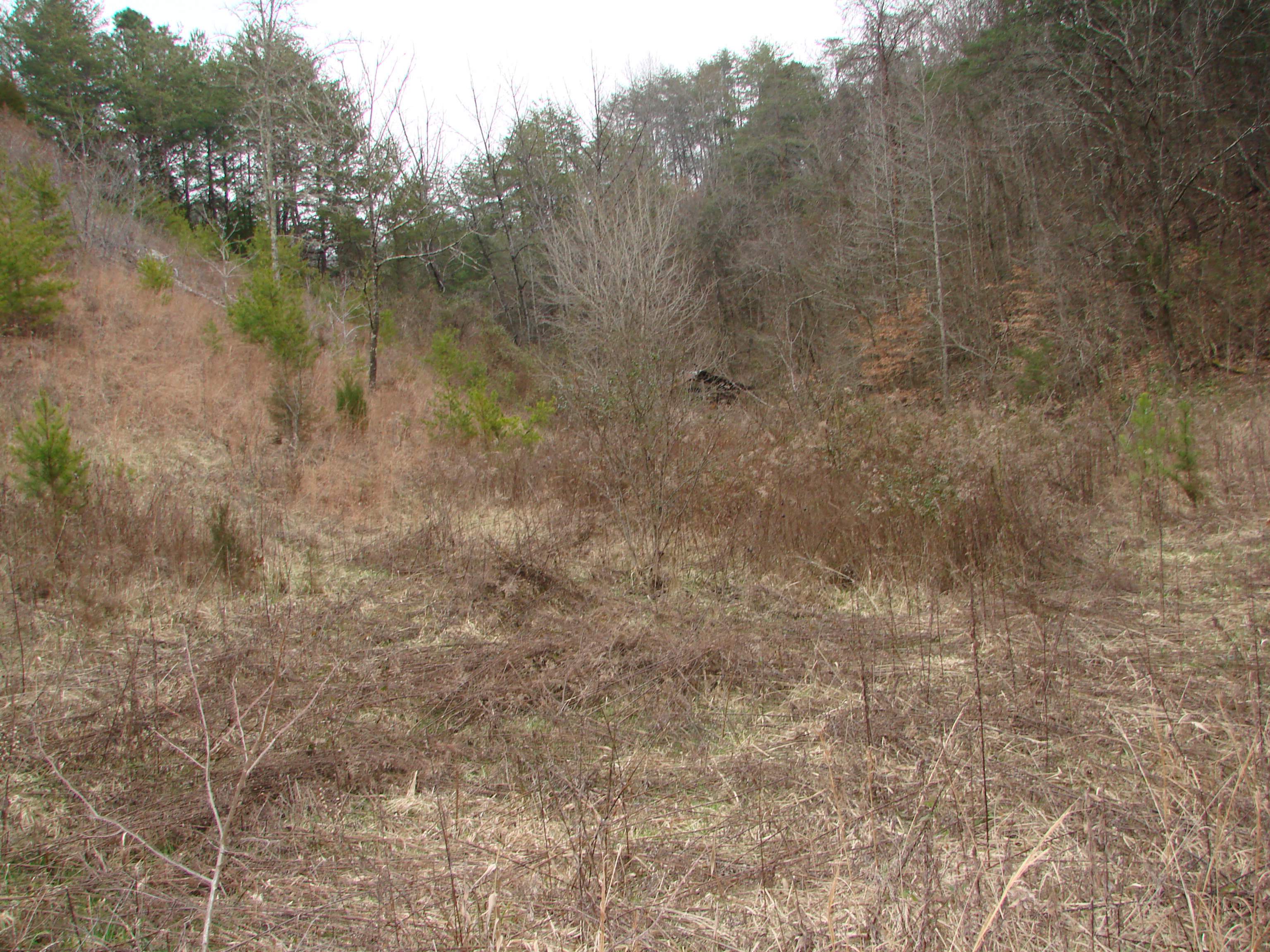

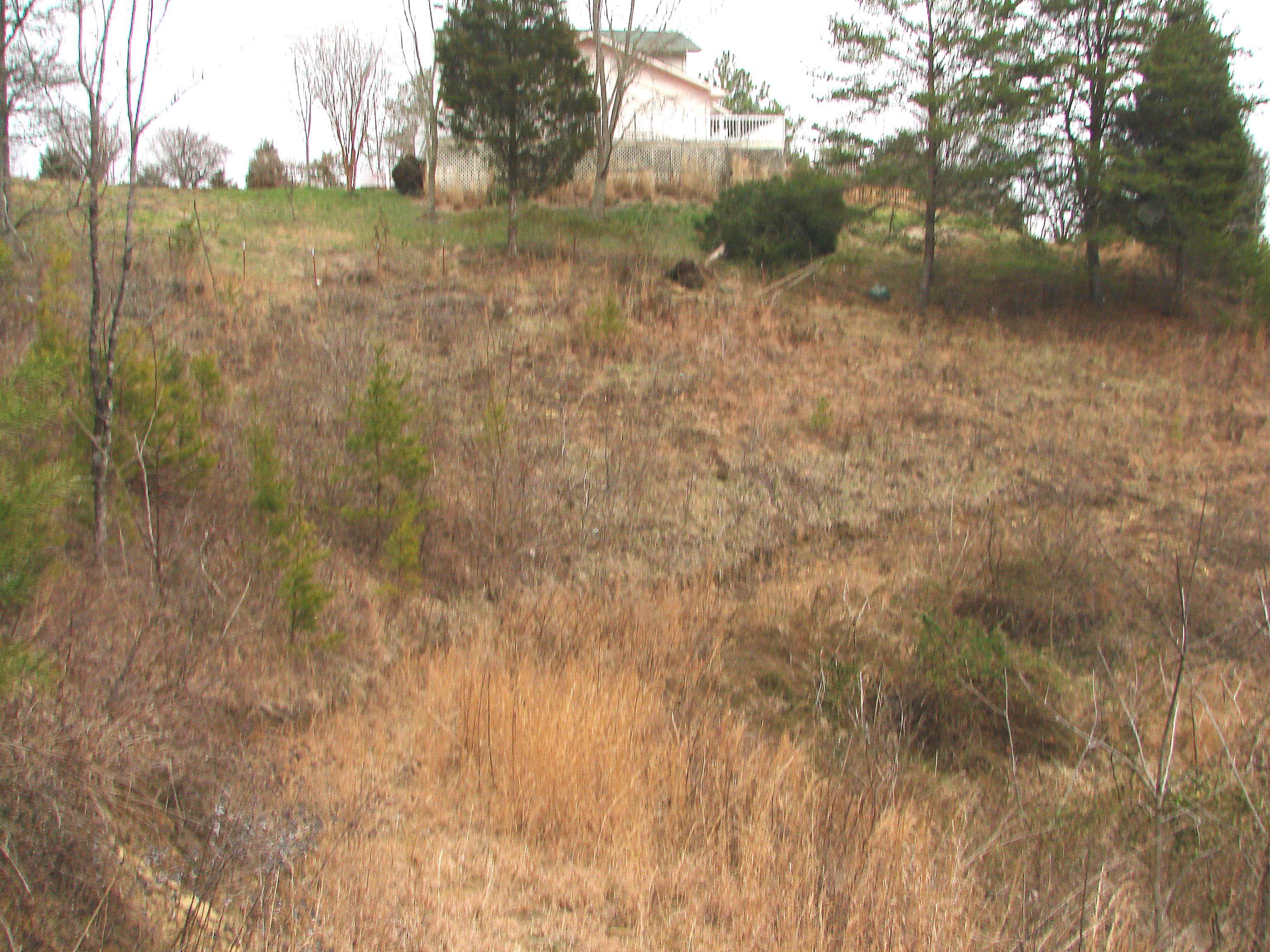

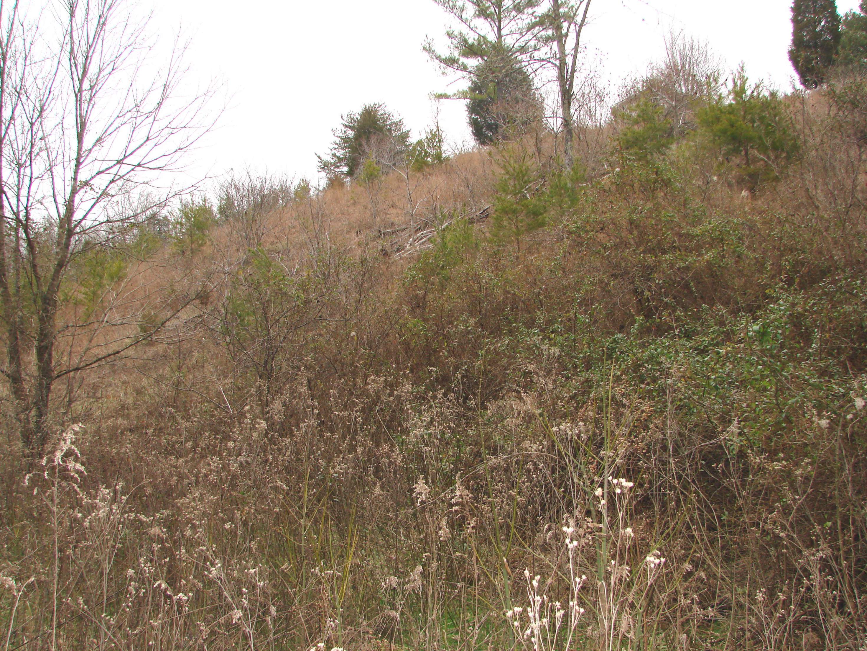

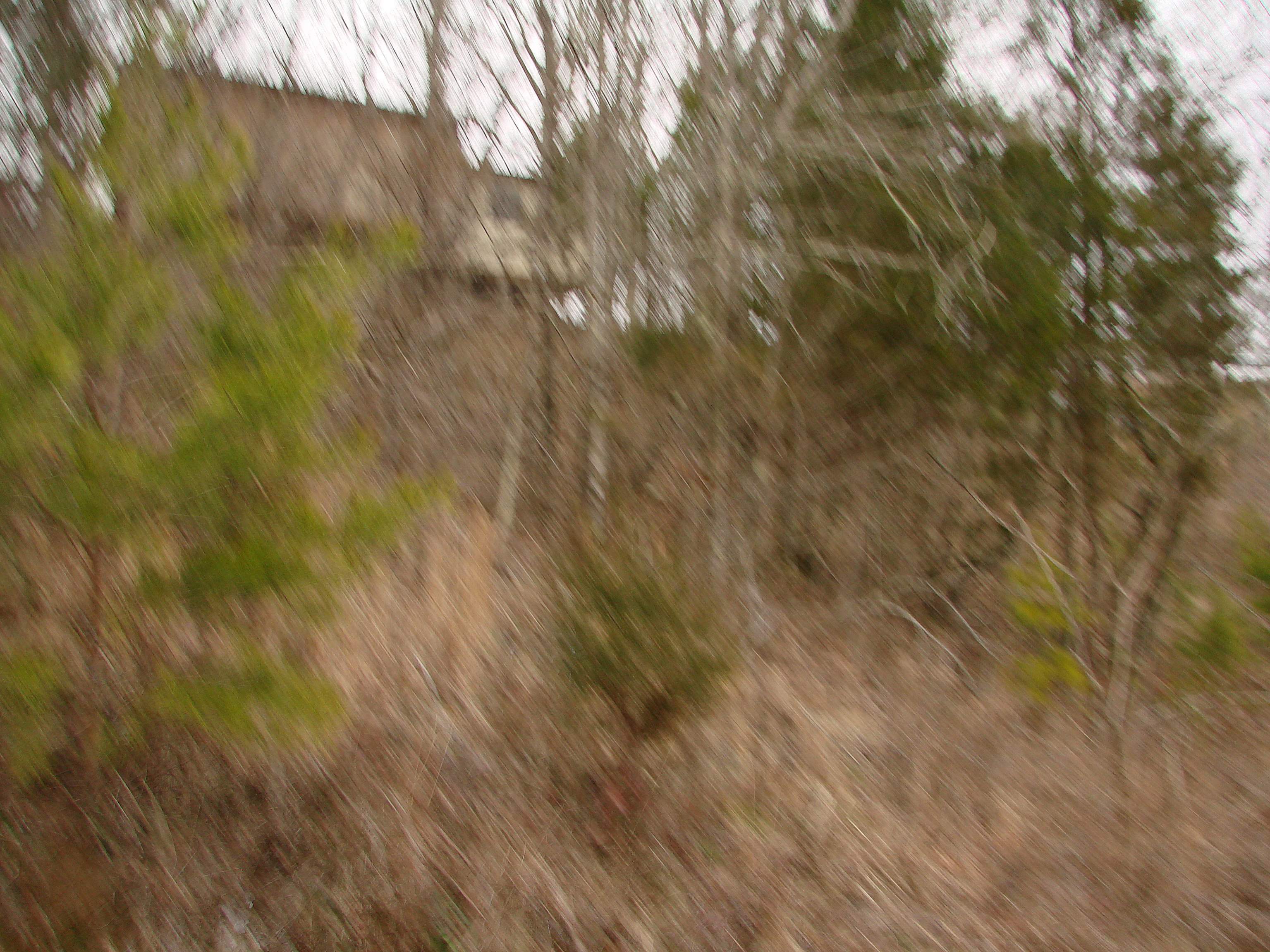

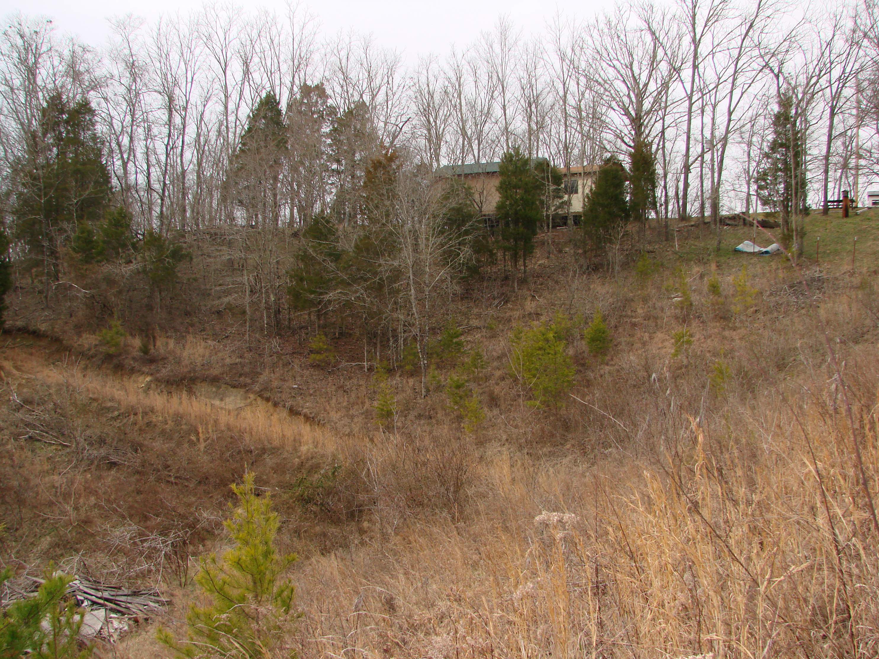

Just bought an overgrown 15 acre farm that has some steep hillsides -- at least 30 degrees, maybe more -- to mow and clear up. I can clear a lot of it with my Power Trac and 48" brushcutter, but there's some places too steep or too constrained (no runout, no turnaround, etc.). Plus, my Kohler's pressure-lube oil system is limited to 25 degrees. I have all sorts of needed attachments for the PT that makes it a "must-keep" scenario for use... so changing to a Ventrac or Steiner is not an option.
So, I'm looking for something 2-wheeled to handle the steeper areas, the treeline, etc., to minimize the use of a weed-whacker/brushblade. After a lot of research, I'm leaning toward the following USED machines:
1. Used DR weed/brush mower, with pressure lube engine AND locking differential. From what I've found, the locking diff came and went over the years, and I have to make sure the machine has both those features. That would allow me to also use it to mow the lawn which also has steep spots.
2. Used BCS tractor, but I am unsure of which models would be best suited. The BCS approach would allow me to initially clear it with a brush-cutter, then later maintain it with a sicklebar, while also replacing my 20+ year old Troybilt tiller at some point...
I've so far eliminated the following:
1. Gravely - because they're heavy, most (if not all) are splash lubed, and trying to find one with steering brakes is like looking for a needle in a haystack...
2. Billy Goat & Swisher because neither have locking diff, and reviews are mixed.
Any suggestions on what specific BCS models might work, since I know little about them...
Any other alternatives that I've missed?
Any feedback on using the DR or a BCS in these types of hillsides?
How does the BCS finish mower perform for mowing the lawn?
Thanks!

I will candidly tell you that a 2 wheel tractor or any rubber tired tractor is not for this mess and I will tell you why.
The angle of attack and the angle of the slope are the two issues you are dealing with; as you say there is no means of turning around you have NO angle of attack which is the angle the tractor approaches the incline.
You will be much better off renting or hiring the largest skid steer loader with tracks that has a brush mower on it as the angle there is much more than 45 degrees and that is unsafe to walk with a 2 wheel tractor or any 2 wheel tractor!!!
The other thing is that side hill mowing is out of the question as the angle is much greater than 15 degrees as well.
You do not appear top have enough room from bottom to top to create switchbacks to allow you to ascend or desend the slope anyway.
Its a situation where a lot of weed killer is the only solution as the contractor or owner had no desire to fix it when the home was built but if you have drilled well that is not a good combination.The issue is stability and a two wheel tractor foes not and will have enough weight, traction or tread to deal with this.
Having someone come in with a mulcher head on an excavator or a timberjack tracked tree feller is the best way to deal with this angle as the tree feller can tilt to maintain a level machine at all times.
Its just to steep to work safely with a 2 wheel tractor as the tractor will run out of adhesion before it runs out of hill and gravity will not be your friend in this case.

I appreciate the candid response. However, paying someone to come with expensive machinery on a regular basis to maintain it is simply not an option -- I can't afford it. I'll just have to do what I can safely do, and go from there...
The first item is to see how far I can climb those slopes with my Power-Trac with the brush-cutter raised, before losing traction. Note that the Power-Trac also lifts and tilts its front-mounted cutter, so I can handle that angle of attack, where I do have runout at the bottom.

Has the area in your pictures been strip mined in the past? If so be very careful of what outcrops might be hiding in the brush and of sinkholes.
/ Brush mowing steep slopes
No stripmining... just steep hills.
There's shale rock that is close to the surface in some areas... most of the land is of zero value for anything other than pasture -- and privacy.

I looked again at Kents pics and don't see anything unacceptably steep for a two wheel tractor. It looks no steeper than my farm.
Here's a couple of many European videos showing two wheel tractors on hillsides. Is this steep?
[ame=http://www.youtube.com/watch?v=GP_-u5ydgnk&feature=channel&list=UL]Mountainpress en - YouTube[/ame]
[ame=http://www.youtube.com/watch?v=_fEa5Nwi05A&feature=related]Rapid REX - Der leichteste Hydrom臧er der Welt - YouTube[/ame]
These are extreme examples, but two wheel tractors are MADE for steep hillsides where a 4 wheel tractor would roll over. The second video shows a Rapid powered by a Robin Subaru EX21 7 hp motor. There's also videos showing remote controlled two wheel tractors, but I couldn't find them right away. Any two wheel tractor can be dualled up and steel wheels are available from Earth Tools that will help "hold" the hill. You can also get axle extensions and wheel weights to increase stability. Kent may need to go with a sickle mower to get a widened cutting path to stay within the wheel tracks if he needs to get very wide.

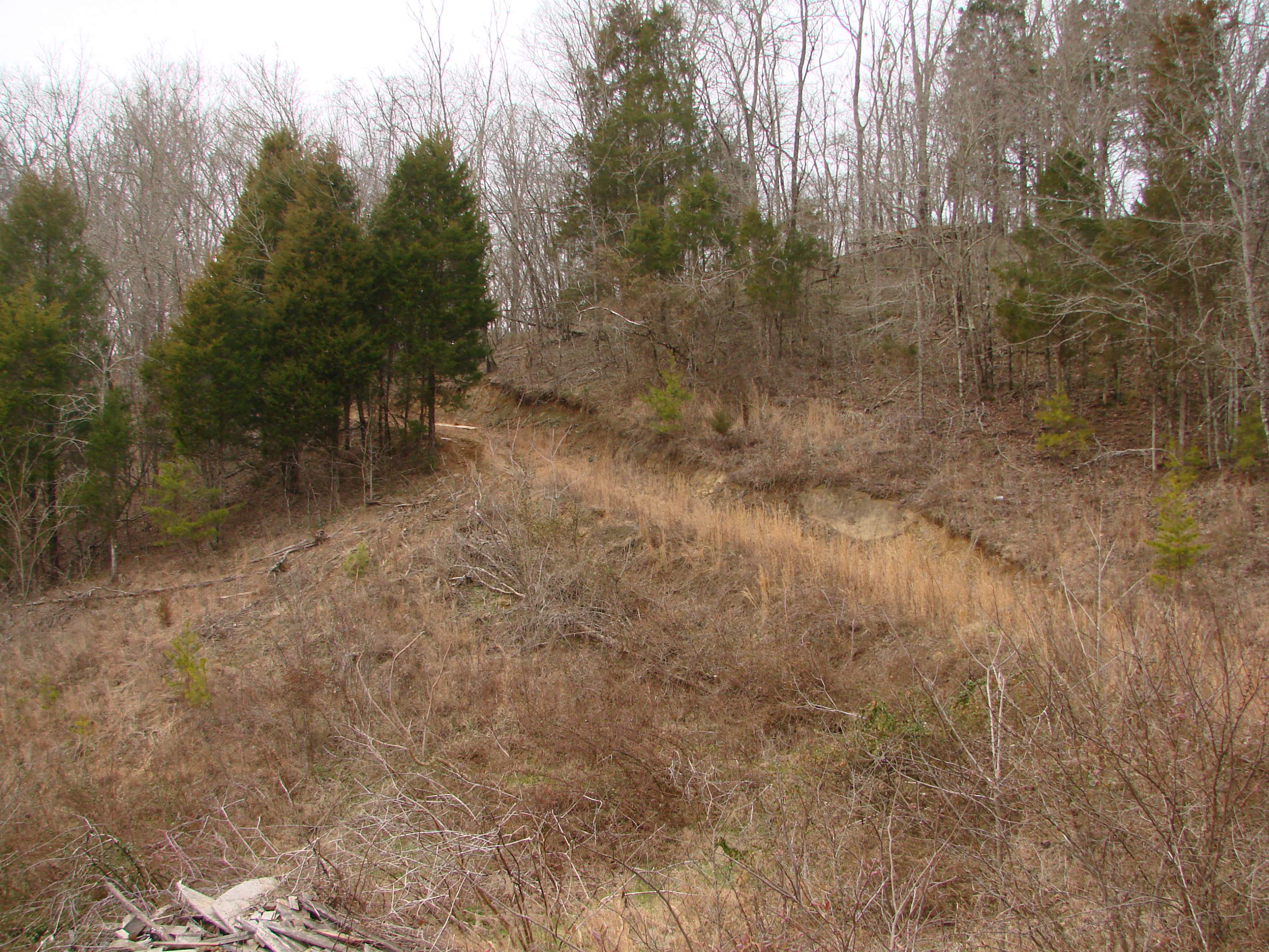

Not sure I understand -- how do you level them? As it is, where they've cut in a road down into that hollow, they've left me with areas above it that now have no run-out, making it even more a challenge.
The third pic below shows how little topsoil there is on that "road" bank, before you get down to "cracked/layered shale" . ..
