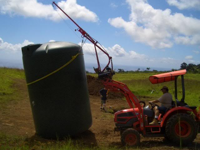

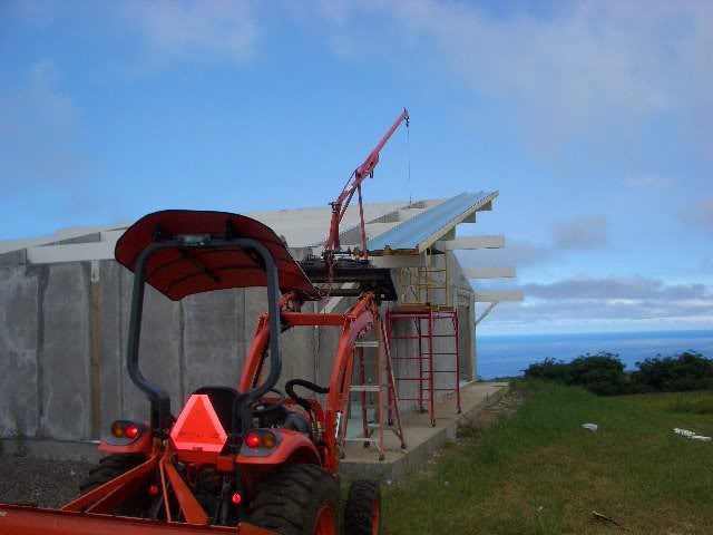

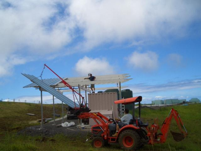

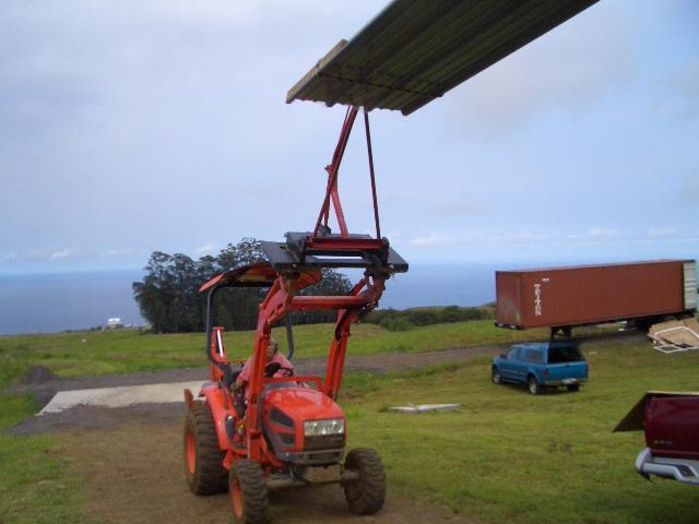

Here's some pic of my attempt
Forget a hand crank, I got a 12vdc 1 ton winch from HF.
Unloading shipping container
placing roof panels
moving 8x12 4000 gal tank
placing 25ft roof panels
David Sent from my iPad using TractorByNet
*cool!* with backhoe for a bonus! to lift stuff, but also as counter weight with boom on the FEL!
nice use of quick attach on FEL as well!
lifts high enough to help set rafters for a new shed or house edition as well!
12v winch... WOW! though looking at length, could really understand why! trying to barely tap the FEL joystick or levers, for a very small adjustment can be rather difficult with boom sticking that far out. 12v winch, i bet really helps out lower or raise the metal sheeting for the roof!

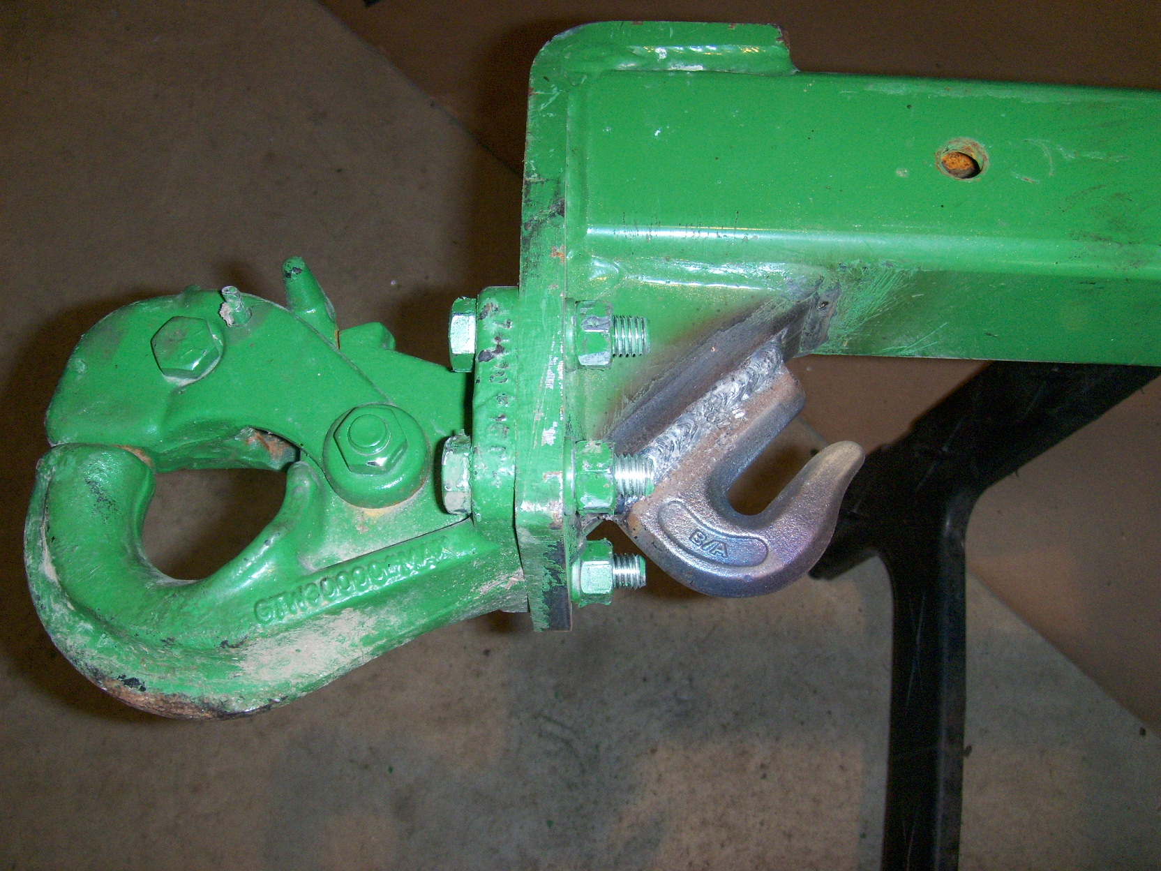

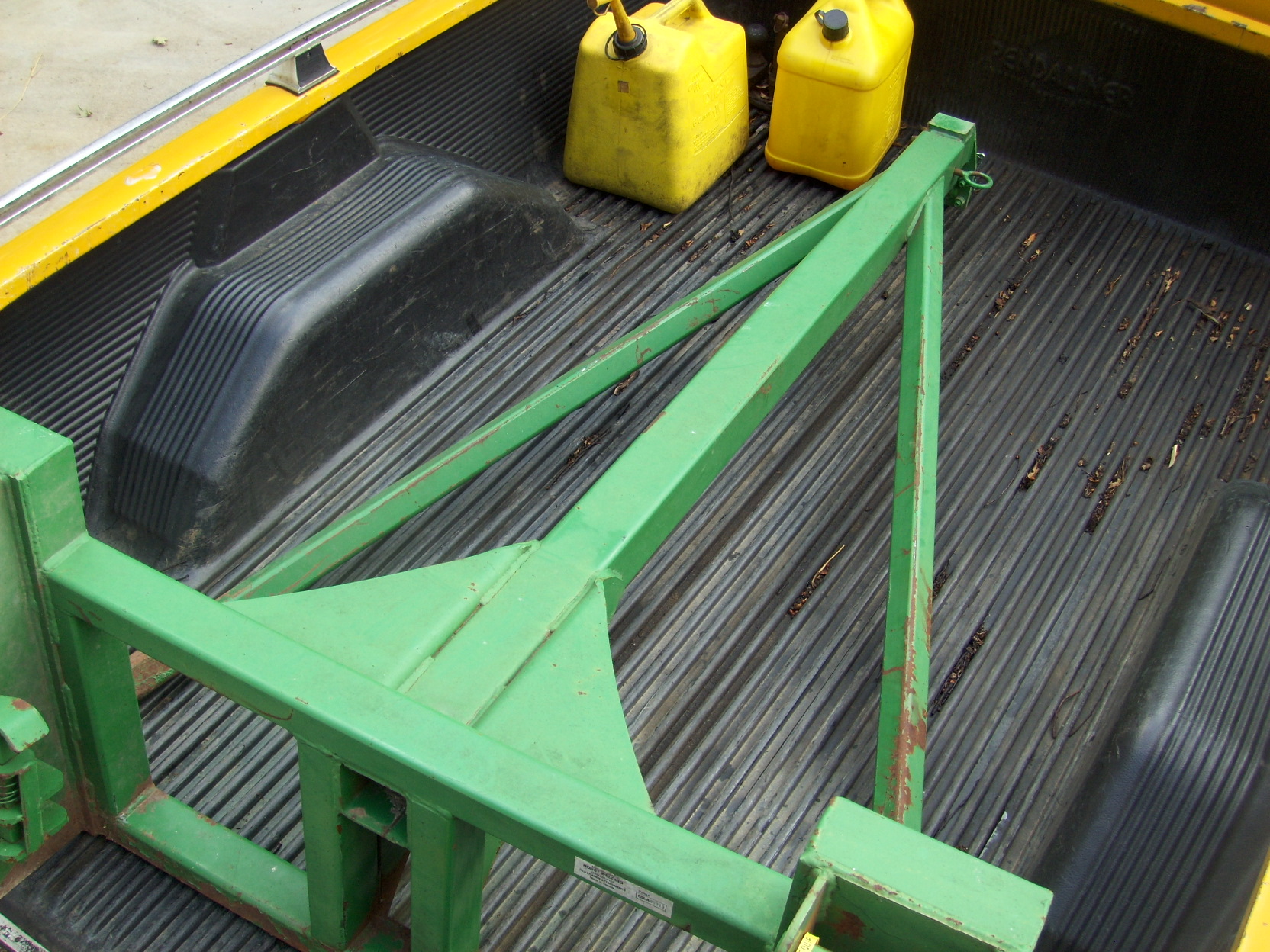

I did not build it. Local JD dealer got a tractor in with same loader as mine (640) and 4 attachments besides the bucket.They had two types of bale spears, pallet fork and the boom pole. I wanted the pallet forks but we could not agree on price. I asked how much for the boom pole and he said not much demand for them. $150. I bought it on the spot. It's made to go on a loader in place of the bucket. It telescopes, I am guessing 4', from approx, 7' to 11'. I have not measured it yet. I did do one modification, that was to weld a hook on the end. It has a pintle hitch on the boom end.

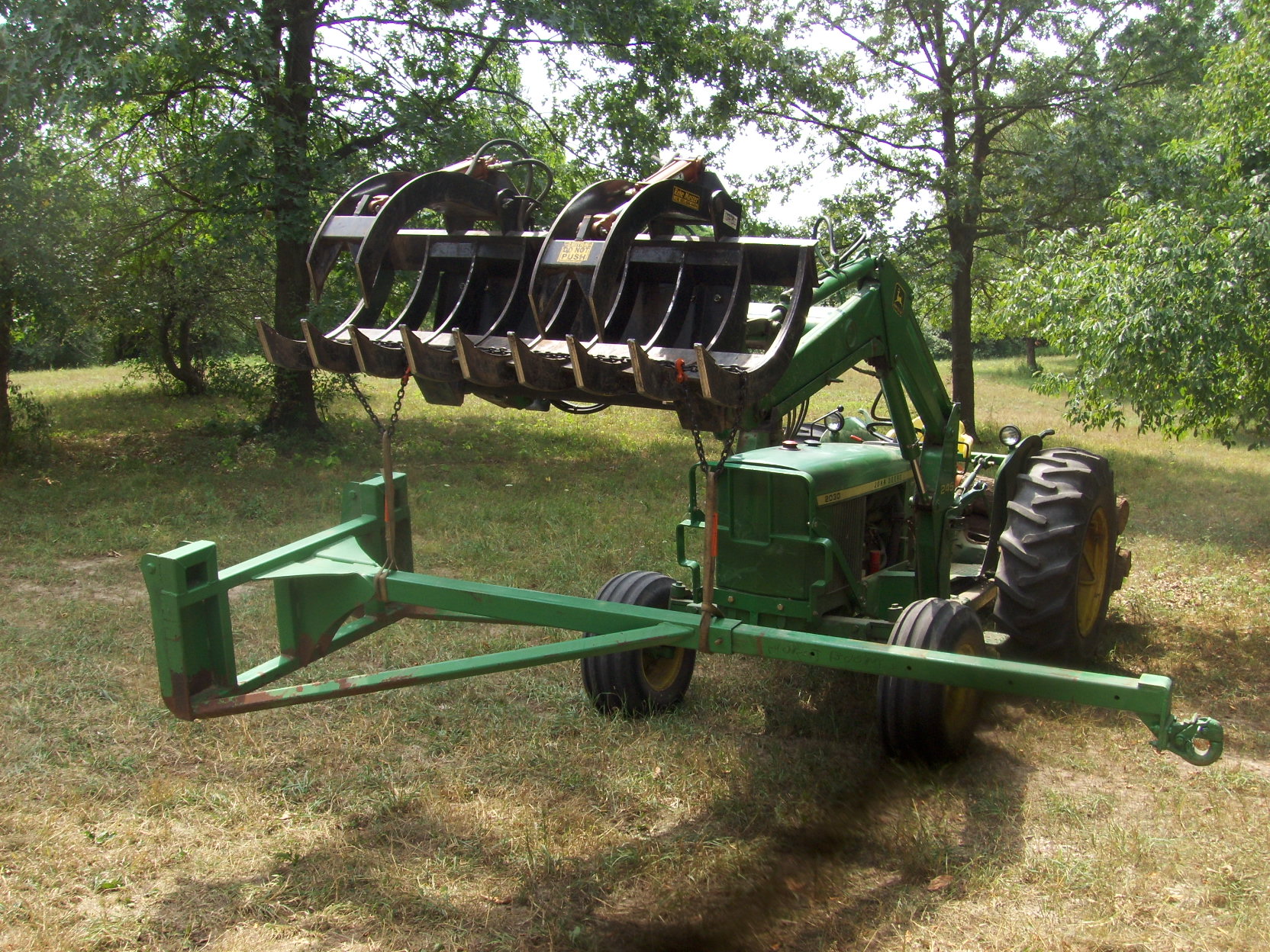

While it's show & tell, betcha never seen a jib pole do this. I built this pole about 8 yrs. ago, it has close to 7' telescoping legnth. Then I built the "roof rake" tip (the rusty part) when I put the lean to on the shop. As much as I was hoping, a 3/12 roof pitch will not shed the snow. It will reach about 28' (for lifting) when it is near vertical and the SS boom up all the way, but the most fun is sticking it out over the pond for a rope swing.:laughing: That is after the ice and snow are long gone. Pretty handy for setting trusses if there is not too much "reach" needed.

Now that is a boom pole!

The inner, moveable section, is 3" x 3" square tubing, 1/4" wall. It's here at my shop to weld the hook on. The rest is out at the farm. I'll measure next time I am out there.
   / Building a Boom Pole - thoughts? #29
The tube the inner section slides into is 3 1/2" square tubing 3/16" or .180 wall.
I found on the Horst website; total weight 320 lbs, capacity collapsed 3000 lbs, extend 1500 lbs.

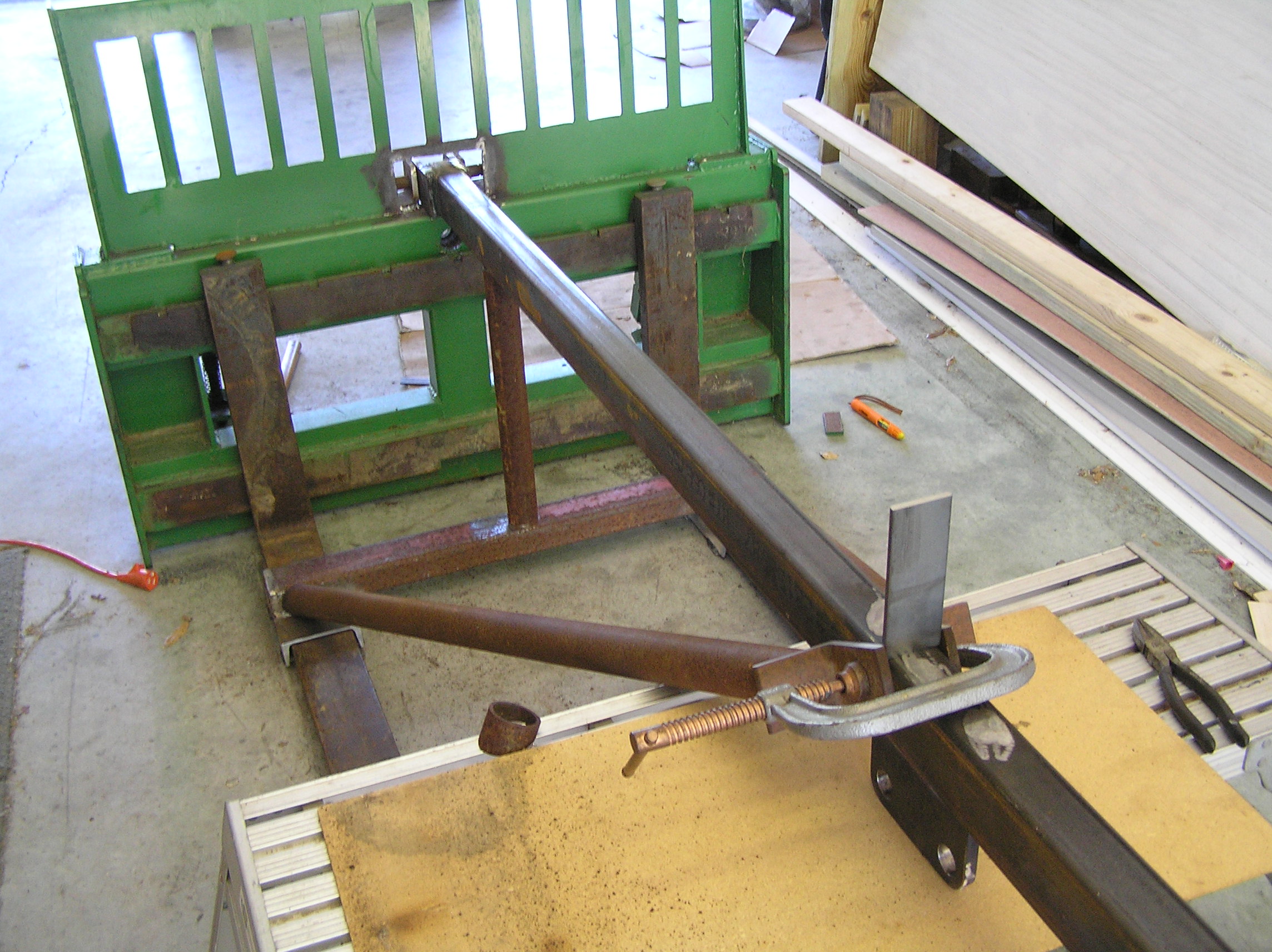

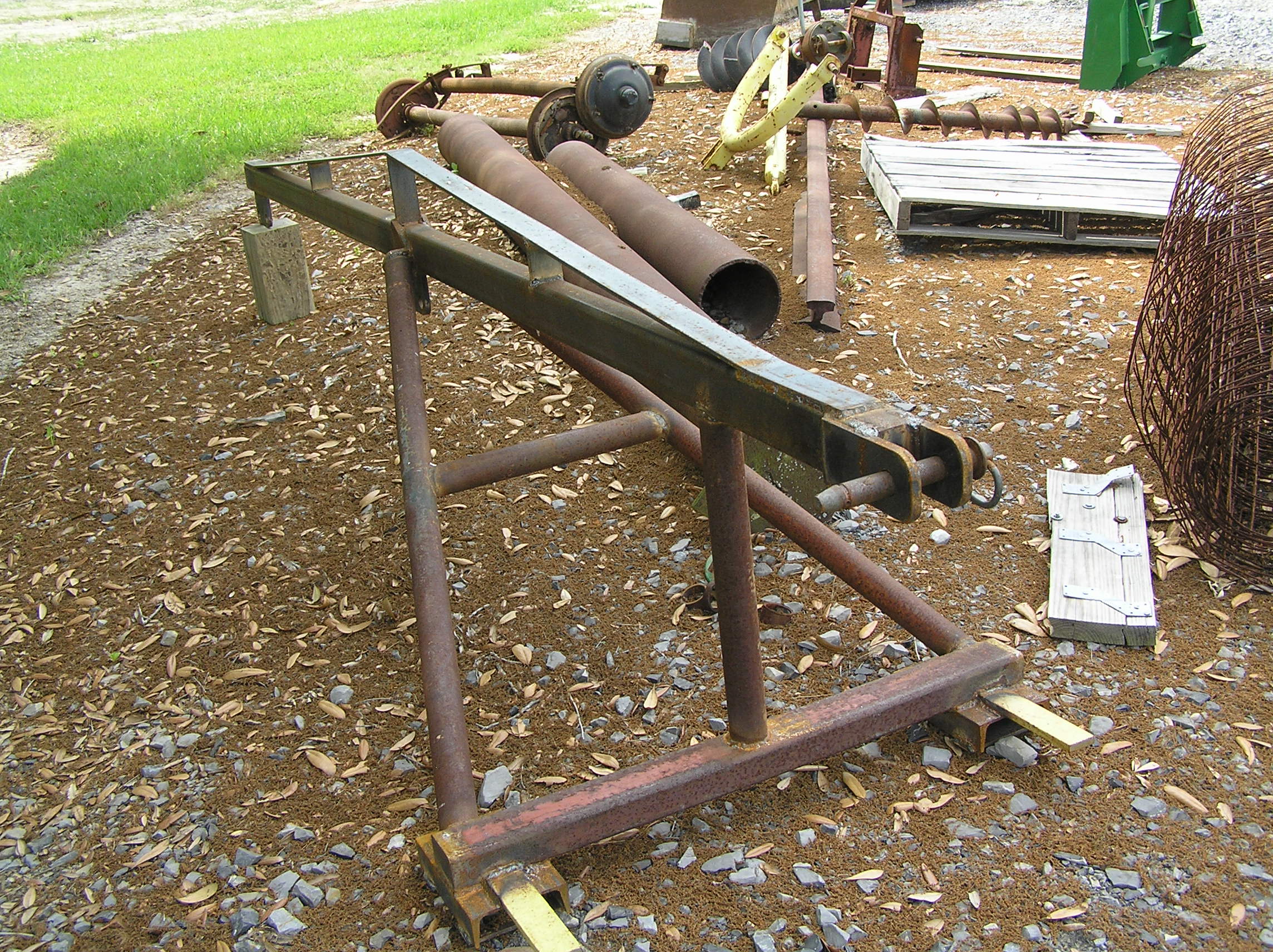

P1010782.JPGP1010785.JPGHere is a picture of my boom pole build. I made mine to fit on my forks. Works great!
