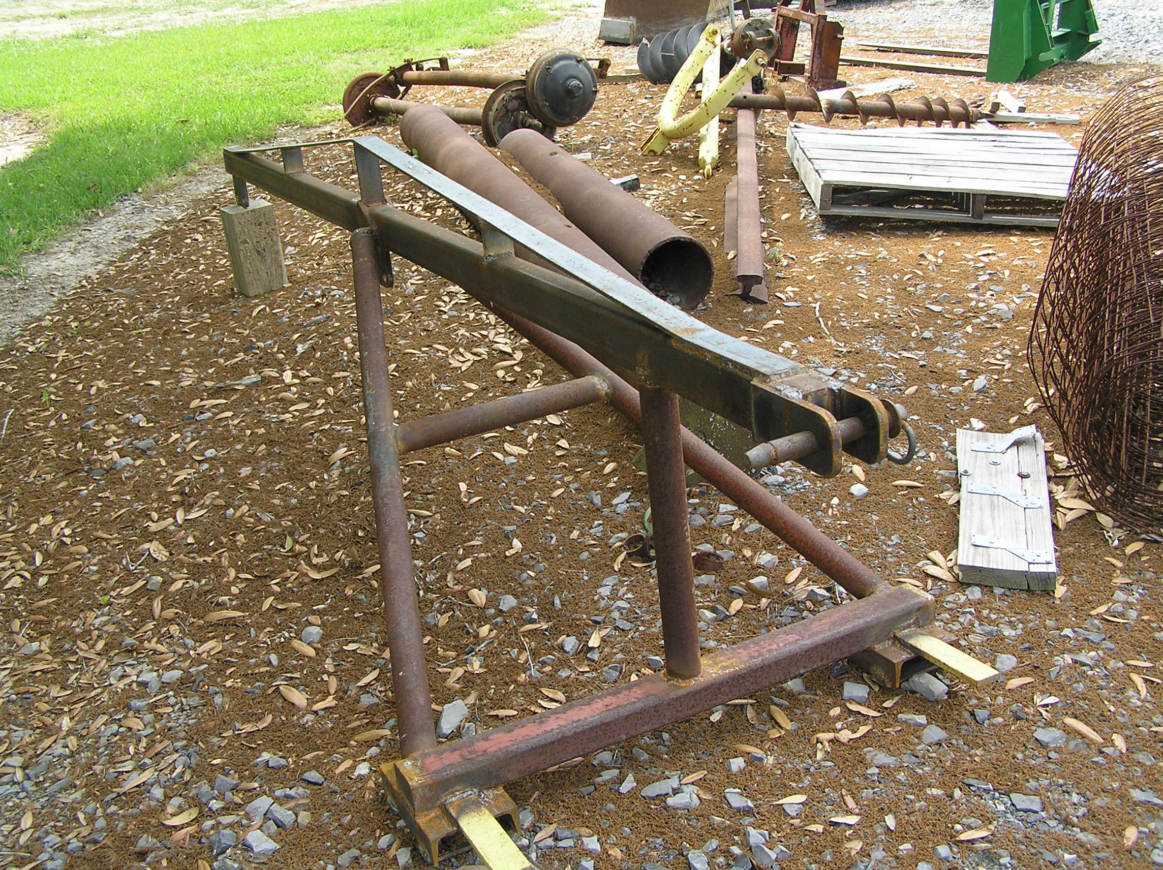

This is one I made last year using an old bloat trailer tongue. It iw 2X4X3/16". 8" long and 22" tall.
1/4X4" base plate and 1" water pipe for side stiffeners. 1/2" round stock for stiffener on top. Cat 2 draw bar. Four 3/4" bolts hold boom to draw bar. When I got the base plate bolted onto draw bar I tacked each bolt head in three places and only need one wrench to take it off. But the draw bar is dedicated to the boom so I haven't needed to take it off...YET !
The box metal was already gavanized so I cleaned it all up good and put 5 coats of spray galvanized paint on it. Minor rust around some of the welds. but still holding up.
I use it on a L3200.

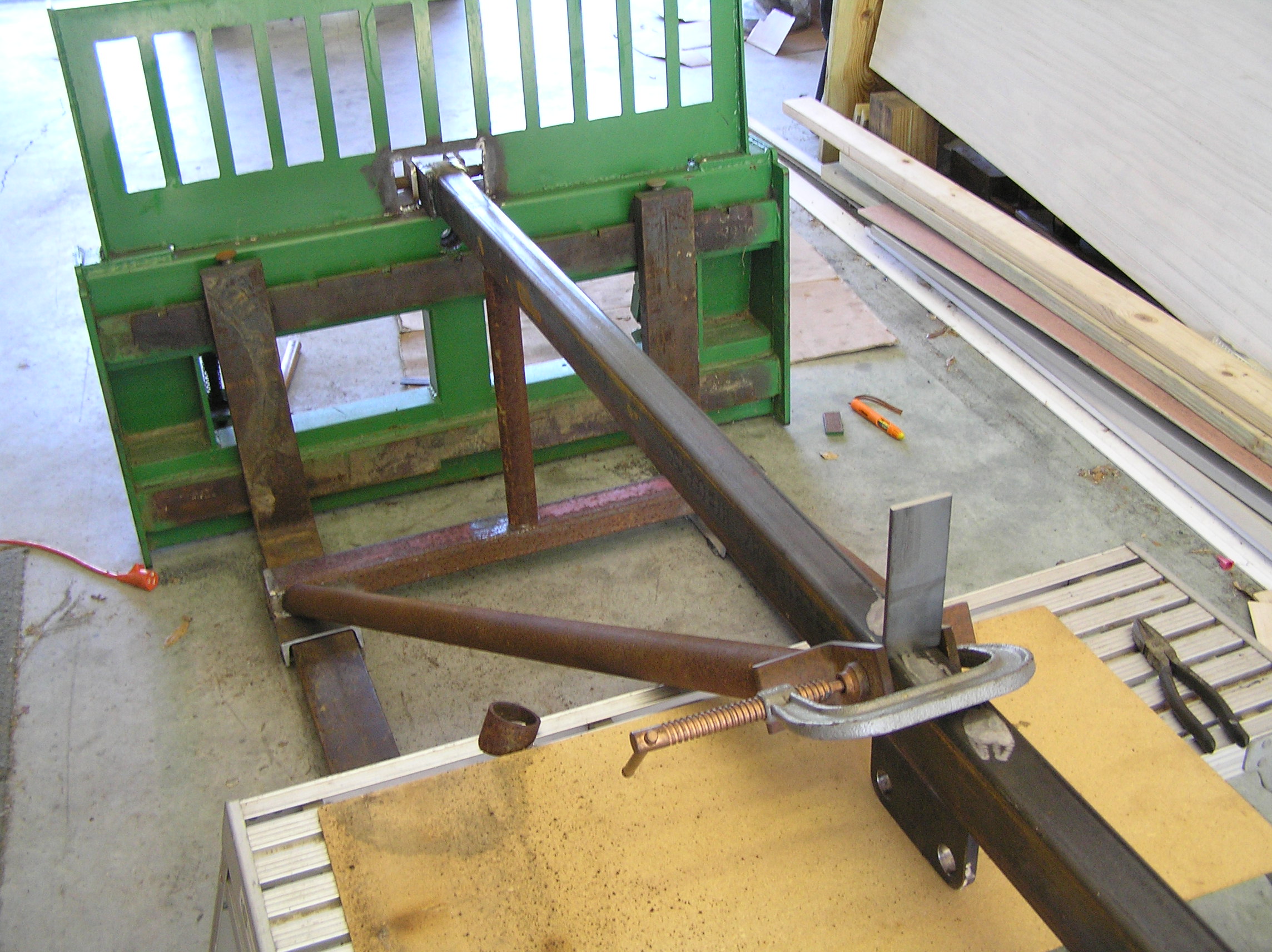

I am looking for a boom pole for a few uses and can't seem to buy a good fit (and price) so I'm looking to design one and then get a local welder to make it.
I have the regular uses for moving equipment, loading/unloading out of the truck box, and the occasional assistance in a building project. These seem to be well served with the regular 3 point boom poles one sees advertised and sold at dealers. At times I will want good height, so moving it to the FEL makes sense and with a SSQA -> 3PH adapter seems possible - and still without any fabbing. But once I starting thinking about having one, new uses come to mind.

So my questions:
1. AmericanTractorDrive - did you build your boom? Did you model it after the Horst boom?
2. Telescoping - any more examples of this? Would 2"X2" hitch style steel or the larger receiver steel provide enough strength for the telescoping portion - say a 6 foot extension (he asks knowing nothing about metalworking and steel)?
3. If it's telescoping then it would have an accessible square tube at the end, I am thinking that I could have different "ends" to plug in for the situation - kinda like the "bucket buddy" - anyone have examples - good or bad?
4. To get a straight vertical lift/drop, I am thinking a hoist/winch is necessary - I've seen a couple of mentions of a boom/winch combo but I haven't found any good pics on how the winch or pulleys were mounted. Suggestions?
5. Am I making this too complicated?
