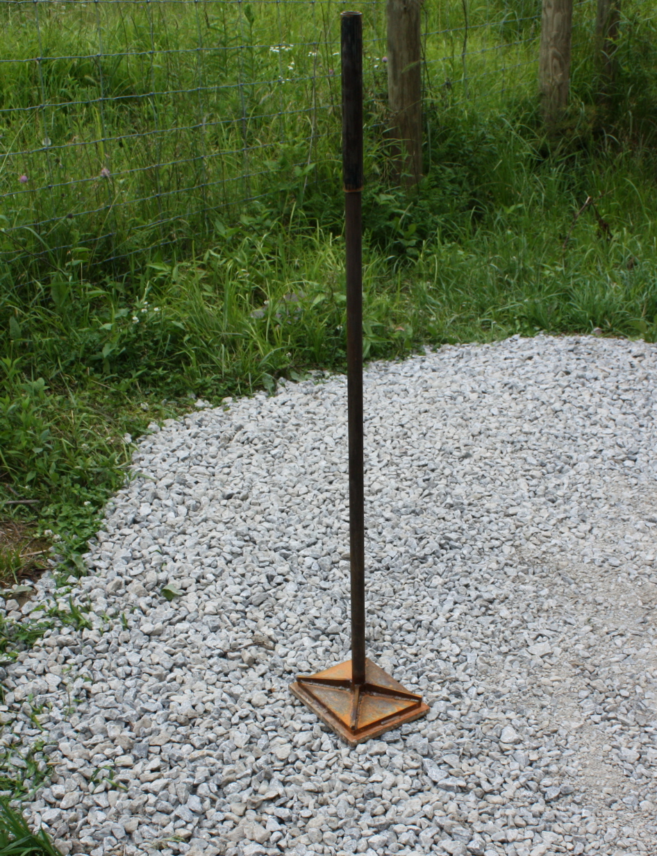

Here's a pic of my home-made tamper. Tractor Supply wanted $30.00. for a fancier one.

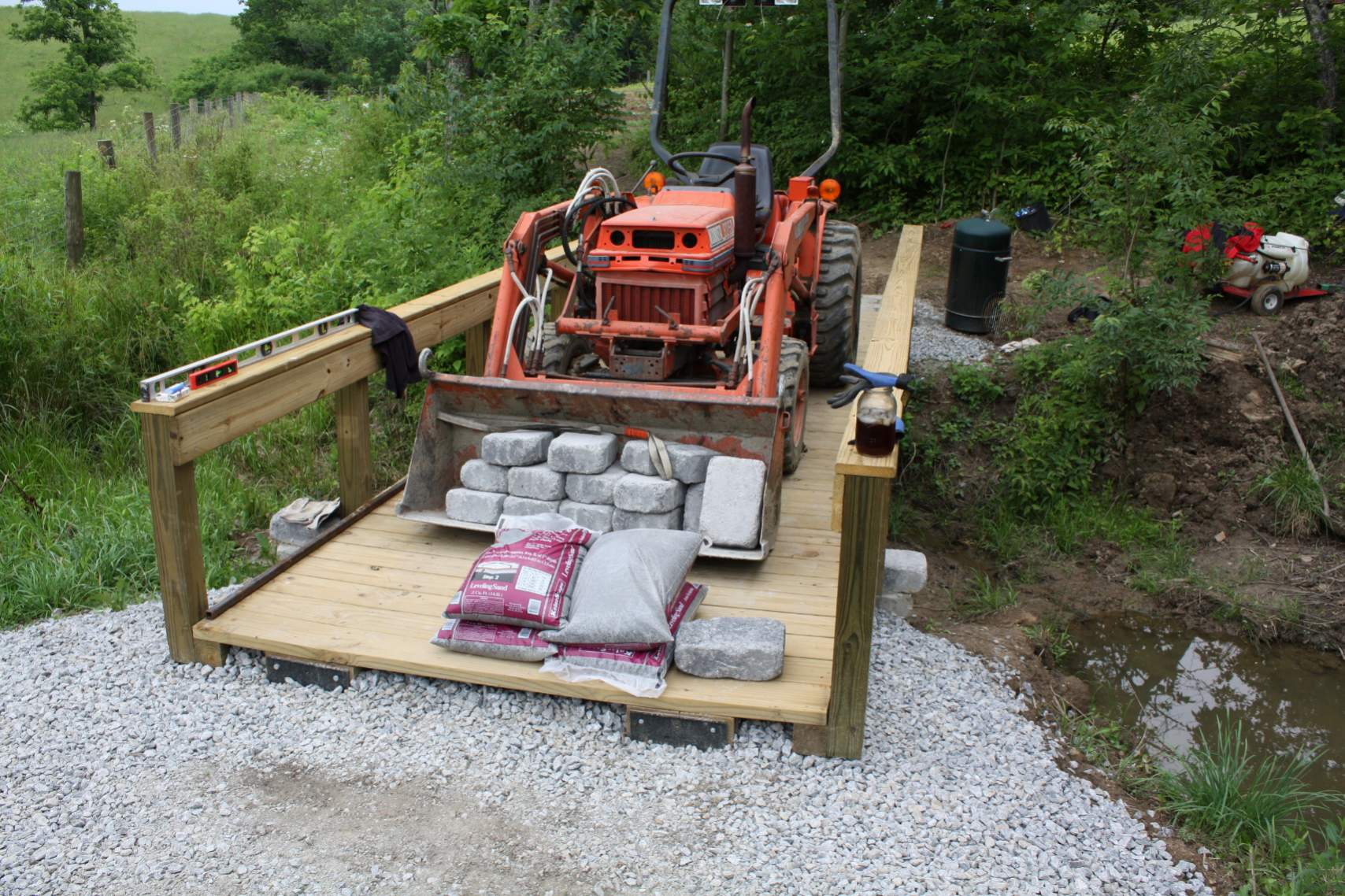

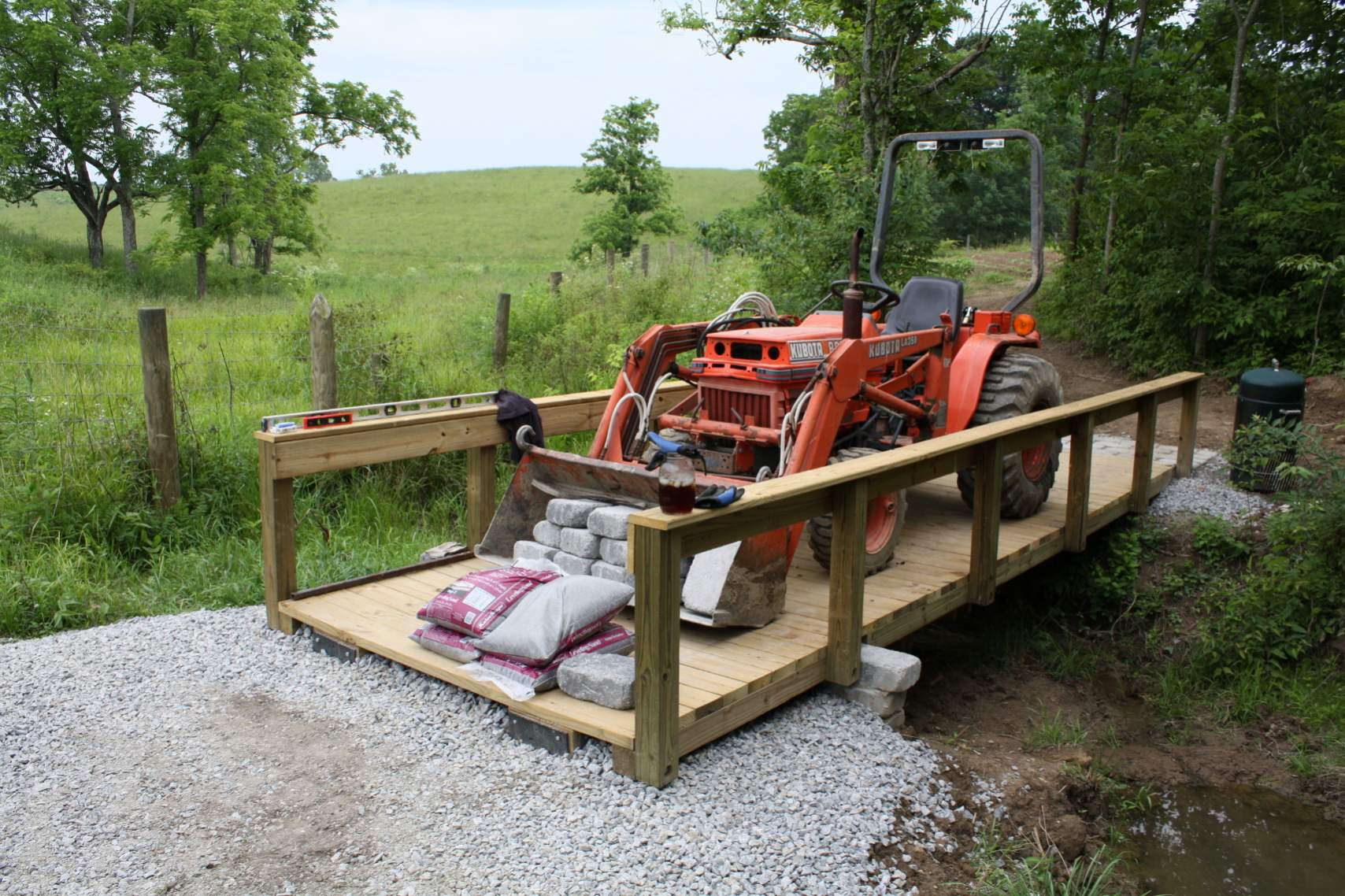

Here's some pics with the Kubota on the bridge. I'm starting to lay the pavers on the other side.
/ Building a bridge #38
Nice bridge!
You really did a great job on it, and it sure looks strong:D

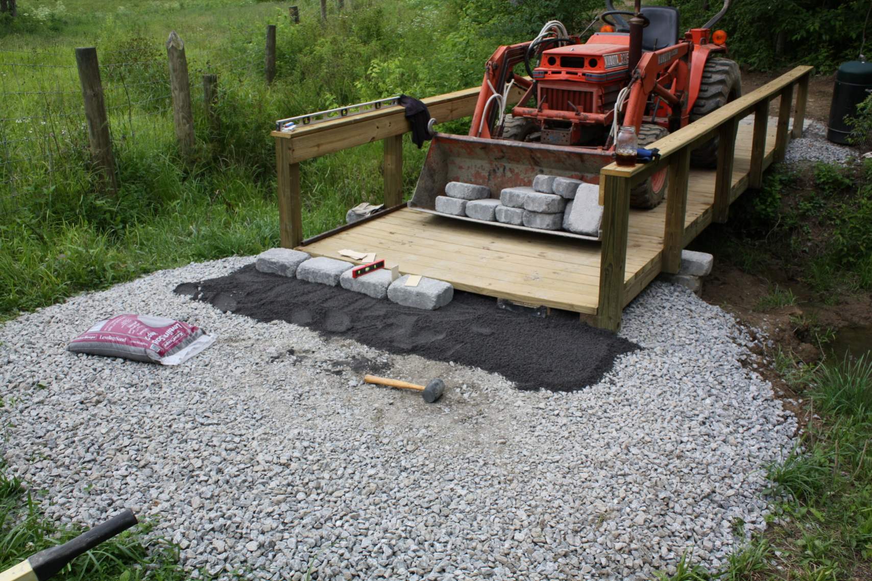

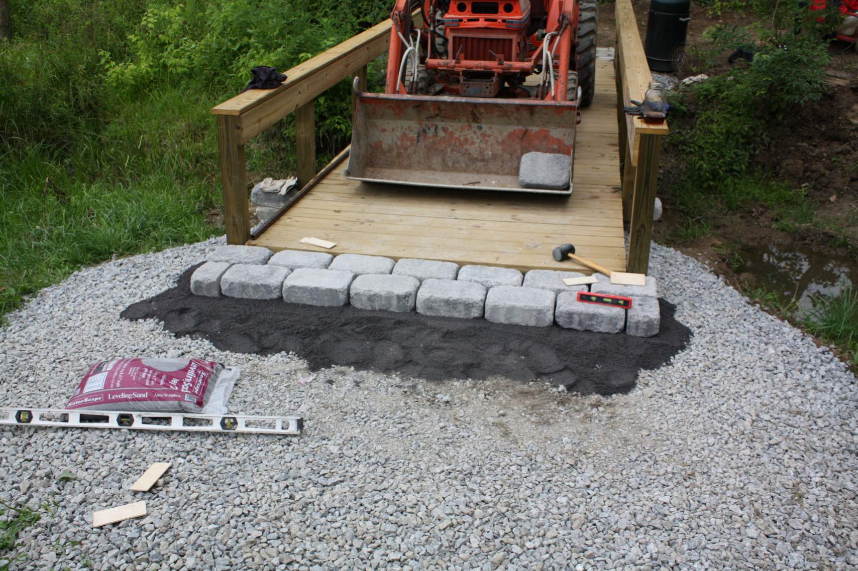

Starting the first row, and it's looking like rain. This is the first time i've laid pavers, and it seems to me the hardest part is getting the ground compacted and level, it's fairly easy after this. I just used 1/8" plywood spacers to get my grout lines and keep everything in line.

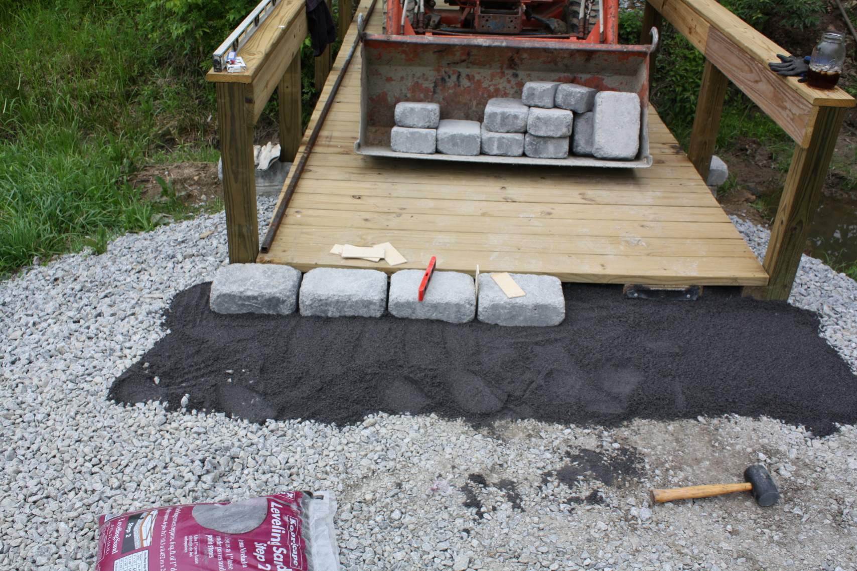

Another pic, dry-laying the 2nd row. It started raining while I was working.
