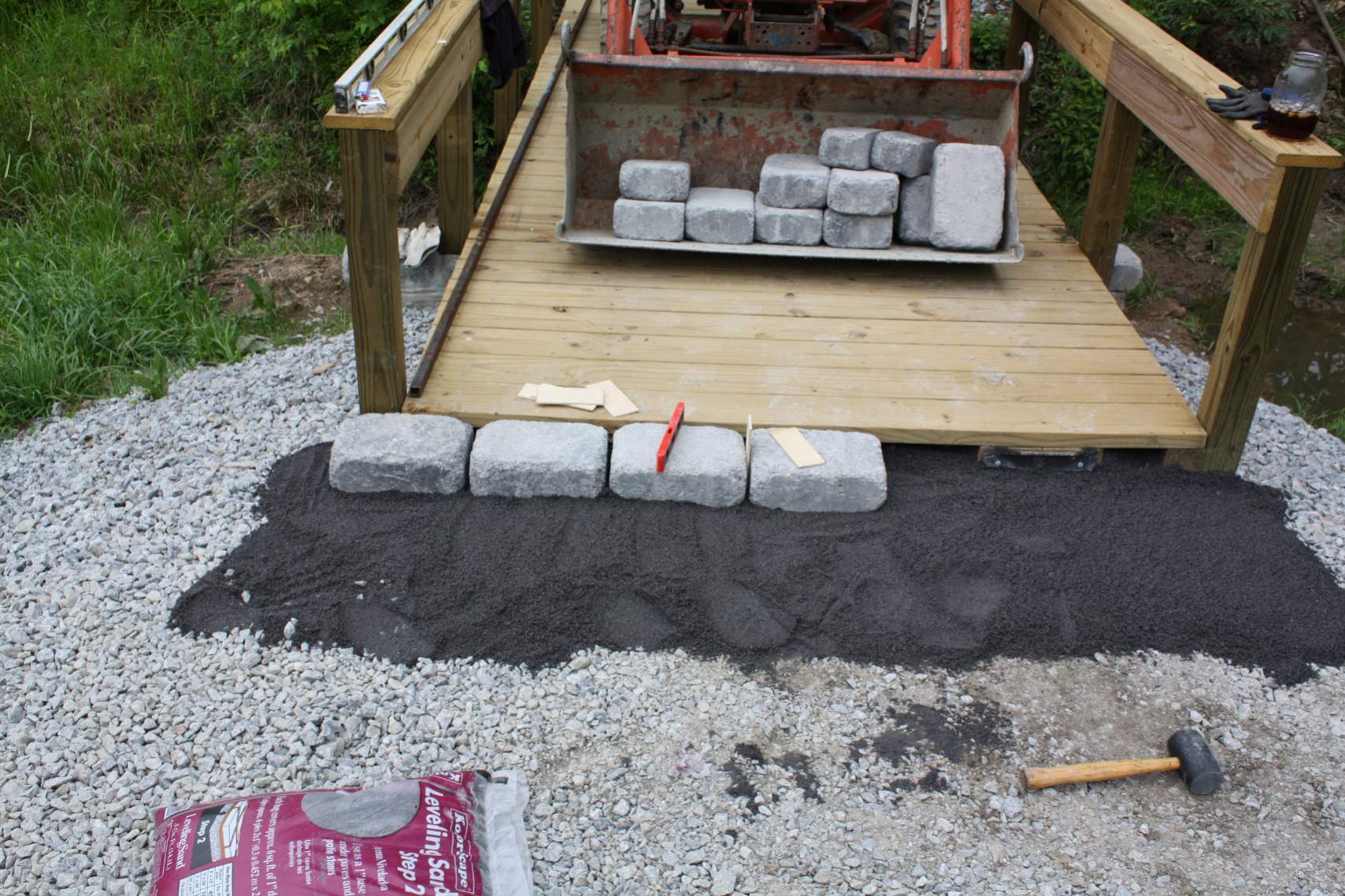

I think transit is way off base.
Does he realize the how much load it would take to break even one 6x6, let alone 4 of them with only 7 feet unsupported?
Now, it could of been stronger if you would've triangulated the middle of the unsupported section back to the base of the vertical posts on either side but it would be totally unnecessary for what you are doing.
Great job! Getting it done and overthinking it and never getting it done are two very different things.

Thanks,,, What blows me away, with a seven foot span max, a train wouldn't break it...think about it..two 6x6's bolted together on both sides of the track...It must be me?

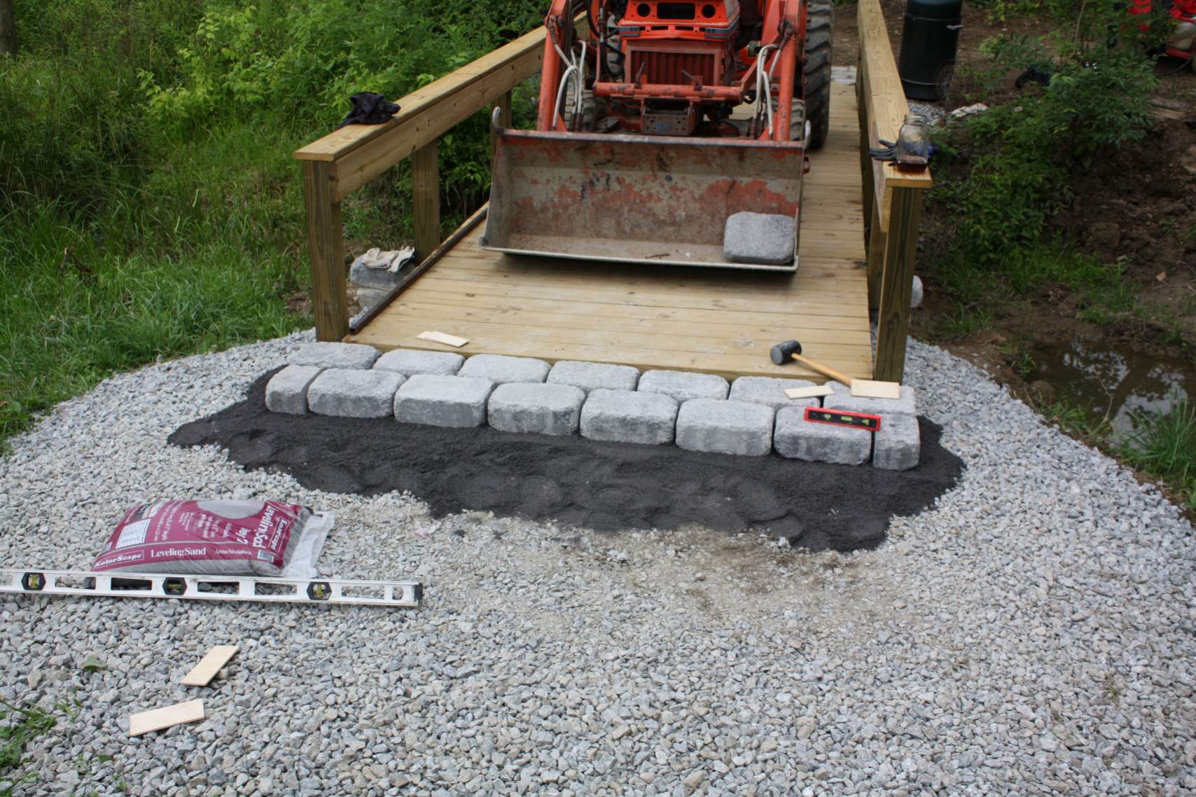

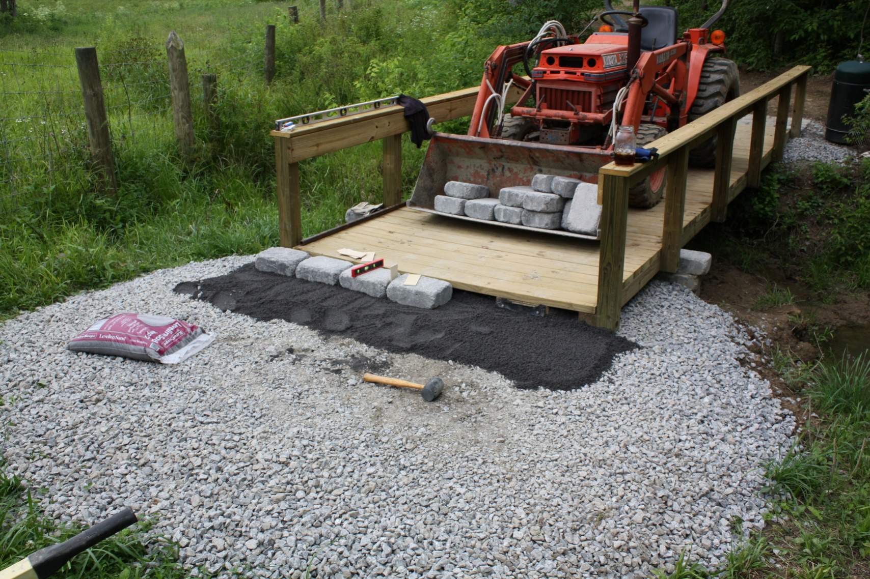

Thanks for the updated pics. Looks great to Me & Plenty strong , But I aint no engineer .
But the again Maybe You could get a job designing & Building bridges for the state of Kansas , because over 300 of the ones That the Engineers Designed & had Built by there specs have been condemned as not safe . :rolleyes:
Looking Forward to You next project . :D Bob

I can by no means guarantee these calculations especially since i can not access my books at this time so I am using some values for modulus etc off of the web and using a spreadsheet set up for a specific situation. I would be much more comfortable using the tables and equations i always use. Having said that, I came up with the following:
2000 lb point load in the middle of a span of a Southern Yellow Pine 6x6 (used 5.25" x 5.25"):
span (ft) deflection (in)
5' 0.14"
6' 0.25"
7' 0.4"
8' 0.6"
No safety factors etc.for being wet wood, etc.
Realize a tractor bouncing up and down from a backhoe on the back etc can significantly increase the amount of instantaneous force on a member.
Multiple members increases the safety especially if the decking is strong enough to help distribute the load to multiple members.
Ken

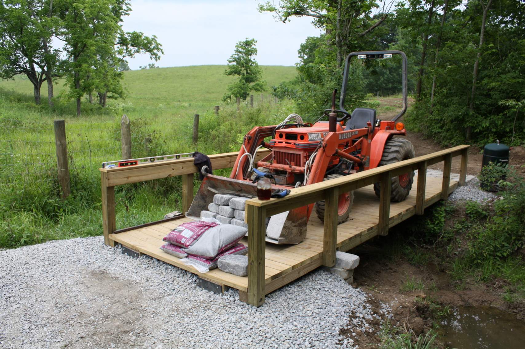

I think the bridge looks great!
I'd cross it on a tractor withouit giving it a second thought... It seems overbuilt enough to be more than just safe..but, I'm no civil engineer...
Your dog looks like he trusts your handiwork without question.. LOL
Enjoy it, it turned out great!

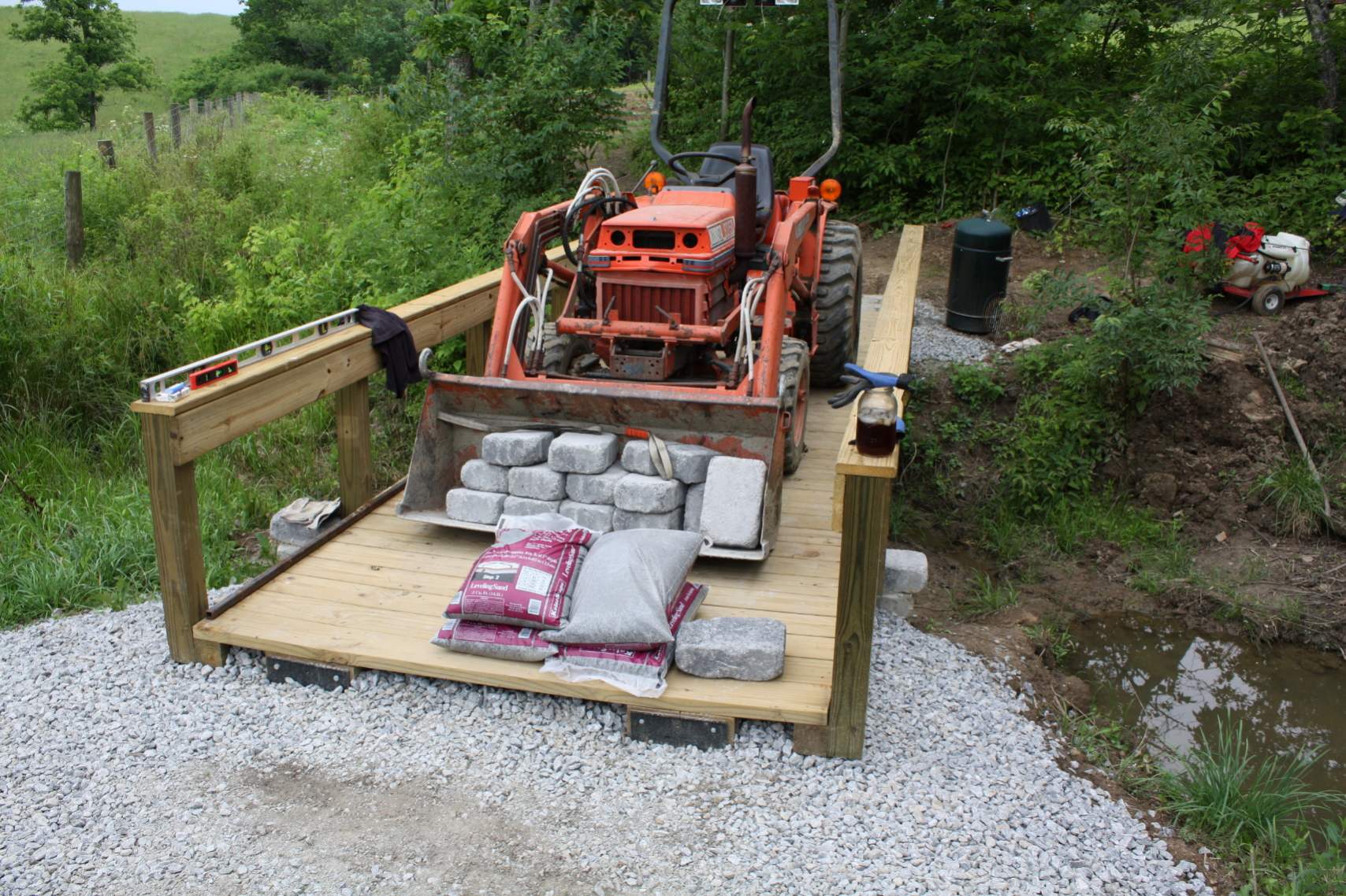

I've looked at your pictures read the entire thread (I think) and I have a few comments.
1. Outstanding job! (in my unqualified opinion). I would be quite proud of that accomplishment.
2. I'm not saying or acknowledging that it is overbuilt, I wouldn't know if it was, but if it is, there is good reason to overbuild when you are trying to overcome elemants such as weather, sunlight, time, wood rot, high water torrents, and eccsessive use. It's not just the load you have to account for.
3. Where did you find the black angle brackets you have shown in the first set of pics.
4. Did you produce any sketches or drawings to aid in construction or facilitate material procurement?

Thanks, I am proud of it, and i'm starting on the new one tomorrow. I made the brackets out of 1/4" angle and it also has brackets on the bottom of the 6x6's to tie them together (they are 1/2" steel) but I don't think you can see them. I did draw it out, mostly in my head, and I did write down all the materials and ideas when I was in the planning stage (i didn't just wake-up one day and say "time to build a bridge"), thats not to say I didn't embellish a little as I progressed. I have been planning both bridges (to some degree) for two years. I'm hoping the 2nd bridge will look stronger and cut the mustard with everyone on TBN.
