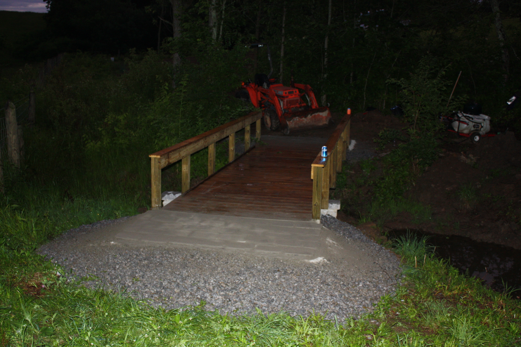

I would like to say: I don't think i'm putting anyone in danger, including myself. The only person's that will ever cross the bridge won't be on anything that will put them in danger (weight wise), except me. It will mostly be walked accrossed. I don't ,(and wouldn't) build bridges for anyone but myself. I would like to thank everyone for their comments, replys, and ideas... That being said...let's move.. ..accross.
/ Building a bridge #82
Buggyman,

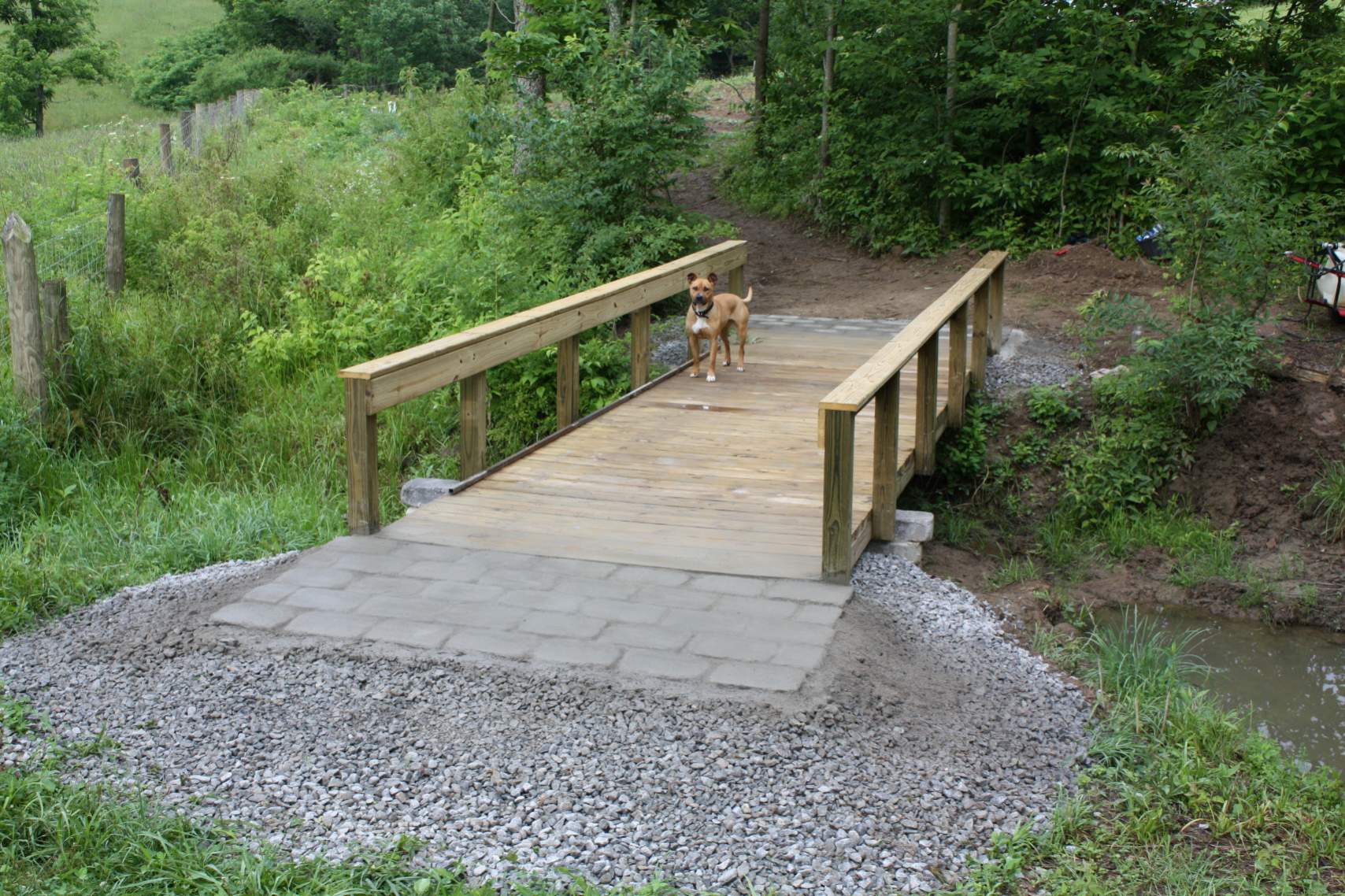

I must add to the concern about your bridge! Four 6x6s SEEM like they'd be more than enough, but who knows?? And what about those trees near your bridge?? You've obviously given no thought about what would happen if one of THOSE fell on you while crossing the bridge. And fault lines. Did you check for fault lines? Your bridge may be unstable during earthquakes.
In all seriousness, I'd say this is more than sufficient (though I am certainly no structural engineer). If you can apply "Kentucky windage" to bridge construction, I'd say you did a fine job of it. From my limited understanding, MANY factors go into wooden construction of any kind, like the type and grade of the wood. Wood is also rated as to each type's elasticity (how much it will bend before breaking, I think). The duration of the loading is taken into the equation too...its not like a house that is supporting a load all day, every day. Then there are things like compression perpendicular to grain design value. Don't even ask me what that means. People much smarter than Yours Truly figure out that stuff.
I think the well-meaning concern others have for you here is good-natured, but I, personally, would have no fears crossing that bridge with your tractor. (You did check for fault lines, right?) ;)

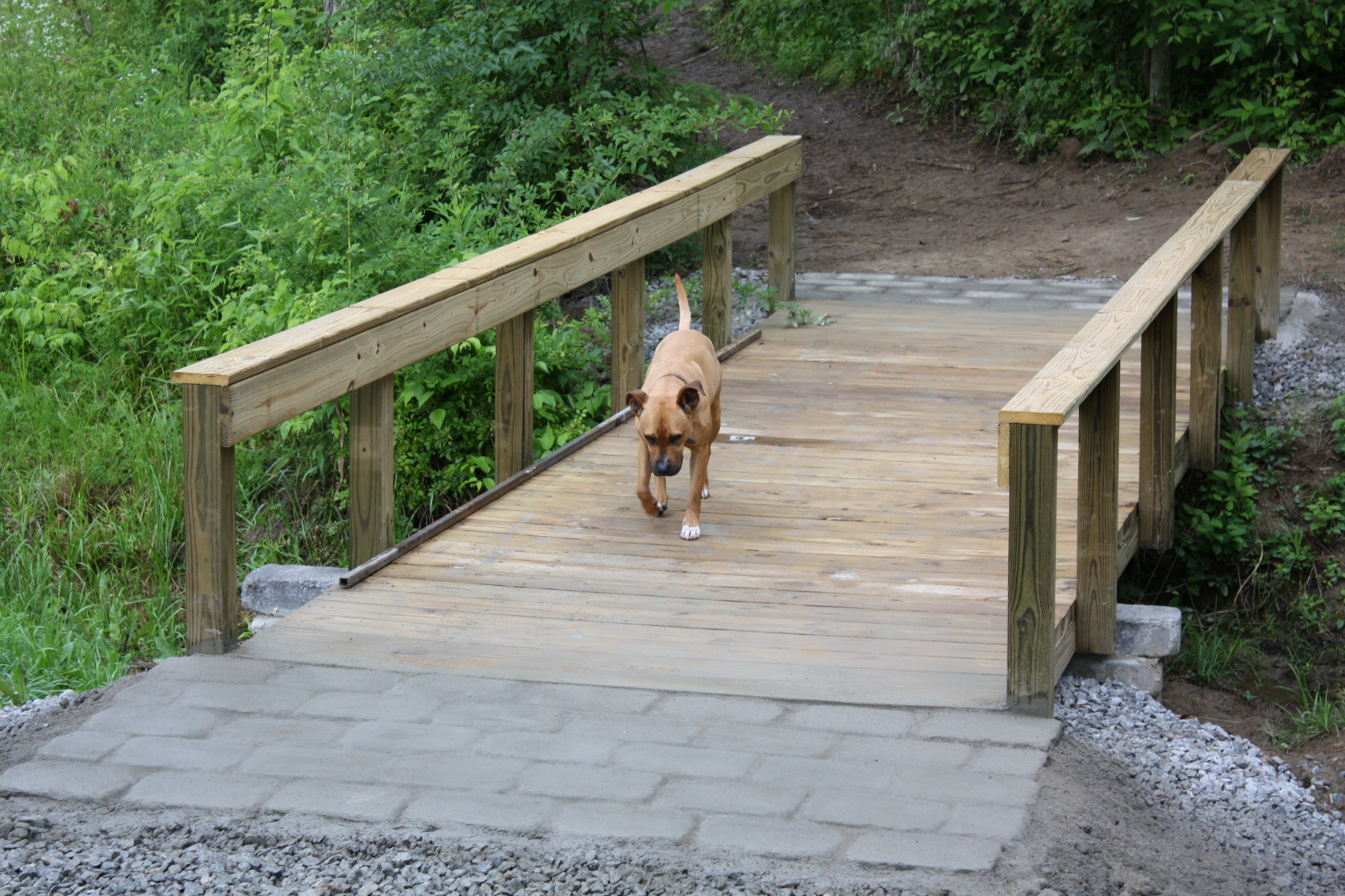

While I am not a structural engineer (and don't even play one on TV;)), I did download the WWPA Beam/Joist Analysis and Design add in for MS Excel from the WWPA web site (I believe you have to register to get access, but it was free). I used this to check the work of the structural engineer I hired to sign off on the design of my house to make sure he wasn't over engineering it too much.
Assuming that the long span is 7.5 feet, and using a Hem-Fir 6x12 flat (about the same as two 6x6 spiked together), incised for PT and >19% moisture content. It can handle a point load of 1000lb in the center. The total deflection is low at L/613 or 0.15 in. However the bending moment is very high at 89% of the allowable. Now there should be a fair amount of safety factor built in to the calculations so it is probably fine, but I would not say that it is way overbuilt. If you had put the 6x6s on top of each other and laminated them or used a 6x12, the bending moment would have been about half as much and this would be great. But, then I would start to worry about the decking痴 ability to transmit the load to the beam. Since the beam would only be 6 wide it would need to be on the center of the wheels, which would probably be a little bit of a challenge to get correct.
If the wood is actually SPF (South) then the load just exceeds the design values for bending moment.
Having said all that, the bridge does look very sturdy and you have driven your tractor over it. Since your tractor probably isn't going to weigh enough to put 1000lbs on a single wheel, you are probably okay. Pay attention to the noises the wood makes and inspect the beams for cracks regularly.

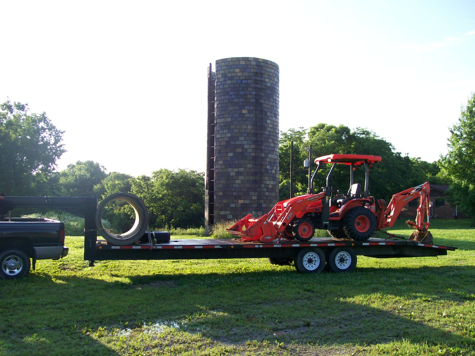

I really enjoy reading and seeing what people build but I am always leary of putting what I have done on here as some just like tell everyone that there is a flaw or something that could have be done better. I know I am not perfect but this bridge looks better and more thought out than 90% of the poster could have ever done. GREAT JOB and let see the photo's of the second one.
FYI my idea of a homeade bridge is the biggest piece of pipe I move covered in dirt.

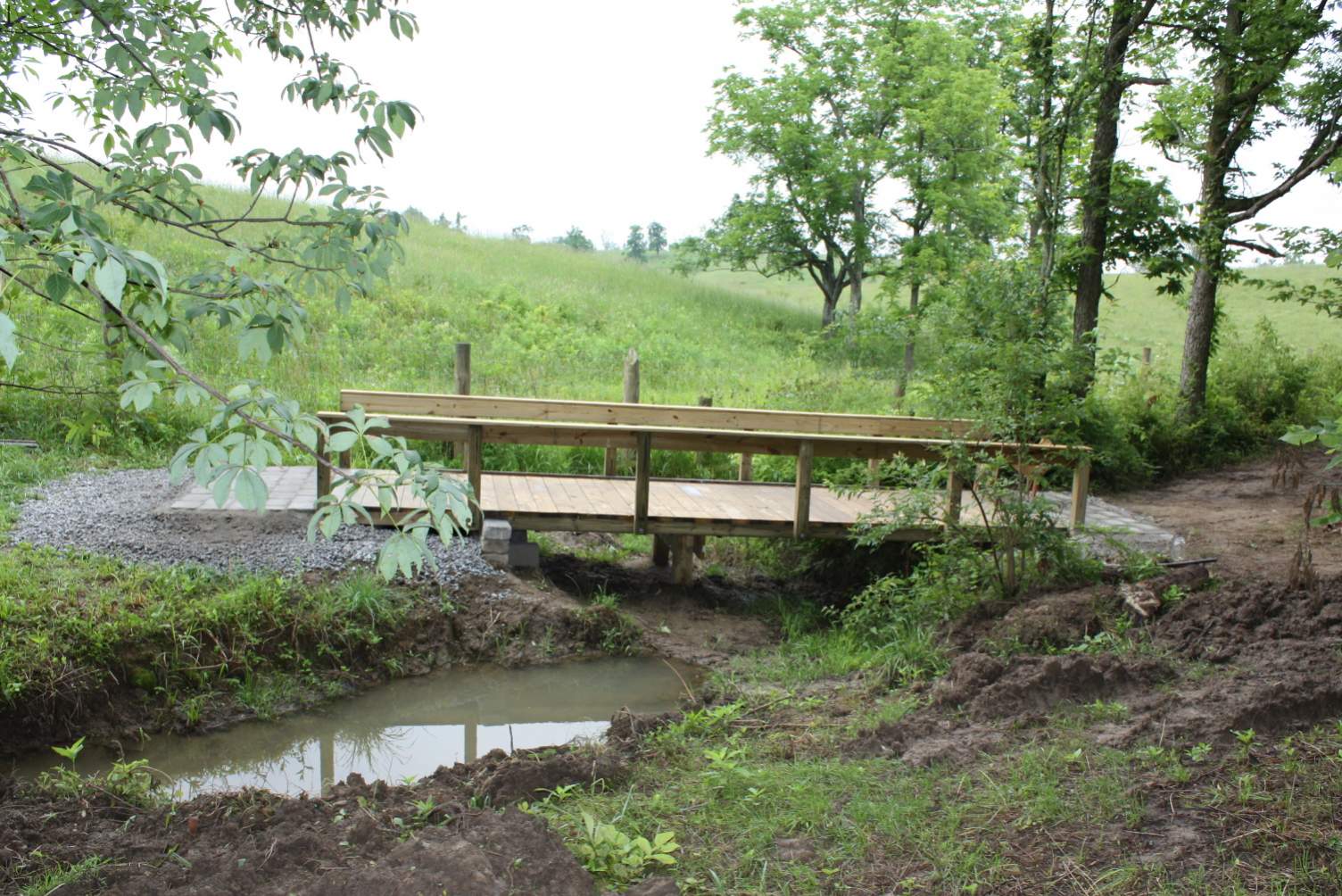

Nice looking bridge. I think it is strong as it sits today. My concern is as it starts to weather and the hardware rusts. Everyone seems focused on the 6x6 beams or joists. I'd be concerned with how most of the bridge weight is supported by the 2 cross beams made of 2x6 or 2x8. 4 bolts hold all the weight on that double span. When the bolts rust out, and they will in half the time with our new treated lumber, they could shear with no warning. Those cross beam pieces should be notched into the upright posts to hold the weight rather than all of it on the bolts. You could add a set of vertical 2' long 2x6 cleats under the cross beams to support them. That would be a quick and cheap way to add some strength to it for years to come.
But like I said, it's a nice looking bridge. I wish I had one.
