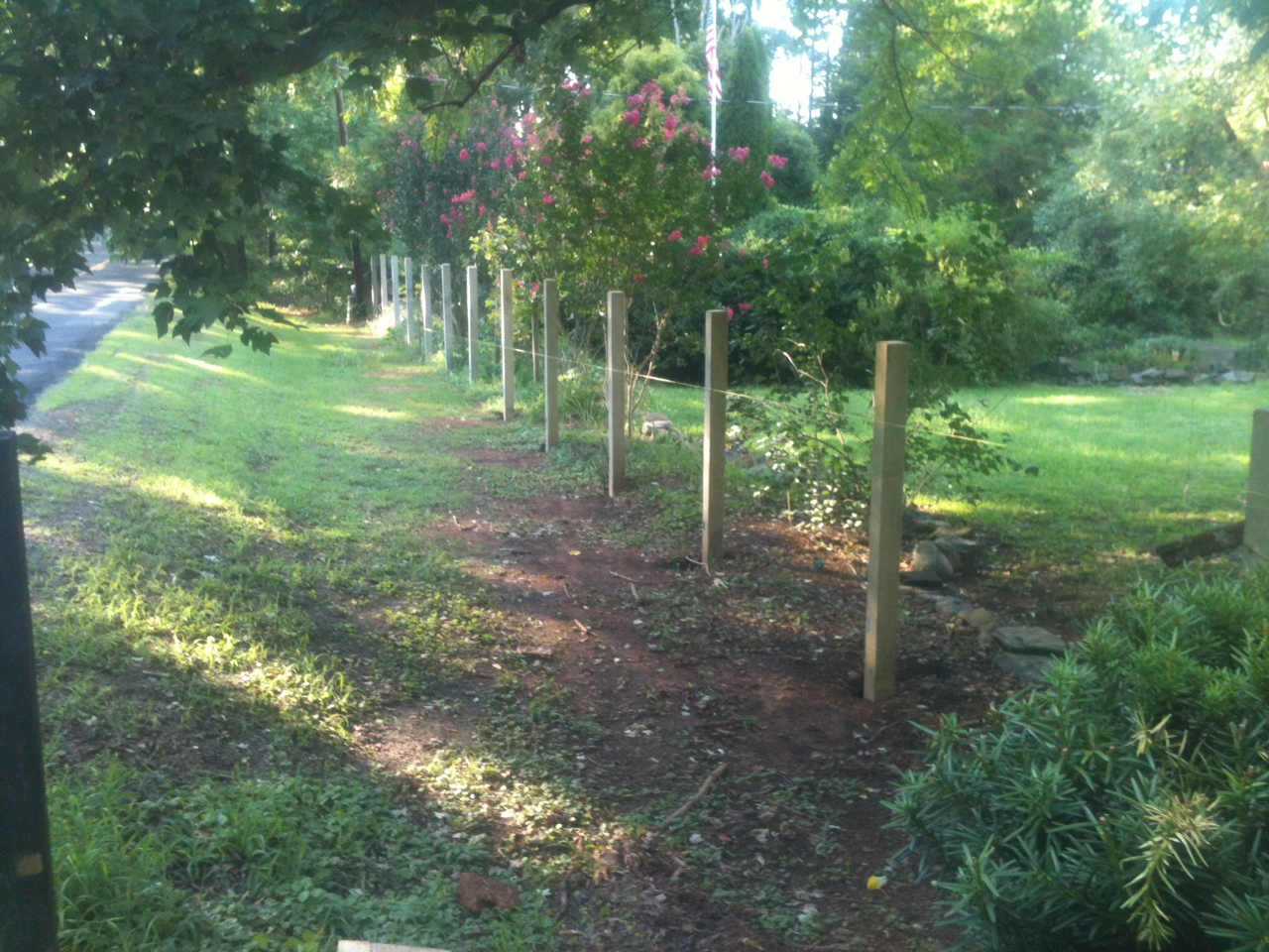

Total will be 15 sections like this one, concrete posts with 12" cast wall between them. The wall will be crowned with pavers and pine boards - pickets or privacy - will be screwed to 2x4 cross beams to complete the fence. The distance between posts is 98", posts are 8', above ground section of the post is 5'8". As long as the fence is under 6', no permit is needed. I found those posts at local concrete mixing plant on clearance for $10 a piece.
I have some vision of the result, making decisions on the go - ok selling my ideas to my wife to be precise :D
The old fence was really old and really pathetic, will try to find a picture.

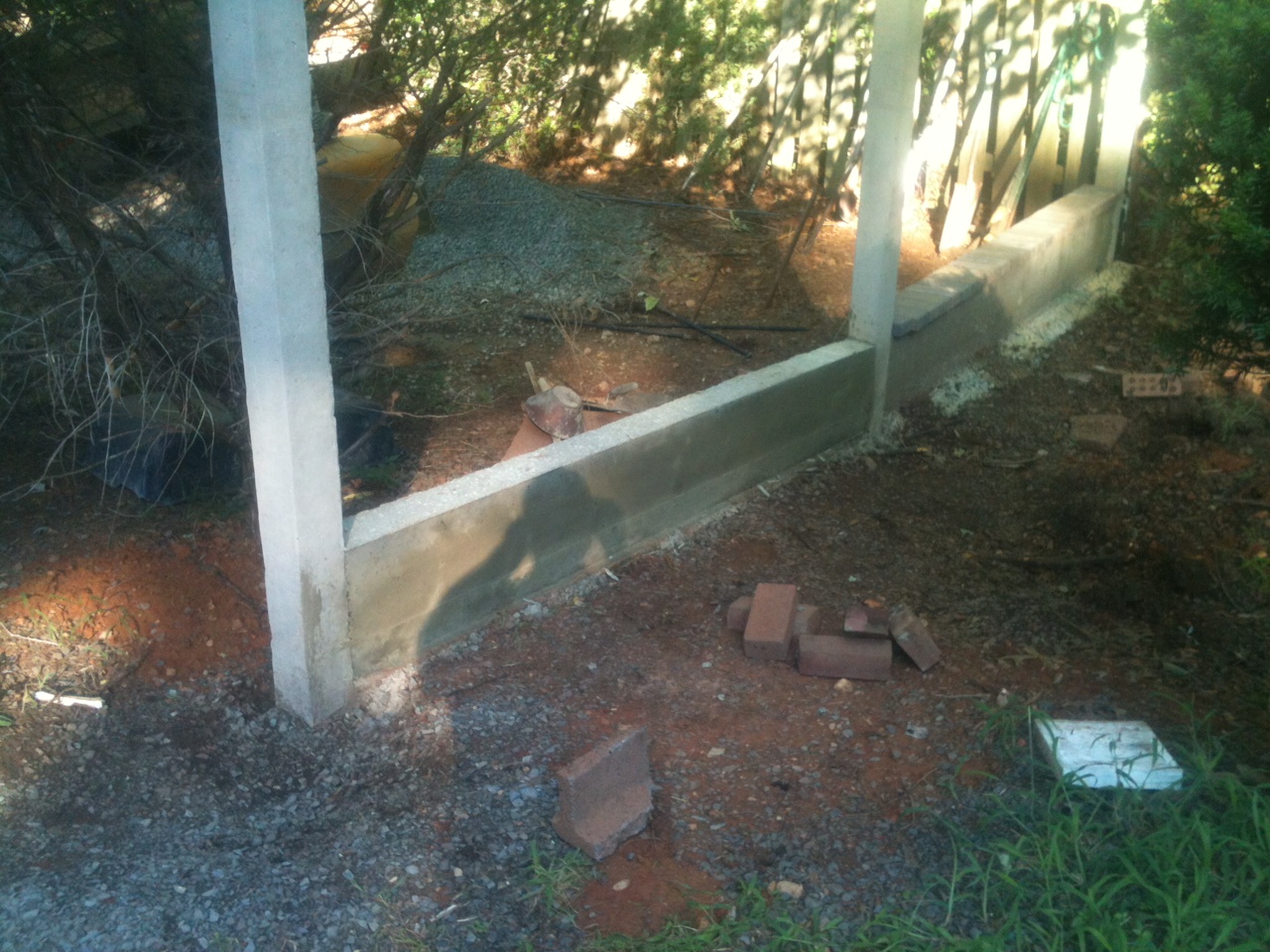

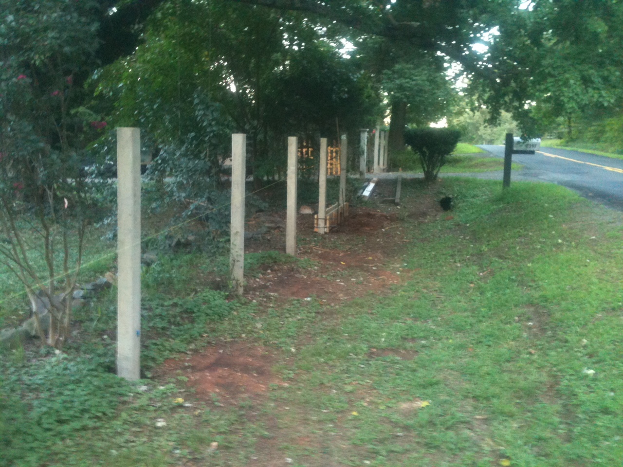

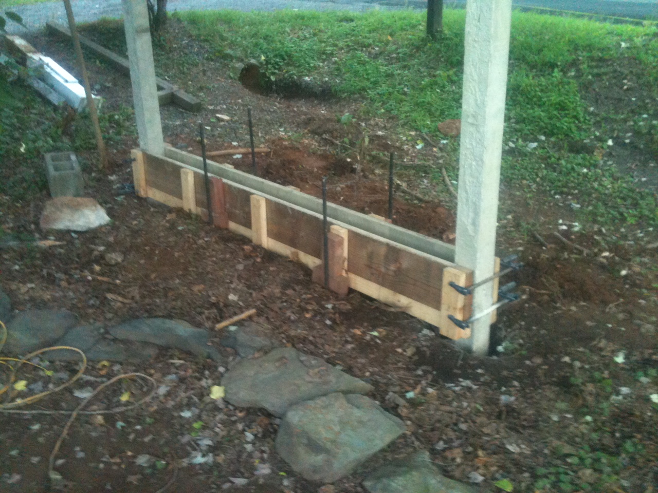

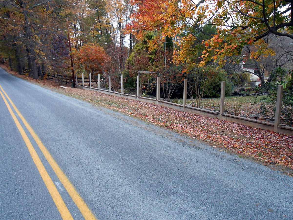

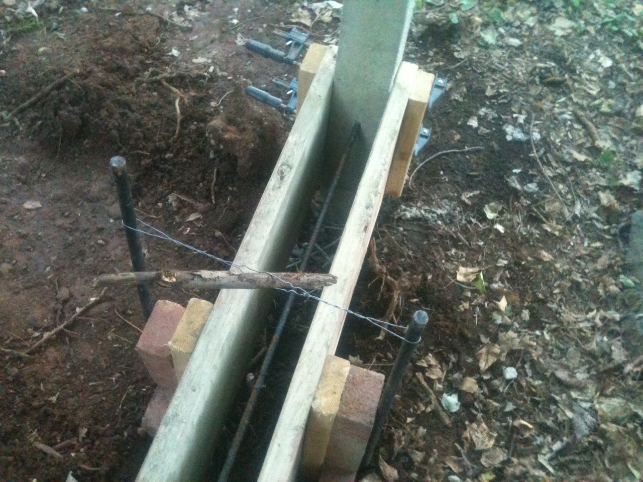

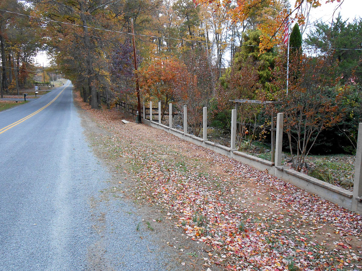

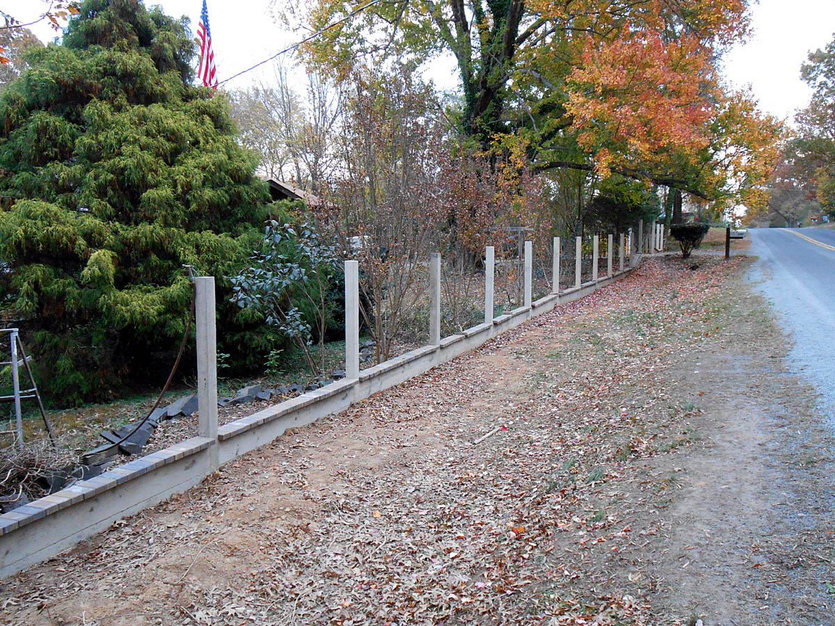

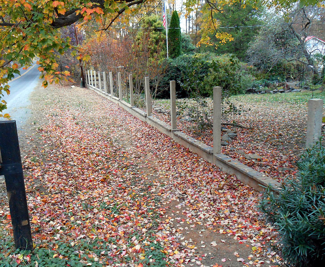

More pictures:

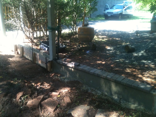

Done with walls, except for the gate.
I used carryall on my tractor to move the mixer and all material down the ditch for every section I poured.
Holland pavers will be used to crown those knee walls. I will need to cut some and still not sure if I should use outdoor glue to secure them or just cement them in place. What do you think?
/ Building a fence #19
I think glue will get expensive and probably not last. If it was mine, I would use grey thinset mortar from the tile section of your hardware store.
