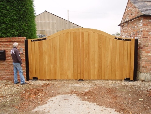

That was my thinking, but I would prefer blocking the view from the road down our driveway. It is too open and the traffic is getting heavier year after year. Maybe something like this, little shorter. o.jpeg
Guy who builds gates for living over in the old country told me to use one more horizontal steel tubing across instead of diagonal brace, it looks better and its almost as sturdy as diagonal one.

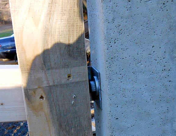

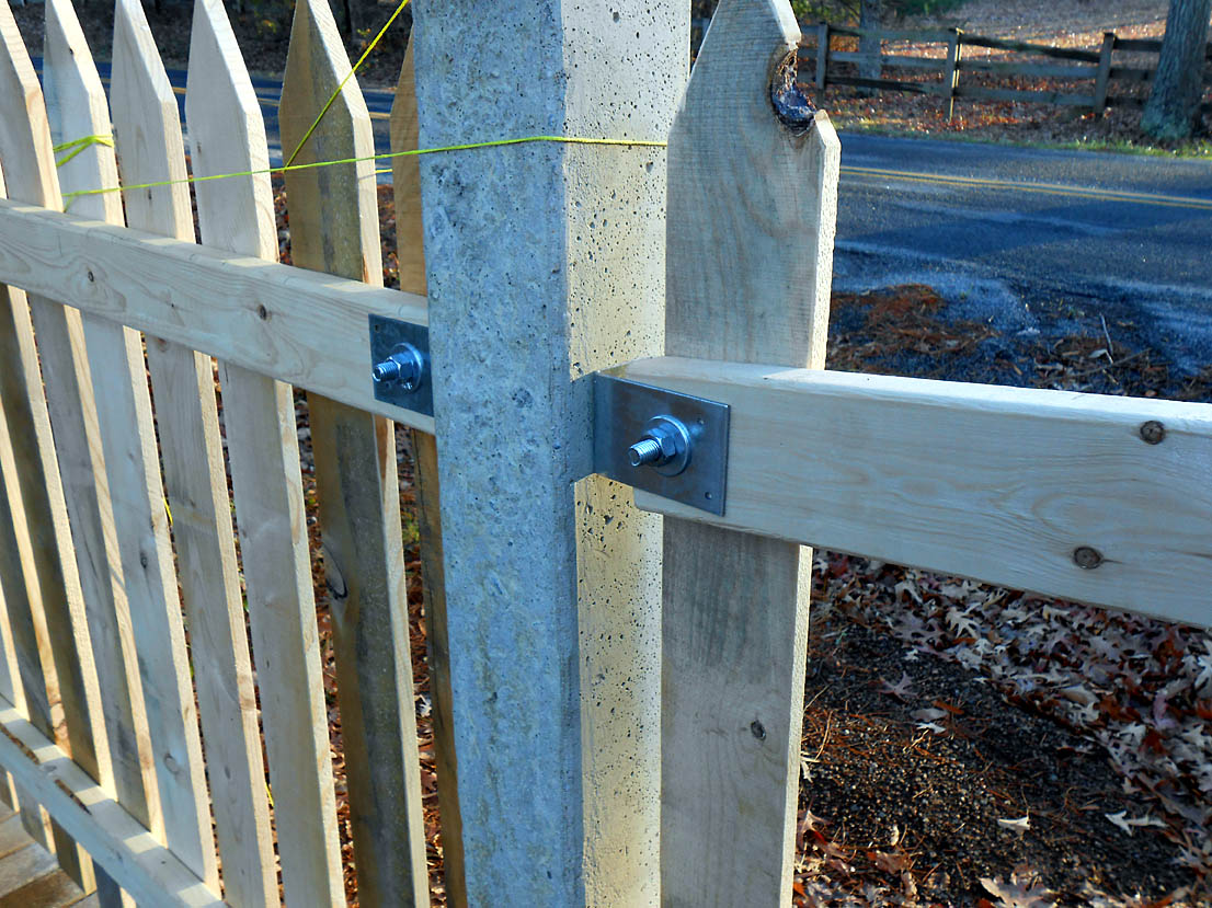

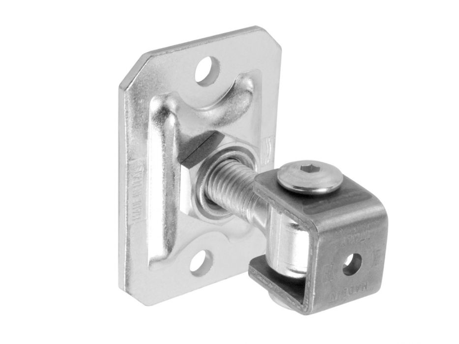

Ever seen a hinge like this?
/ Building a fence #44
That idea of hinge is really nice in that you can adjust the top and bottom in and out thus moving the opposite end of the gate up and down. Makes lining up two gate half’s or the latch much easier. Also allows adjusting of gate when time or settling or other things cause it to sag. A bit of water resistant grease on the threads is a great idea to help insure ability for adjustment later after rain and snow.
Hard to tell for sure on your picture bu the hinge type with TWO nuts allows adjustment with. Out taking the gate apart.

#46
Thanks.
I may built hinges myself, I have what it takes. I tend to overbuild stuff, commercially available parts are often too flimsy for my liking

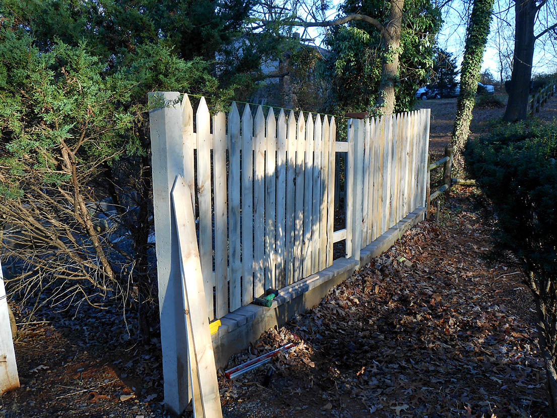

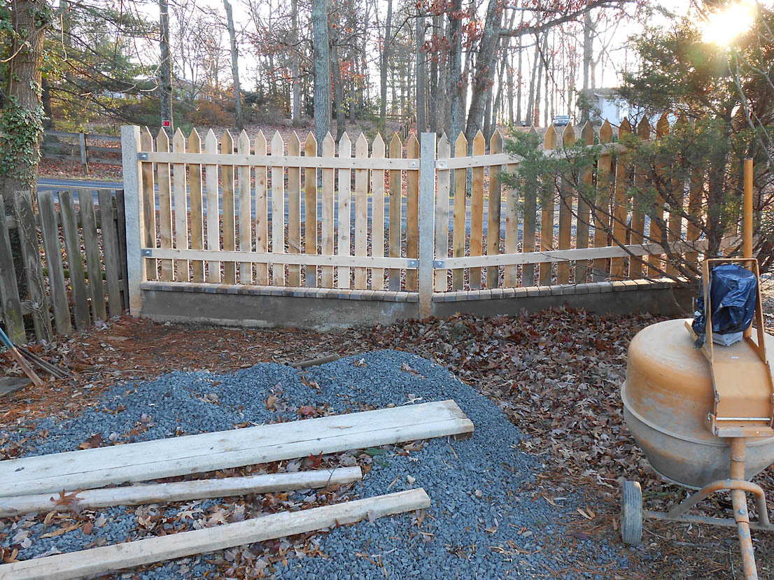

It finally stopped freezing, I continued with the stucco and finished first layer on both gate posts.

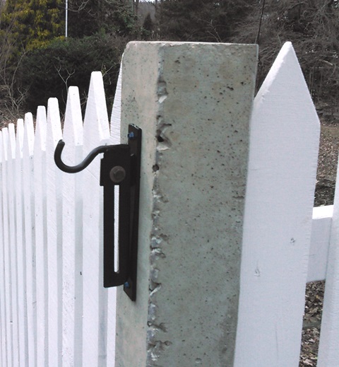

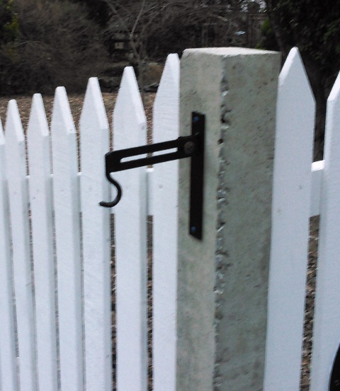

Before Christmas I made hangers for decoration - to please the little woman. The hanger can be used for wreaths:
or flower baskets:
/ Building a fence
#54
Really clever hanger...I like that idea a lot.
Thank you. We had brackets on the old fence and I knocked them off quite often when cutting grass, thats why I figured these folding hangers.

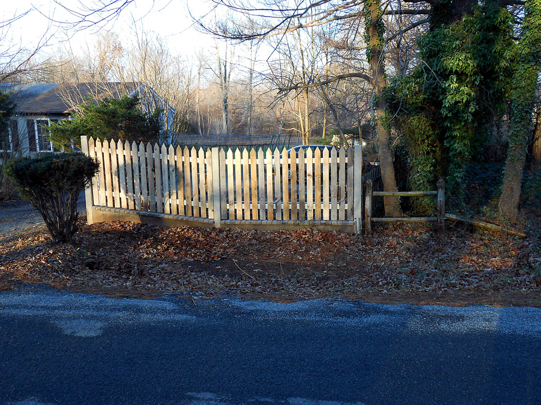

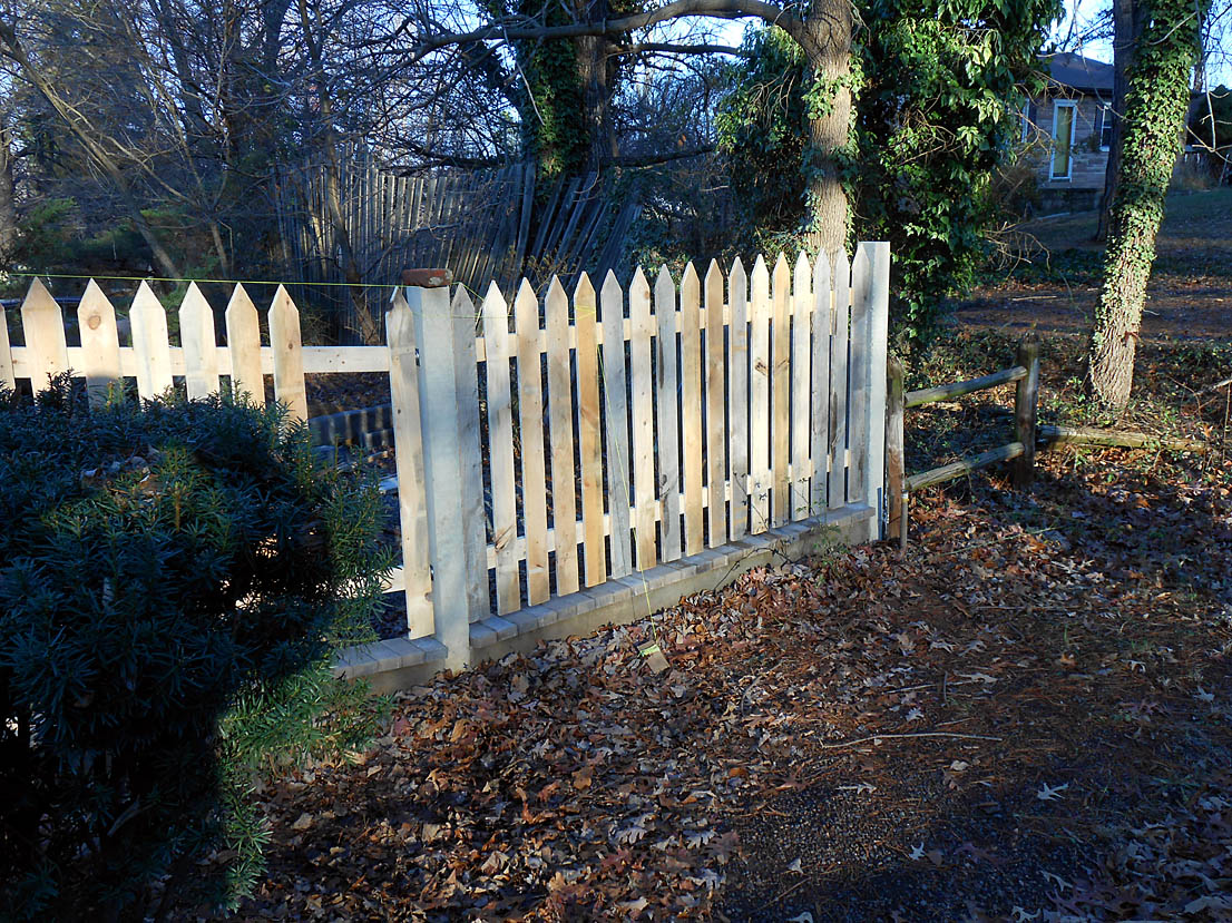

Finally finished the small gate.
Of course, now it needs a hook to hang a Christmas wreath on. The wife is never happy unless there is decoration involved. :)
/ Building a fence
#59
Thank you gents, :)
I used white oak that we cut down with my son and milled myself. Boards are shiplaped and the top arch is half of an oval.
