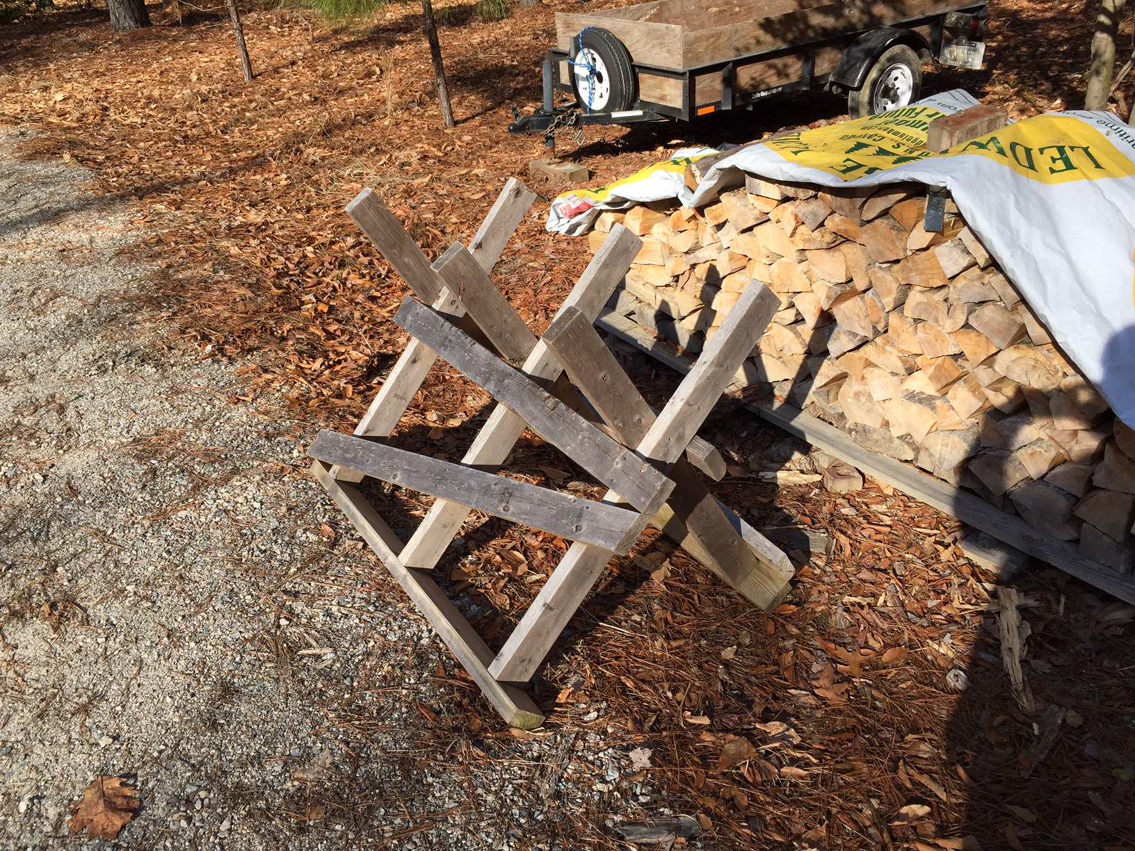

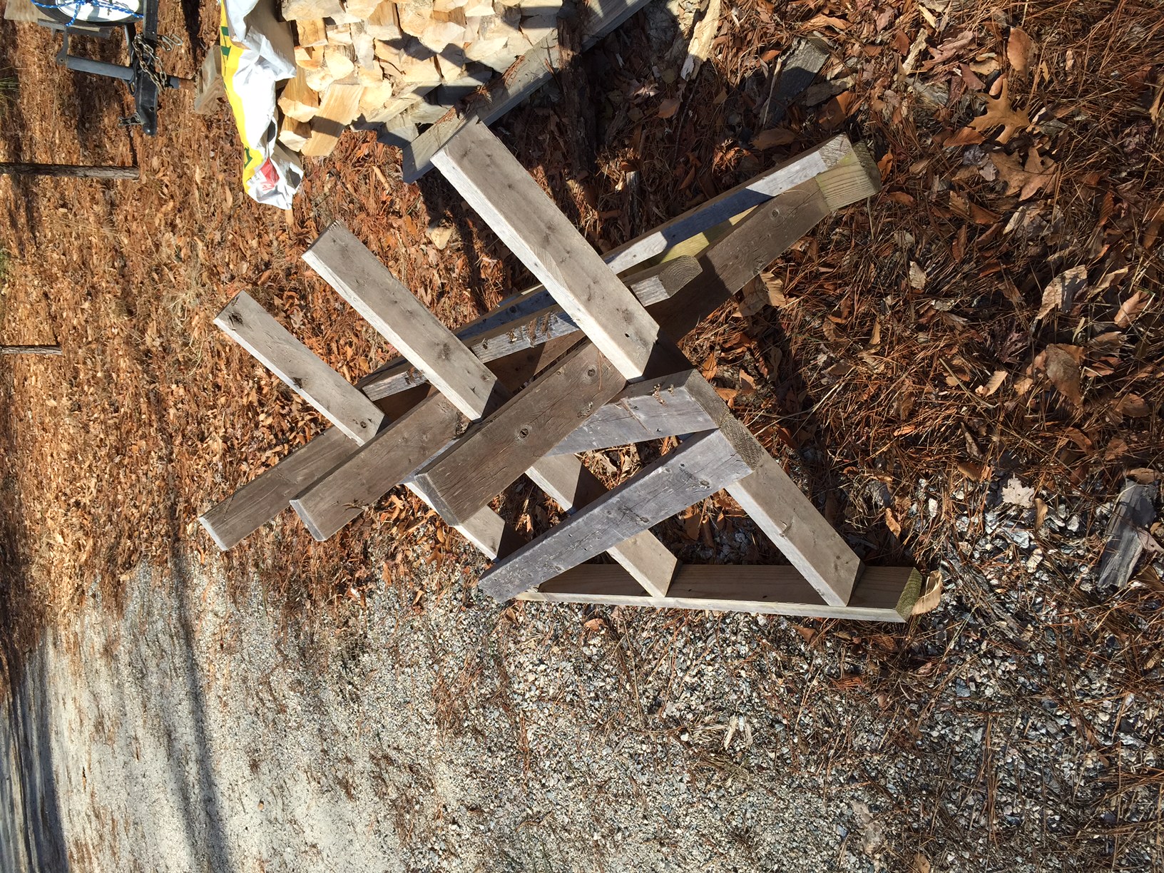

Don't know why the forum messed up my photos earlier, but here they are again. Could not be a simpler thing to nail together from scrap lumber, and very beefy.

S219, that should work for me, about how wide is it?
Mine is about 4' wide, but mainly because I was using up scrap 8 footers of lumber and being cheap. It will hold a 7-8' log OK if balanced right, but you might want to go wider if you cut a lot of long logs and depending on your workflow. At the time, I had a B2920 and cut many of my logs at 4' so they'd fit in the front bucket. I'd skid a bigger 8-12' log behind the tractor and put 2-3 smaller 4' logs in the bucket on every trip out of the woods. At the end of my clearing work, I had a pile of about 50 4' sections and 15-20 8-12' sections. The 4' sawbuck made sense for that.
The only issue I remember is that sometimes it's hard to squeeze in between the uprights to make a cut if I have a short bar on my big saw. So think about access and spacing of the uprights.
Might almost make sense to only have tall uprights on the ends and provide shorter uprights in the middle, or some other means to cradle the cut rounds so they don't fall off the middle sections.

I think I'd add some ties at the bottom of that to keep it from trying to spread when you put heavy logs in it.
/ Building a "Log Horse?" #34
Could, but the horizontals near the hinge line do that surprisingly well on mine. With one on each side, it doesn't budge, and I just have a few nail gun nails holding mine together. I guess a side benefit to this design is that if you bolt through the hinge line, it can fold up if needed.
