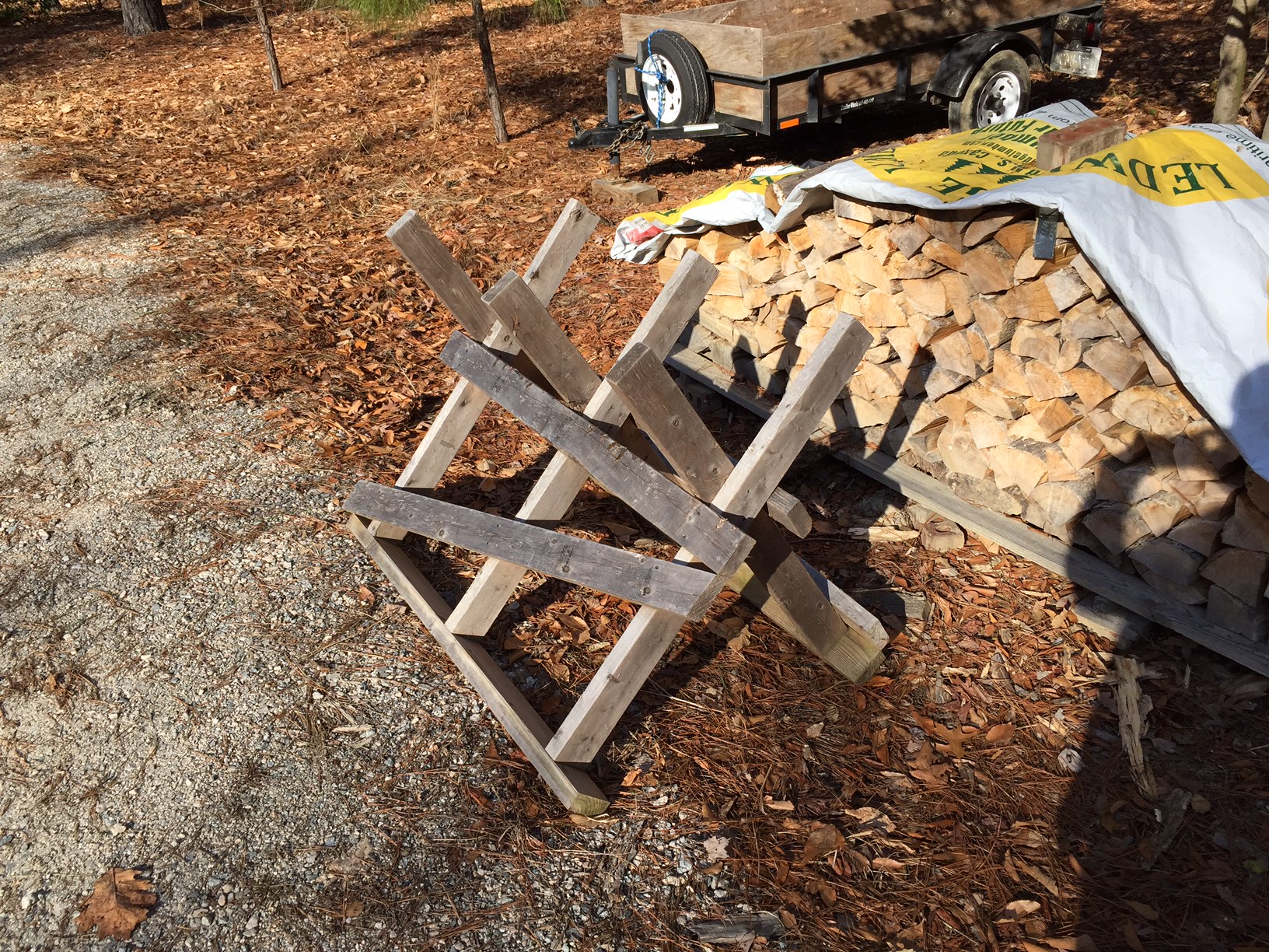

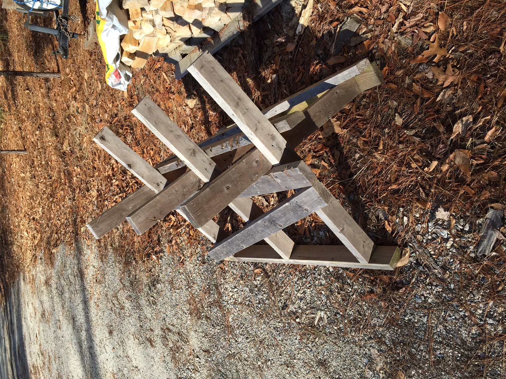

   / Building a "Log Horse?" #25
Don't know why the forum messed up my photos earlier, but here they are again. Could not be a simpler thing to nail together from scrap lumber, and very beefy.

S219, that should work for me, about how wide is it?
