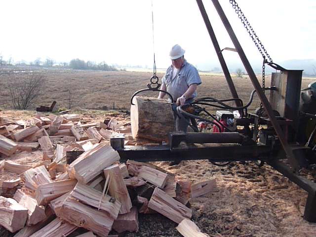

Also, I'd like to suggest looking at making a boom lift rather than a log lift on the side of the splitter. I run mine with a 3000# winch and we are able to pick rounds up from any position around the splitter. Whereas if you have a log lift off to the side you are restricting yourself to working off one side of the splitter, plus you still have to roll or carry the rounds to the log lift. Plus you will be adding a lot more weight hanging off the back of the splitter.
Here are a couple of pictures of my boom lift in action.

I am all for the boom lift also. I built mine with a T knife. It doesn't split the block intwo. It just takes firewood size off the bottom of the block as you work it down. the main block stays complete. Just take a couple of pushes off the bottom, rotate with the tongs and finish it off. Having the hyd or elec winch sure saves on the back and like said above, you are able to grab from either side. My unit is likely overkill for most. I built it over 25yrs ago using the pto. Have since changed it to be self contained. faster and easier on the tractor.

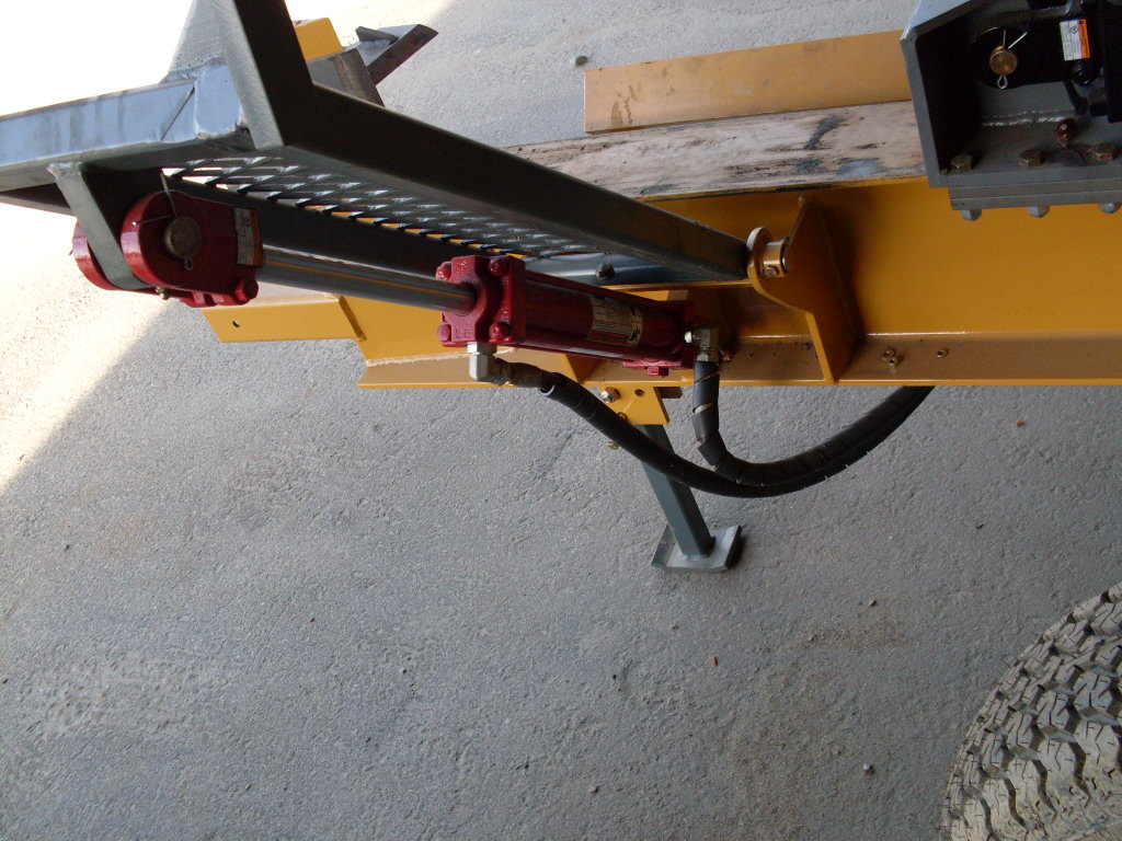

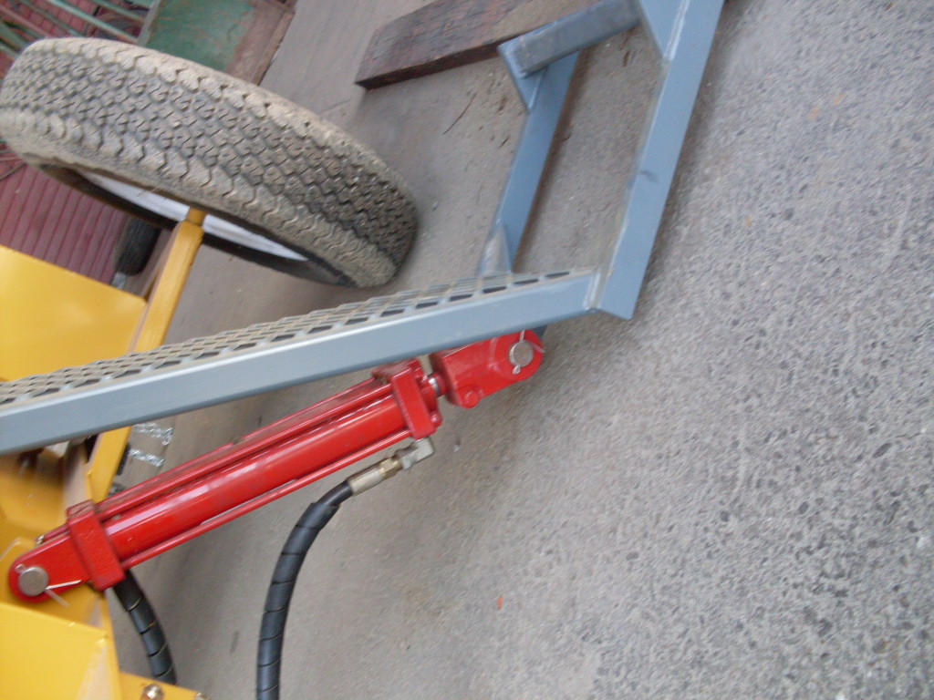

Here is the latest progress. Log lift is completed, 4-way is completed, running the plumbing currently.
THe wedge should be on the beam on a horizontal model if you want the wood to move past the splitter and onto a feed table, tray, or into a tractor bucket.
I do not have plans, sorry.
The 4-way is working fine, tested on on air pressure, waiting for the final hydraulic fittings.
Splitter with Log Lift and 4-way

looks like a good light duty splitter , but you will want to brace the lift arm its too light. also your adjustable wedge is still too tight not bad all in all for a first try:thumbsup:
/ Building a Log Splitter from Scratch
#27
The "lift arm" is braced. You didn't kneel down and look underneath? :laughing:
How can you determine strength over the internet? :confused:
What thickness of steel would you think would be strong enough?
/ Building a Log Splitter from Scratch #28
I could be on the moon and see that 1/8 x1x1 box isnt heavy enough , I allways use 1/4 x 1 1/2 x 1/2 for mine but the main strength issue is that your cylinder stroke is too short when you raise the arm the log will be cantilevered over the cylinder end this will cause eventual breakage of the light tube .
