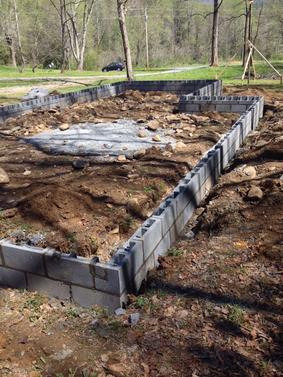

I decided to stick build. Ended up being cheaper for my needs. Considering all of the rock uncovered when digging the footers it was good I chose this route. I would have never been able to dig holes for the posts.

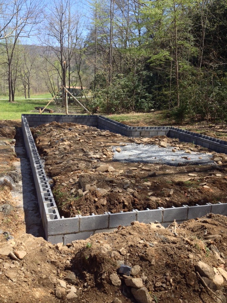

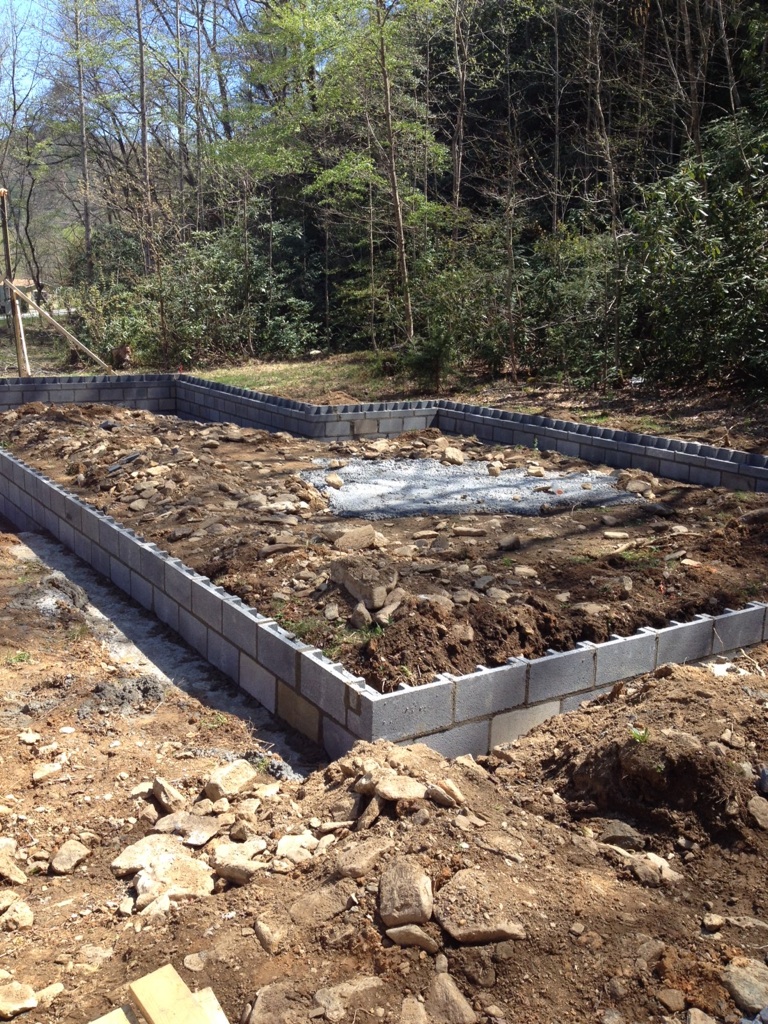

Got the foundation block laid today. Things are coming along. Should pour the slab either Friday or Monday.

Digging that must have just stunk.
   / Building a Pole Barn: Step 1
#75
My builder had originally thought they would knock it out by hand...no kidding. The guy that came and took care of it only charged me $200...I couldn't believe it.

My concrete guy and I have already had the discussion of using rebar in the pour. I told him that's the only way I would do it. We are using a good bit of the excavated dirt to fill the foundation then I am hauling in about 4' of crush and run to finish the fill and compact. We hope to be ready to pour by tuesday of next week.
